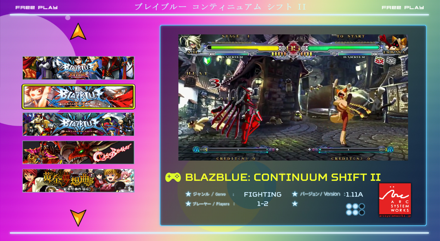

Oh someone creamed themself when they saw how pretty it is ;d dont forget if you have a ps2 keyboard attaced you can edit the settings Coerey didnt put the artwork toggle button in its my default set to 'custom2" in the menu press TAb use the arrow keys go to controls press enter go all the way to the bottem till you see custom 2 hit enter and bind it to one of the unused buttons on your arcade then go back to the menu mode pretty sure he will fix this in later releases pressing this button will let you toggle between video snap and flyer.
Currently their is no animations set during the toggle, because of limitations to how its currently implemented it should however play a "special* toggle sound during artwork swaps

well the good news is layout updates can be drag and dropped and change nothing beside what you see on the screen so any update for the layout that works on pc will also work on a ttx, on a pi if you run it their ect
I have other layouts in the mix i might finish one day that use the same baseartwork ie wheel image flyer snap
Example:: keep in mind rought demo, but the idea is once the GUI is setup you can change it because AM is very flexible Games are based on list and path, and Gui is kinda its own thing. and yes that is a sega all net clone

Neat Couple of things::
If you can use a ps2 keyboard you can change settings
Tab to bring up the menu
You can go to "sound" and turn up the videos and screen saver module
You can also go to "General" Then go to window mode setting and you should be able to set it to "fill" screen that should get it full screen
You can bind a button in "controls" this button is at the bottom called "custom2" To change the video artwork out ON-the fly for Snap shot and title
You can define in "Screen saver" the ammout of time to wait before the screen saver is active
All artwork is made for every game currently as far as i am aware so that's a name issue. You can check that the gamelist name matchs the/nesicaxlive/am/artwork/logos name for SFIV
