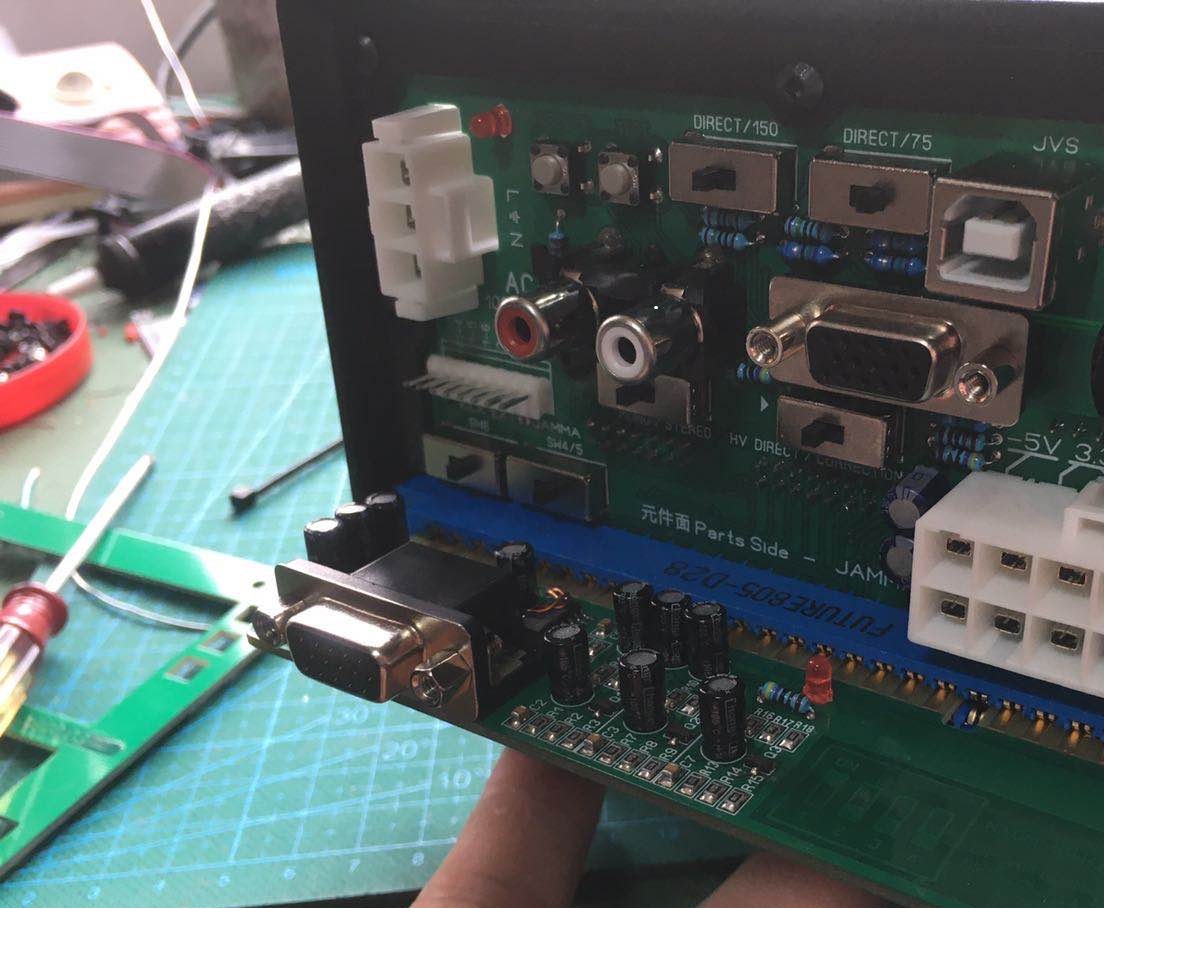

There's a PCB that connects to the jamma looking in port on the back of the cbox , just connect the VGA cable from there to the naomi and you should be able to get RGB off of it

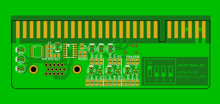

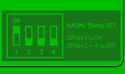

we have this adapter we make, that connects to the jamma on the CBOX then you can pull the 15khz video signal from the JAMMA to your BVM. just like the Capcom I/O does for you.
this is an old way.. actually most people use 31khz lcds for naomi or JVS, but we know issue you are having due to your setup
(VGA to BNC Cable - HD15 VGA to 5 BNC) will not work
NAOMI needs to merge the HV sync signal. Then the RGB signal needs to be amplified by the circuit to correctly realize the 15K-RGB picture
NAOMI’s 15K signal, 15K output from VGA, needs circuit processing to display RGBS normally
give us one week to make a few of them and i will add it to your 2nd package ok?
but this will solve your issue
