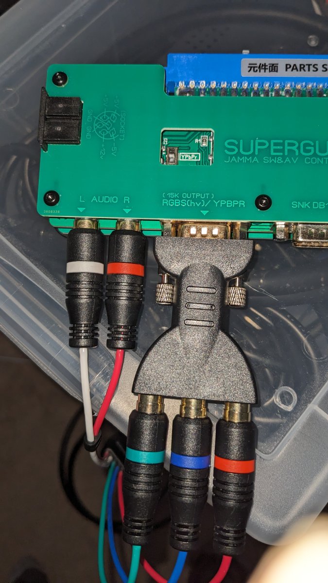

Having some issues with YPbPr output on the supergun mini with some boards I tested.
On a consumer CRT, I get a garbled mess of colours with a rolling screen. You can kinda make out the images of the game. With a RetroTINK 5X, screen turns black and desyncs again to the default blue screen.
RGBS/RGBHV totally works fine with the same boards. I'm using a passive DSUB15 to component adapter with HD Retrovision component cables. Any solutions to this?

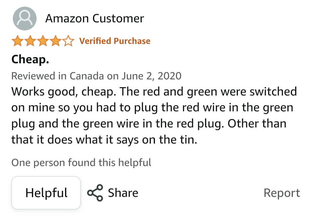

I used an adapter like that and the blue and green were reversed on the adapter. I swapped blue/green and it was fine.
Which boards are you testing?
Edit: sorry, I see the issue is only with some boards. Still interested in which.
@GeorgeSpinner Thank you, I will reverse the connections on the adapter later today.
When I said "some boards", I meant just the ones I have on-hand at the minute.
After reading some reviews of the adapter i bought, I found this. Issue fixed!
Good. It may have been green and red on mine as well, now that I read that review. I'm unsure.
