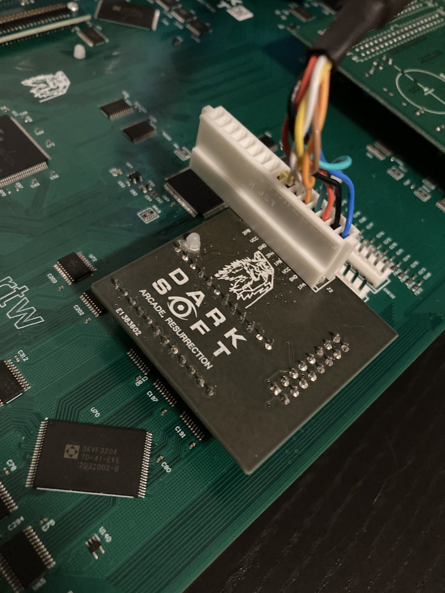

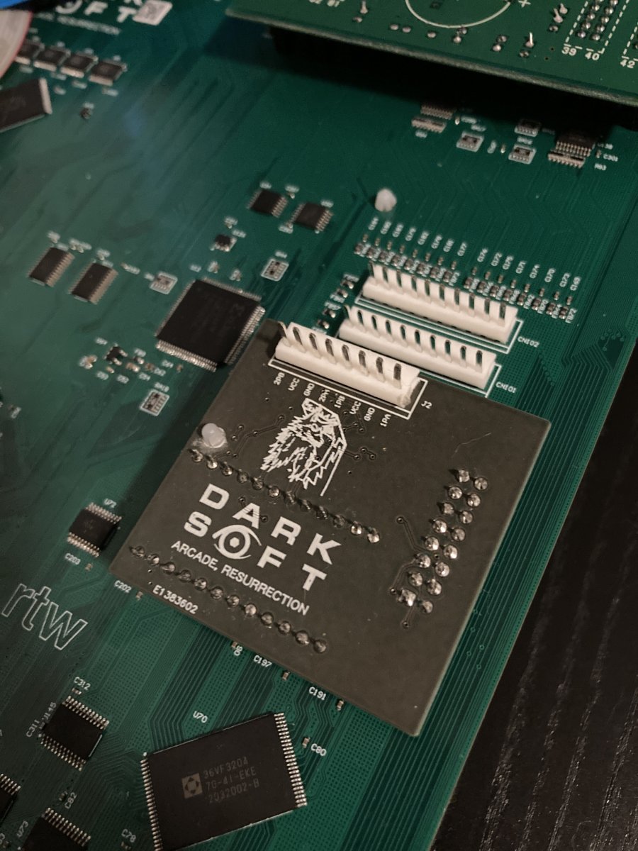

Its the same 16 pin NH type connector like on the original, but only 8 wires are needed on both the original as well as the multi. The 8 pin was used on the multi due to availability. There is just no stock of the 16 pin header and connector right now. The 16pin connector will fit on the 8 pin header on the multi just fine and still work. So there is no need to change it.
Definitely no need. The 2P Axun spinners work with original Forgotten Worlds PCBs and have the same pinout. They’re compatible with the @aje_fr CPS-1 multi as well as the Darksoft one (with add-on PCB).
The Darksoft spinner add-on board has less pins, but on the original connector they are unused/unpopulated, so for space saving reasons this makes sense.
Here’s how it connects to the Darksoft multi:

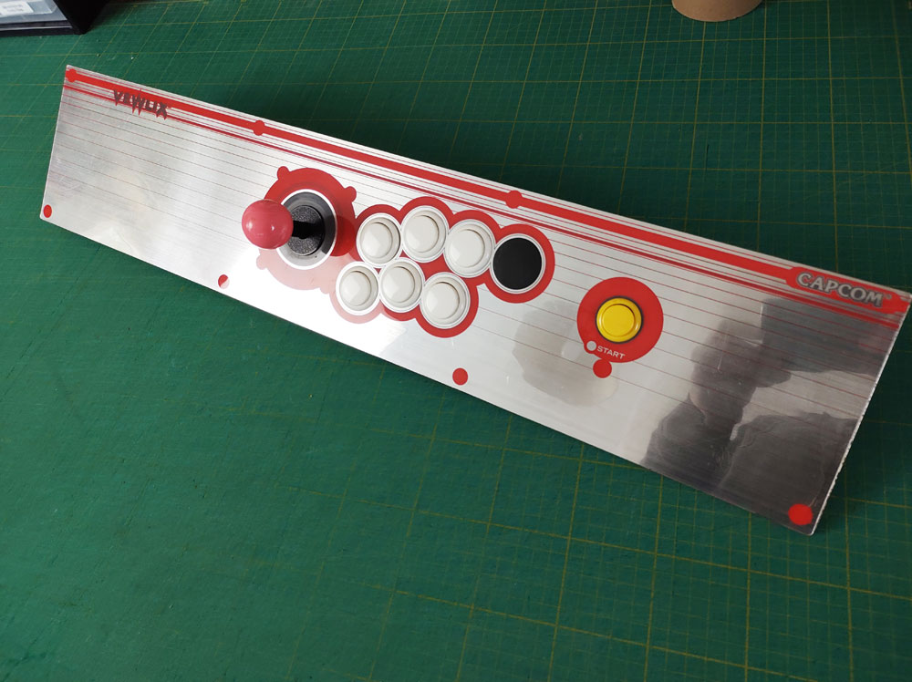

Dang... this looks like exactly what I need, but I already pre-ordered a full scale spinner from trfightstick... I much prefer what @auxn is showing, as it wouldn't require cutting a custom panel for my vewlix. I already have a sub-button panel with a coin insert button, thinking I can move the player one start up there and use it's spot for a spinner.
@djsheep question you may have answers to... does the price cover two? Only really need the one (single player "capcom" vewlix panel currently). But might be able to split it out for another system or an external player 2 rig.
The price is for a pair. I opted for one of each style (push button and a stand-alone). Really simple to install into a cab then remove when done. You can easily mount it into a fight stick for Supergun use too (make use of the extra 2 buttons on a 8 button stick perhaps?)
I’m still investigating with @alberto1225 making a panel for these, but like you said, this is a quick and easy option.
Given that I was thinking of cutting out the player one start (yellow button) to make space for the full sized spinner, just dropping in a spinner/button instead seems like a no brainer. Looks like I shouldn't have any issues with peeling off one of the two spinners from the set. Guess I just need to decide if I try to cancel my pre-order from trfightstick. Will think about it. No rush I guess.
Edit: broke down and ordered a set... worse case, I bet I can find someone here who wants the full sized spinner.
Edit the second: now remembering that the player one start button is a size down from the rest… so will either see about transferring the spinner to a different button of the appropriate size or bore out the hole to accommodate the button it comes with. Thinking the later will be my only option. But it’ll be a small modification to the panel.
