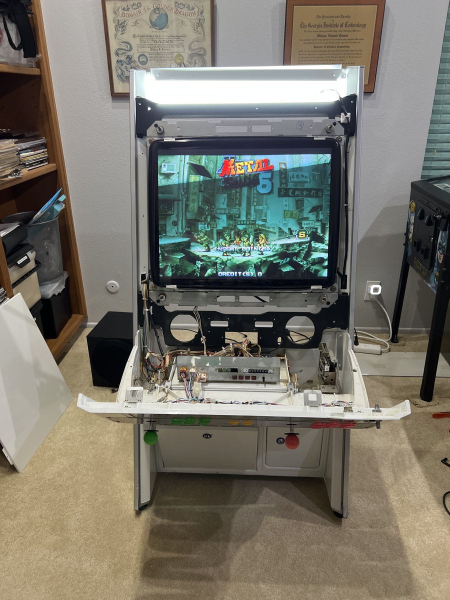

Update turned it off waited an hour turned it back on, no picture. Wondering if the VGA cable in the cab could be bad? But if that were the case I thought I’d see a no signal message.
Alright think I’m getting somewhere. I unplugged the VGA style cable from the monitor and turned the unit on. Instantly I saw a no signal message which is good news. Plugged in the cable to the monitor instantly got video. I think the VGA cable is intermittently failing. Thinking of grabbing the one from my blast city to try as I think it is the same type. But at this point ill
Probably wait for confirmation before doing so lol
Pretty stumped. I grabbed the VGA cable from my blast and made sure the pins were the same and it was the same model of Kawasaki cable. Plugged it into the New Net City and no picture. Then the trick I thought was working in my previous post didn't work either.
The biggest clue I think I have so far though is that when the monitor is working and I power it down I hear the static discharge kind of noise.
When I turn the power off when the power is not working, I DO NOT hear that noise.

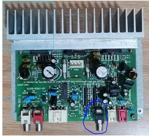

Does anyone know what this is for on the New Net City Audio Amp?
Kinda looks like a black RCA? Im looking at the wiring diagram but not understanding it.

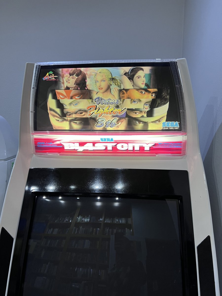

I bought the VF3 marquee above, but it came with a smaller version too. Does anyone know what it’s for? Advertising or a different cab?

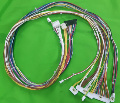

I purchased this VF3 Blast City Wiring Harness -> https://buyee.jp/item/yahoo/auction...aSGZGQ2JYRW00eWFVL2R4OVVpVVlBZG8vekVUdGxjQT0=

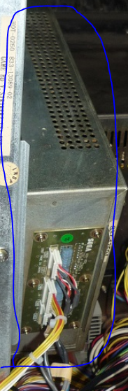

I bought this for my Sun Power Supply ->
I see though in pics with VF3 all setup it looks like 4 power connectors instead of the 3 that my Sun PSU has? Not sure if I need another power connector or not?
The Stock Blast City PSU I am hoping powers whatever is missing?
I tried to research but kinda overwhelmed by all the connectors.
The wiring loom you bought, one end plugs into the Model 3 stack, and the other end plugs into the Blast City I/O.
You should get both sound and video with that wiring loom.
The Sun PSU doesn't connect to your Model 3 loom.

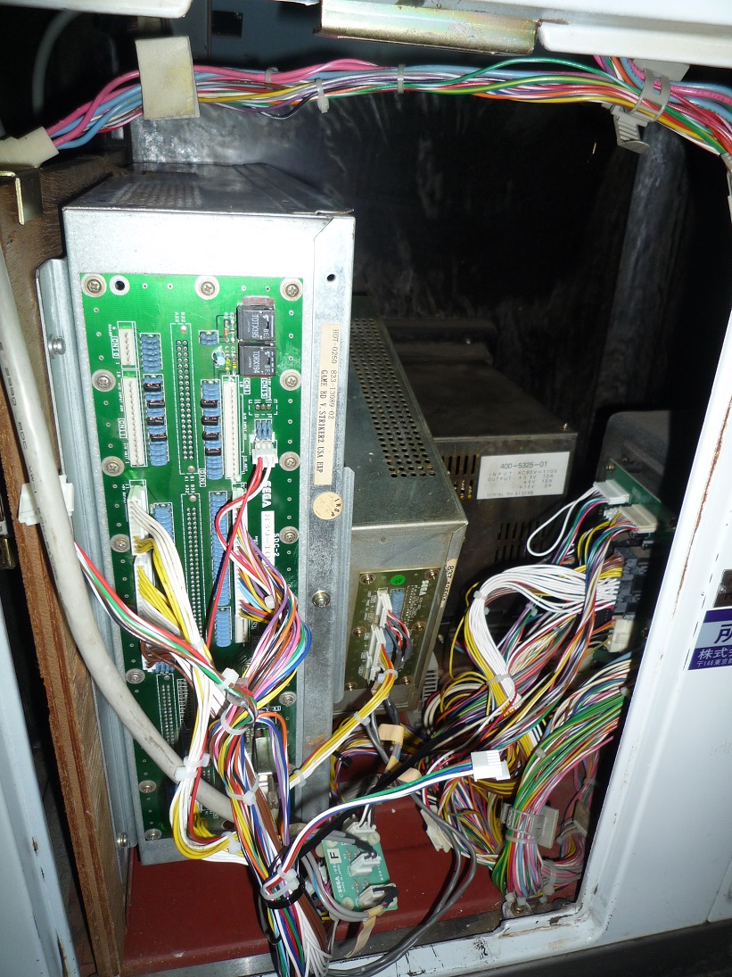

Not the best picture, but you can hopefully get an idea how the loom connects.
Ignore the DSB2 and Sega mixer, VF3 doesn't use those.
The 5 pin RGB connector is unplugged too, the built in VGA cable was being used at the time.

If your Blast City PSU is in 100% working order, it will power the VF3 stack just fine.
You will need to check the voltages, there's an adjustment pot on the Blast PSU.
Did you actually try and connect the Model 3 loom to the Sun PSU?
You will find that the connectors are different and they wont plug into each other.
I've added a picture to the above post.
That's how I used to power my SpikeOut FE stack before I made a custom loom to use a Lindbergh PSU.
If your blast has a Jamma loom already installed, take that out and plug the Model 3 loom in.
