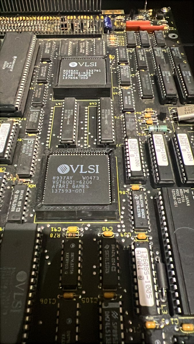

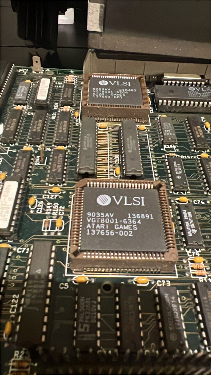

Got Batman connected. Some of the sprites shift ever so slightly not sure what’s causing that graphical glitch. I have Relief Pitcher coming next from Atari I want to test to see if I see anything similar.

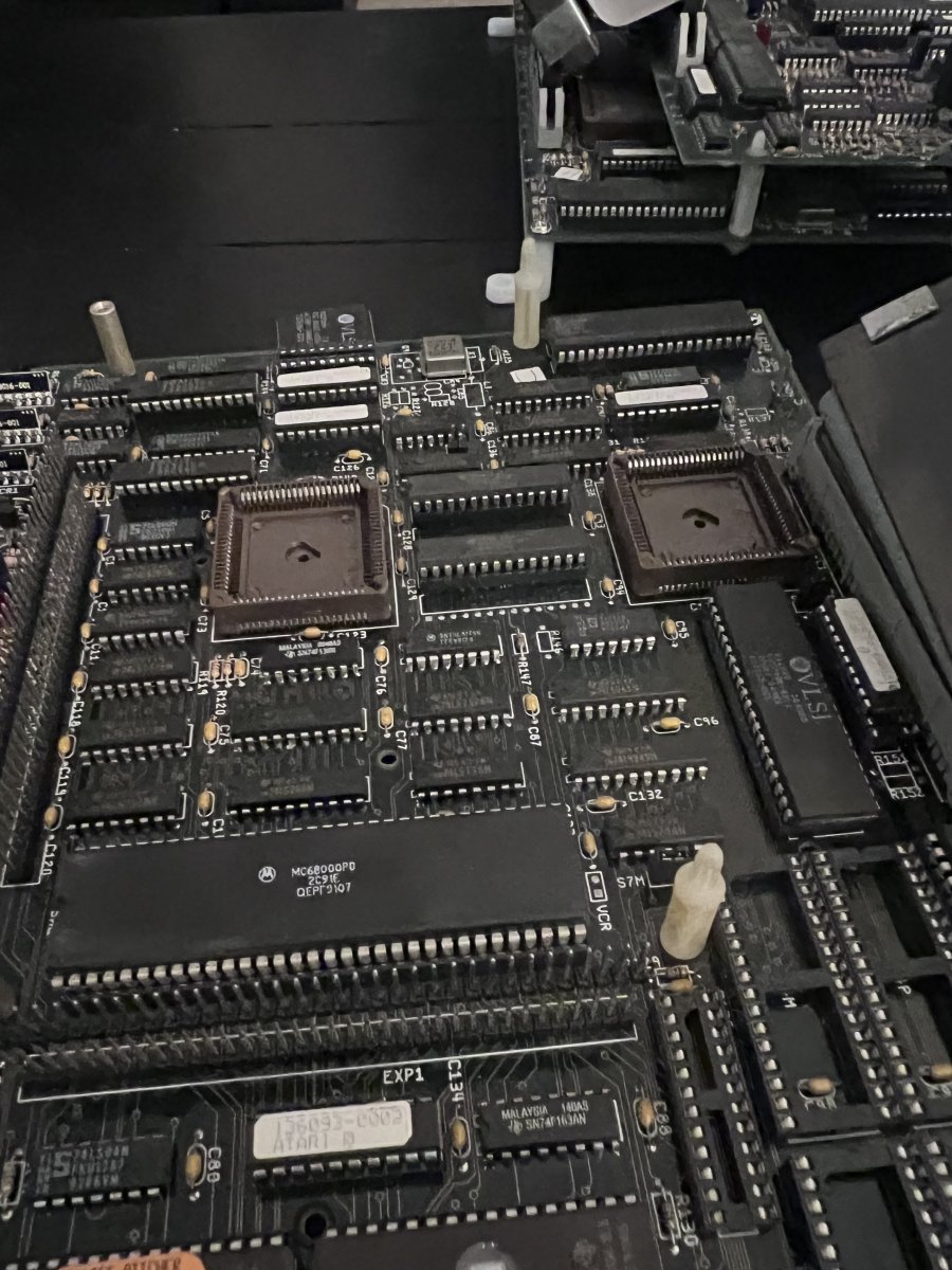

Switched out the customs from Relief Pitcher into Batman using an IC extractor tool. Both games still operate. But no improvement on Batman or issues with Relief Pitcher after the swap. I am thinking recap would be the next thing to try but that would be a first recap i've ever done. Not sure how many that would be and the difficulty.
