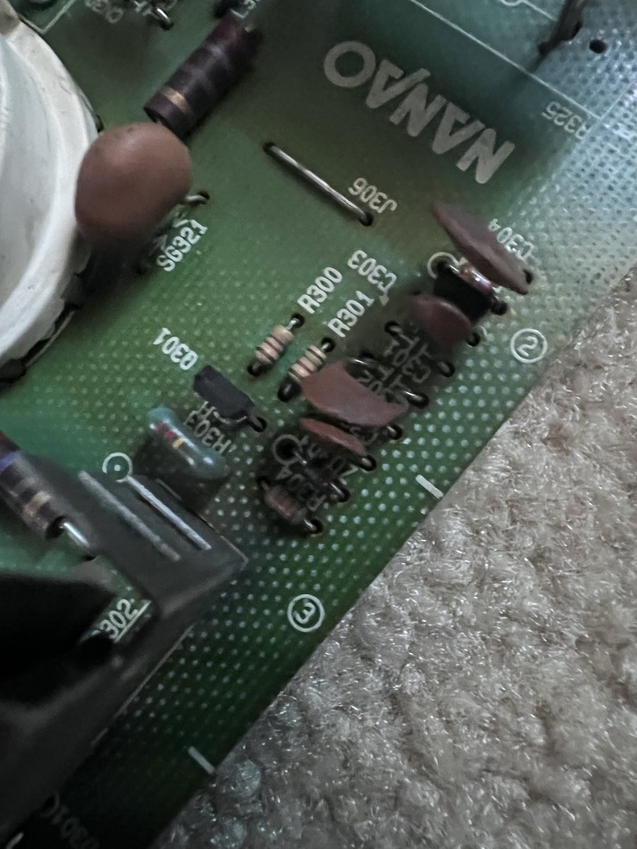

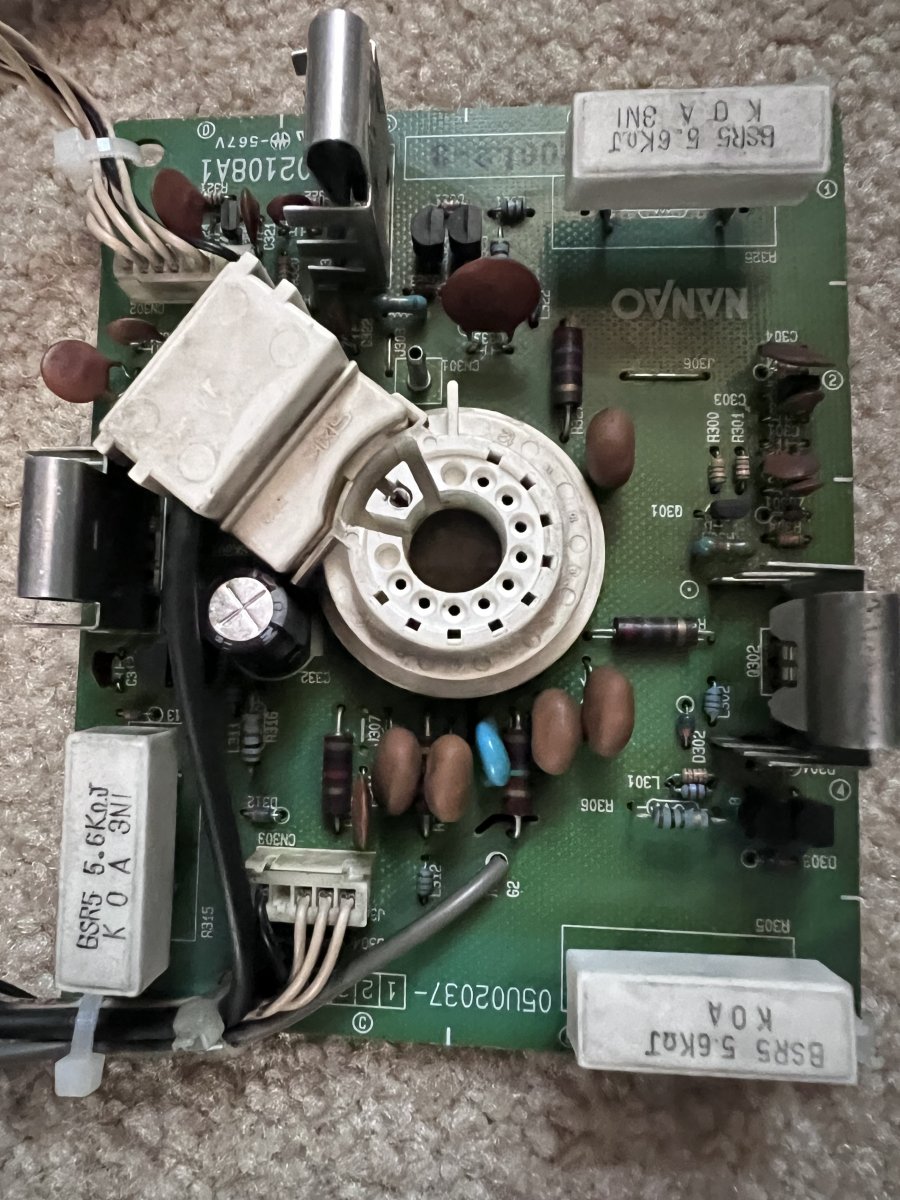

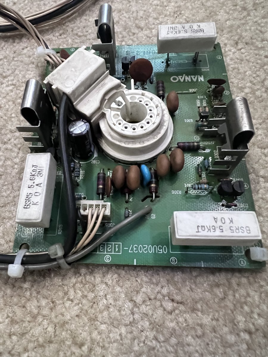

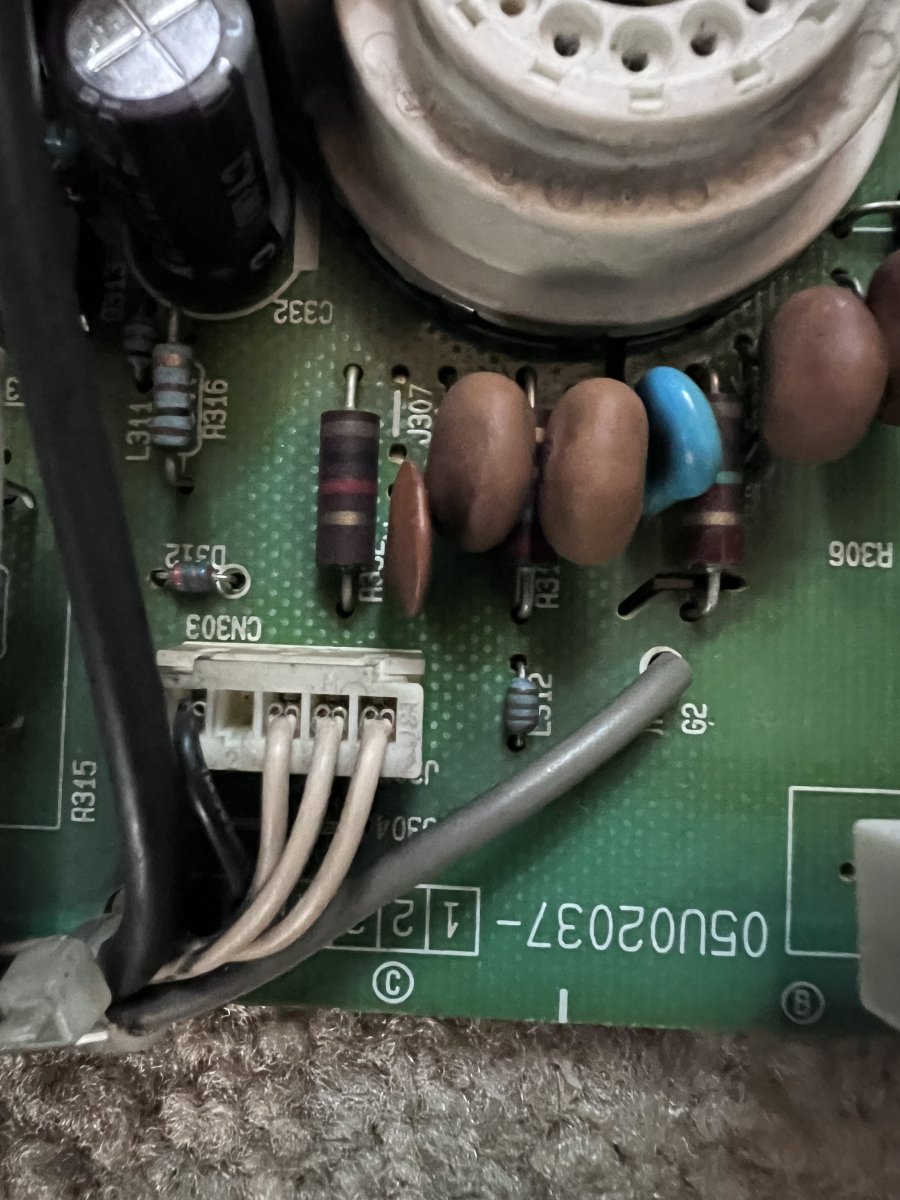

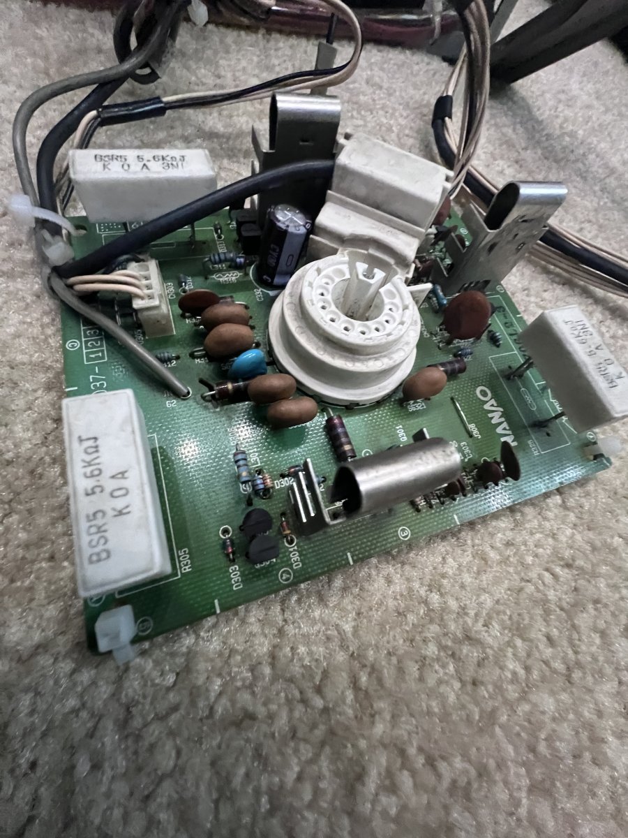

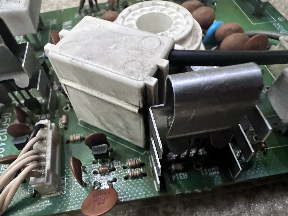

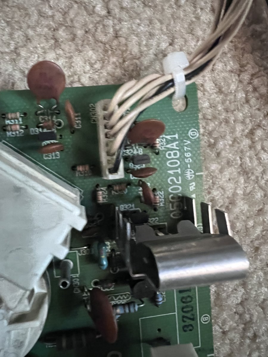

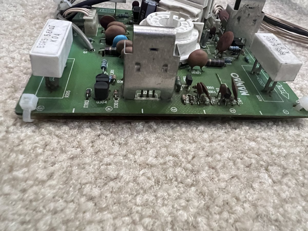

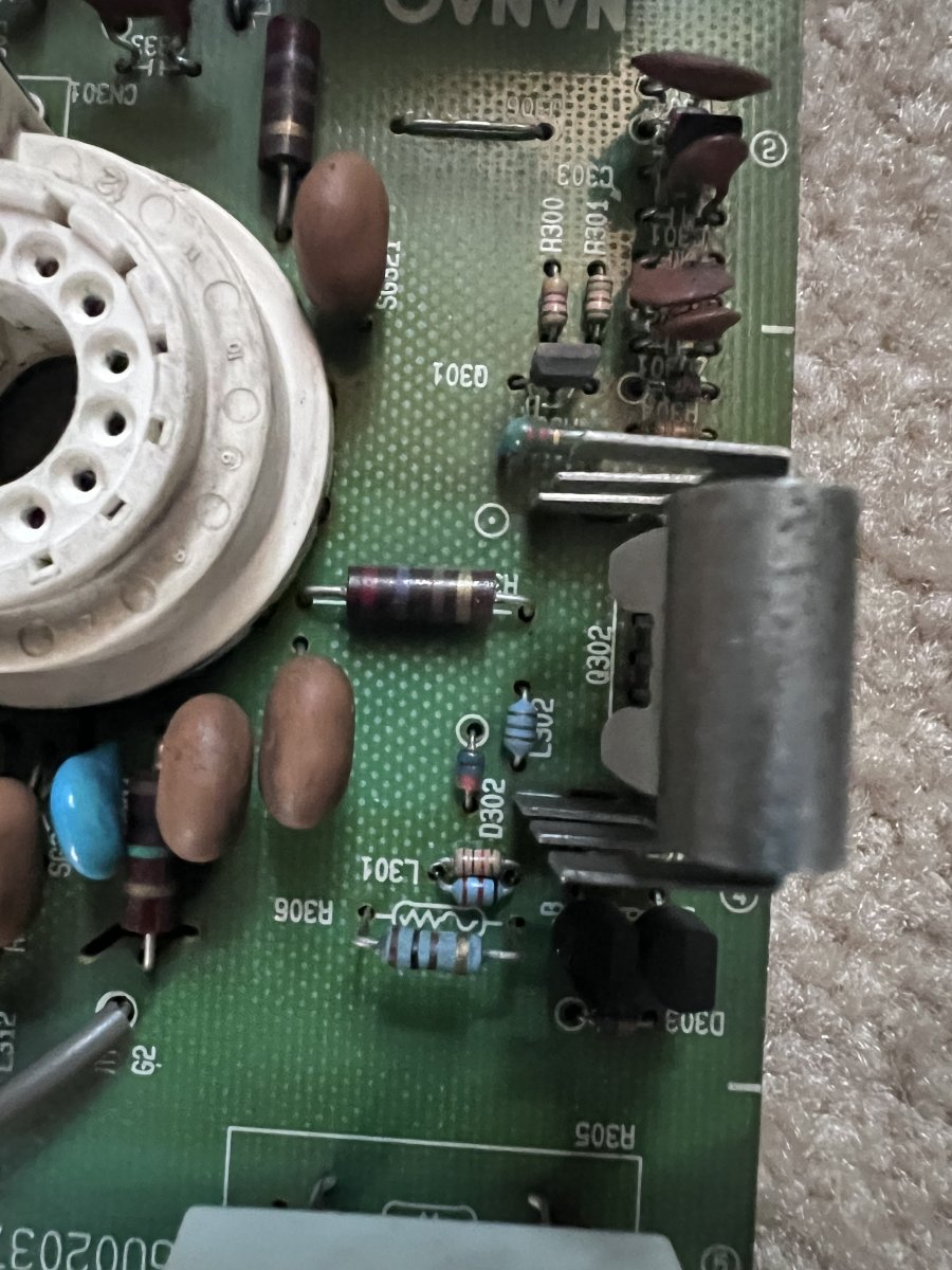

If you got no red, most likely there is something damage on the neck board, not the tube! just swap the neck board to confirm this, then will be easy to address the issue just comparing the two neck board PCB , just testing any component in red line
Why would the red work on the same chassis with one tube but not the other then? Not saying you are wrong I just am perplexed.
I tried several times on both tubes with the same chassis and I get red when using my old tube.
I definitely thought it was a chassis issue at first too until I tried with my original tube again and got red.

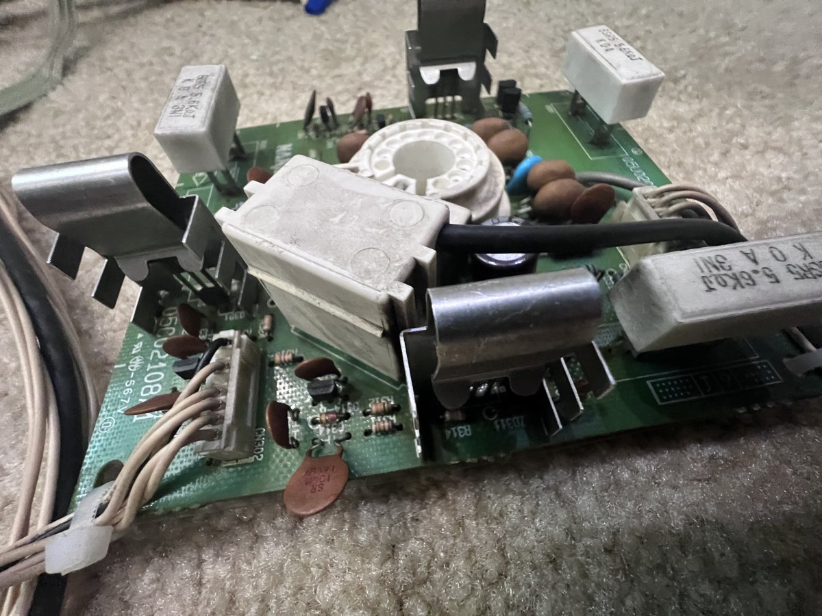

I'll see if I can switch neckboards, i just remember in the past having trouble disconnecting the wires from the neckboard but I'll give it a try.

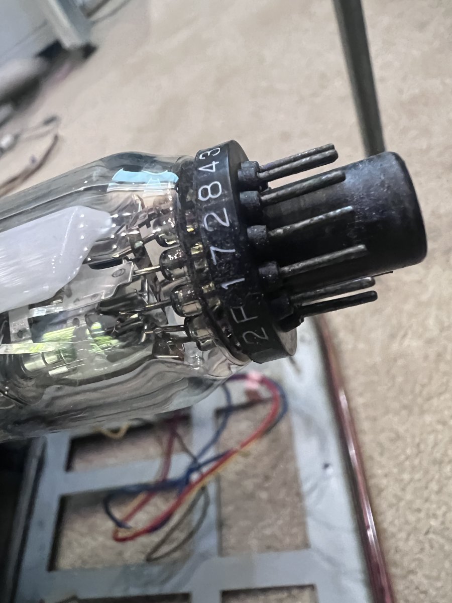

This is the neckboard from the chassis I had reconditioned by Sharp Image repair that fires red on my old tube but not my new one.

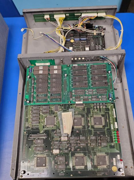

How do ppl mount Sega model 1 . 2 . 3 boards without the cage? I thought ppl don't like the cage because it breaks the PCB during shipping, but if they do have the cage shipped separately, would use it to mount the PCB in the cab. I E-Mailed Ken at iRepairSega and he said he throws them directly in the trash lol.

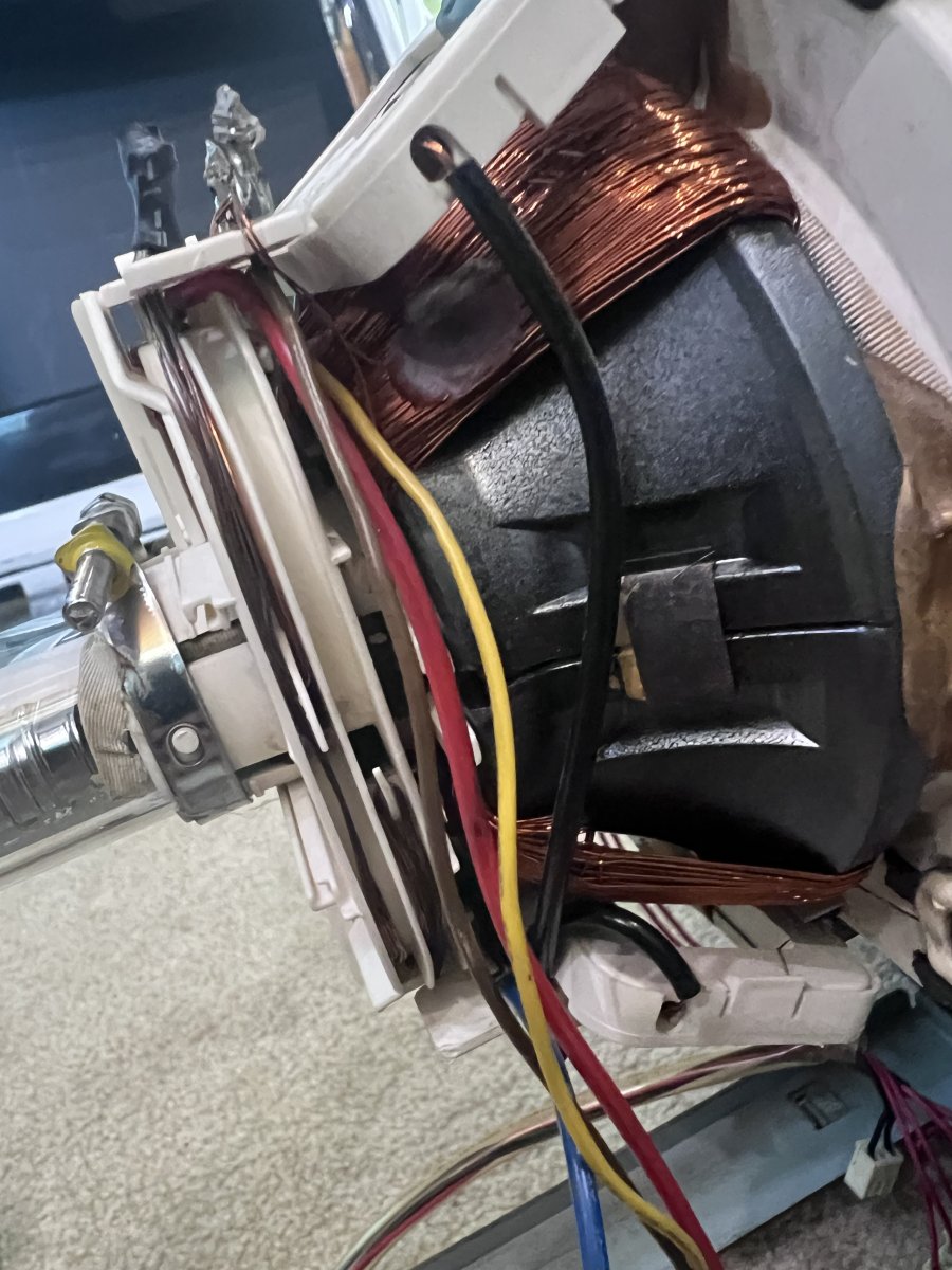

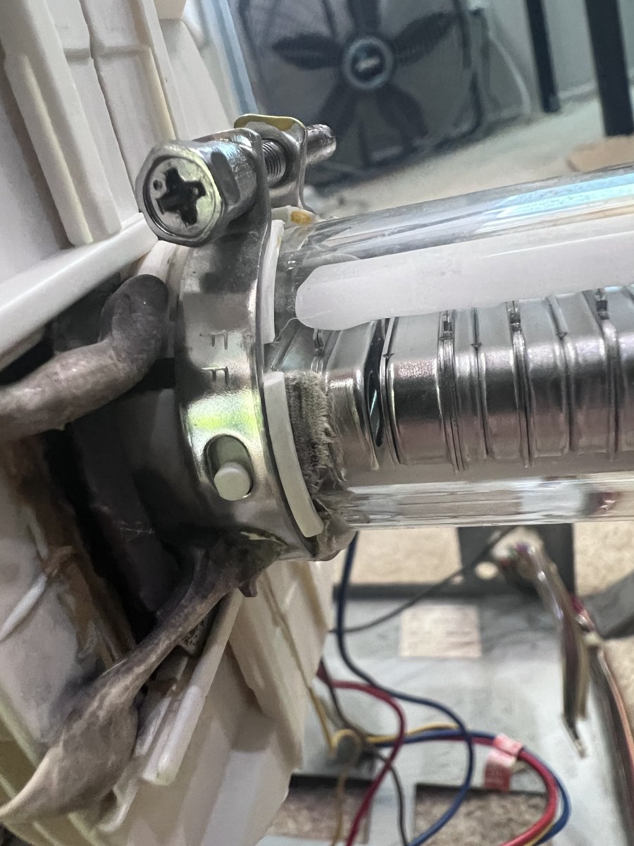

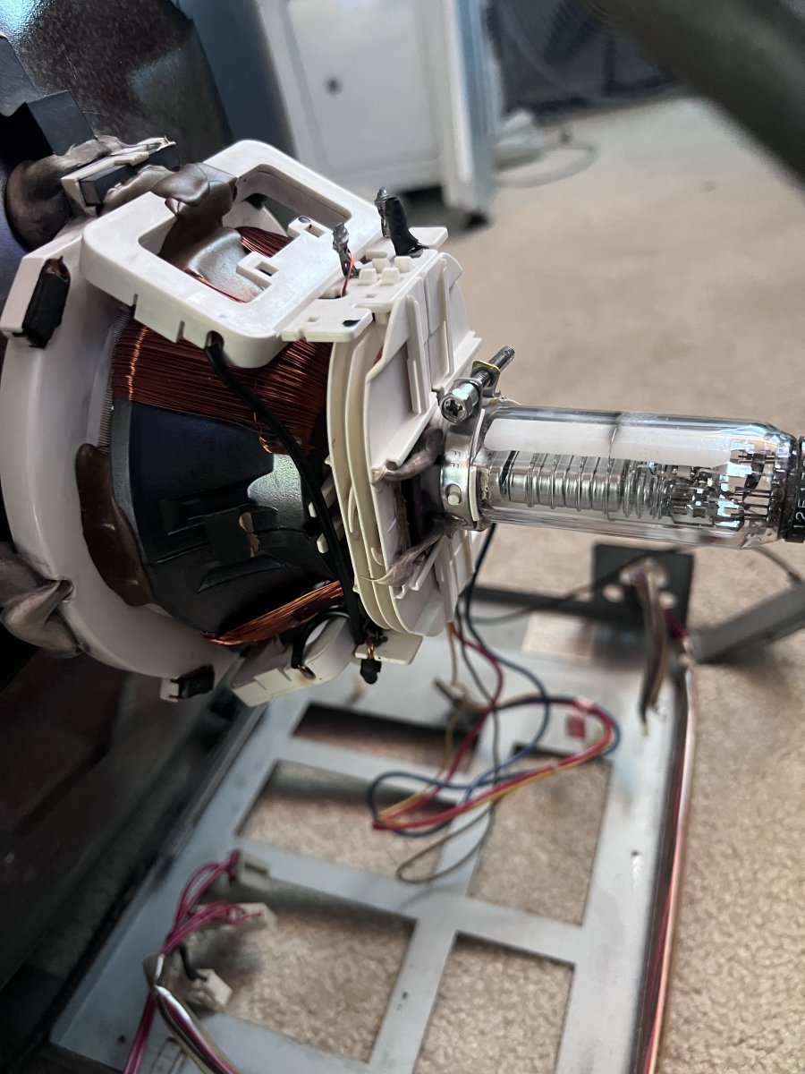

Can I just swap the yoke from my tube with burn in to the new tube and possibly get a burn free tube working with my existing chassis?
Edit : thinking if the issue is the electron gun probably not.

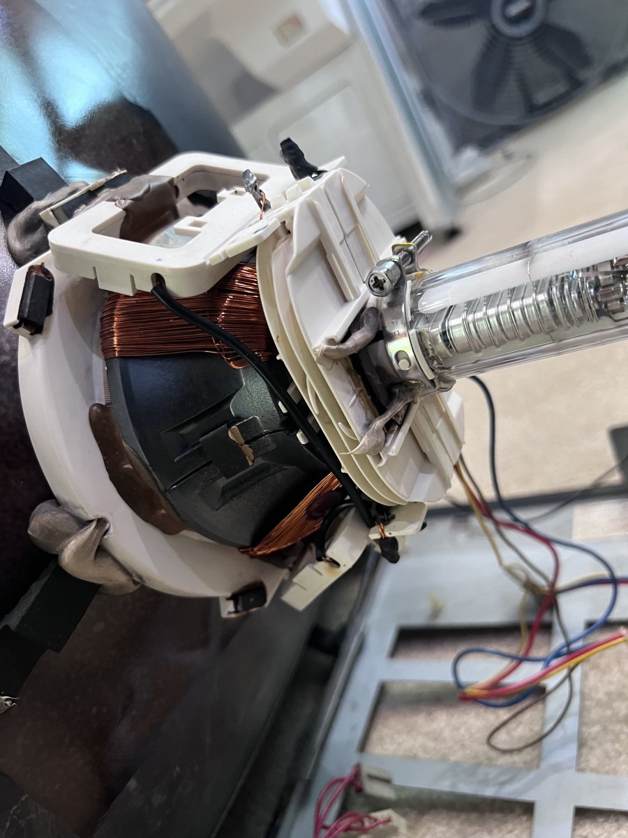

Never removed yoke before kinda scared lol. I was told to loosen these screws and “pull it out”
Not sure to do with the tube and frame with no yoke if it doesn’t fire red. I’d hate to just recycle it but idk if it’s worth the trouble

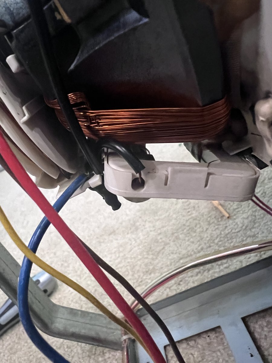

Took off the rings

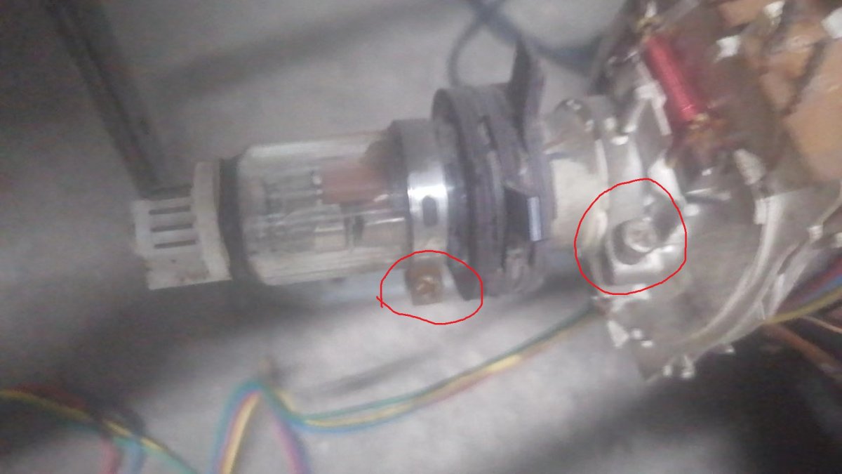

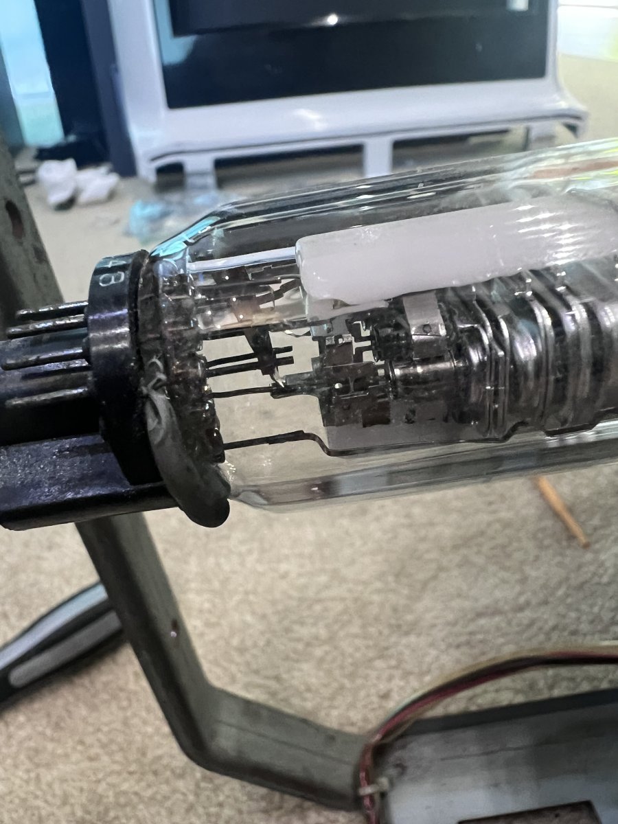

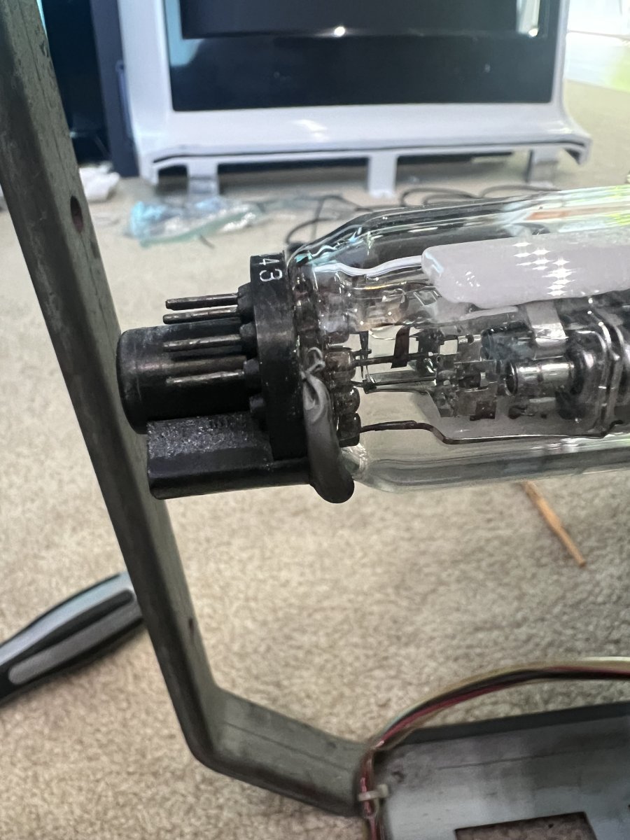

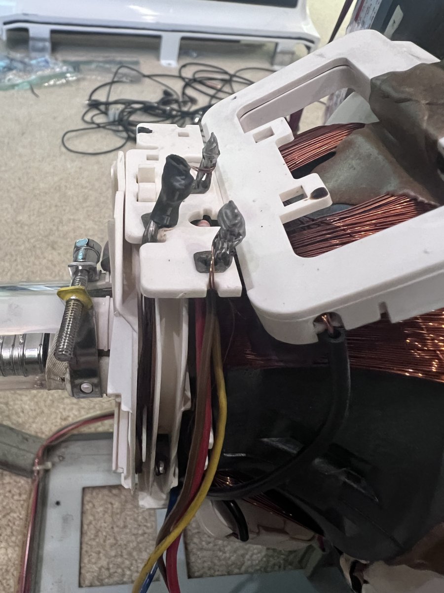

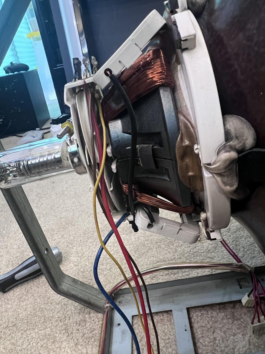

This blue wire came loose and of course my dad fucked with the rings even though there was no reason to. Now have to try to find pics of how the rings were if somehow we fix this tube issue.
Wondering if i resolder this blue wire if it could fix my no red issue
