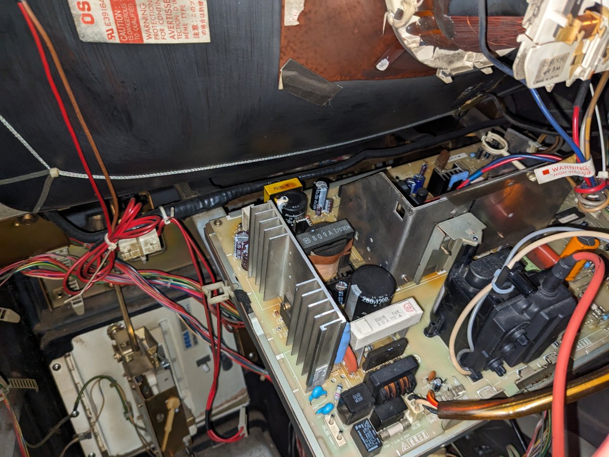

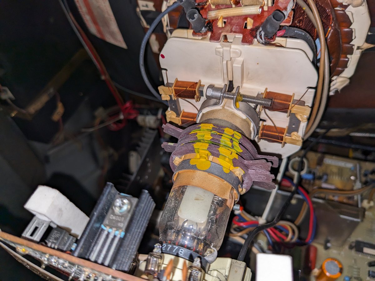

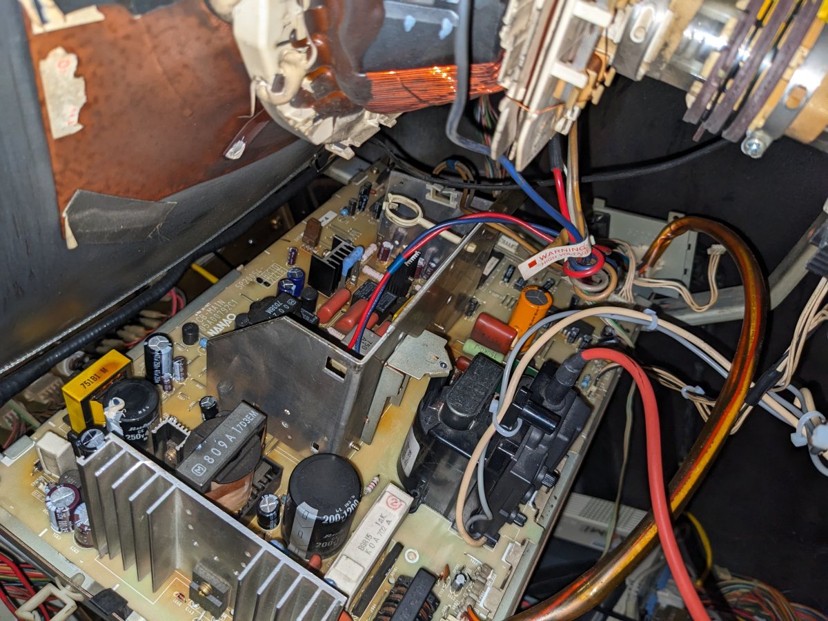

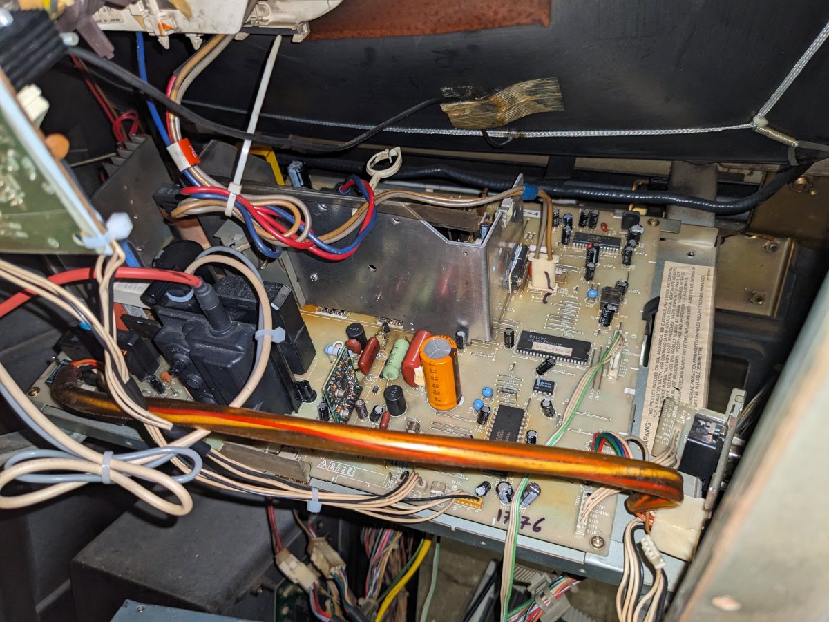

It arrived today and I hooked it back up. It clicks while powered on and I get no picture on the monitor. I can see the neck board flashing as it clicks. I've never hooked a chassis back up so there's certainly a chance I did it wrong. For what it's worth, here are some pictures I took of it inside the Blast.

Yep, pull the rings and yoke, you'll find the crack. Happened to one of my FW900s a bit ago (but they're kinda known for it).
