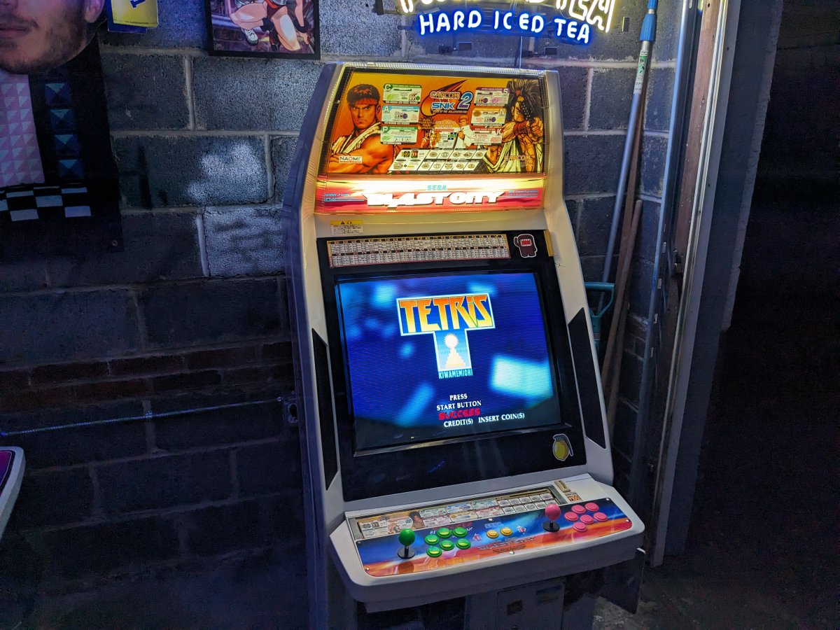

Shit I'll probably take it. What's it look like? My Versus has a monitor with bad Tetris burn in and I don't even think about it.

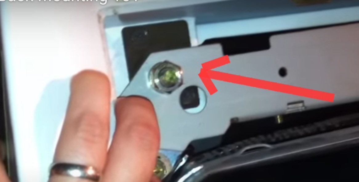

AFAIK, when installing a D9200 in a Blast it's easiest to use the 2931's frame. When installing the frame on the D9200, it's best to "back mount" it by putting the tube's mounting tabs behind the frame. There's a thread about it on here somewhere.
I'm not sure if using the D9200's frame straight up doesn't fit at all or just doesn't fit with the bezel nicely.

It will NOT fit as the Blast uses the tiny "half crescent" holes to mount the monitor. They won't line up with any other frame. You must use the 293X frames. Ms9/Ms8 frames will not mount.
