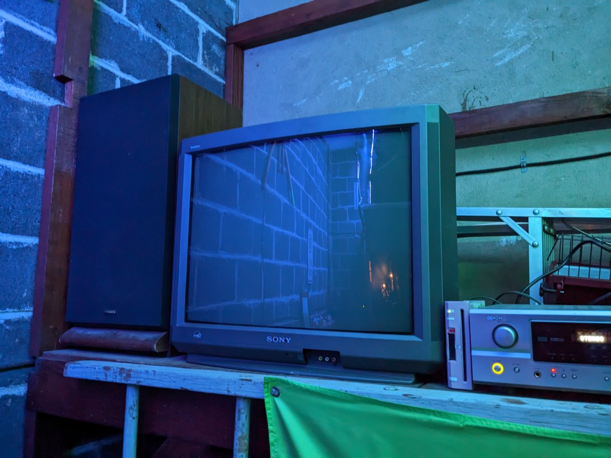

I forgot that I have this 27 inch Trinitron in my garage. Aside from the size and curvature, what else is important to look out for?

Trinitrons are not compatible with arcade monitors at all. (Aside from a small handful of extremely rare Sharp Image models that used a Trinitron tube from the factory)
Go to this website: tubular.atomized.org
Enter your tube number and get the specs of your tube. When you find another 27 inch TV, enter the tube number and make sure the specs match. Then you have a winner. Note that you'll still have to swap your yoke even if it's a match.
