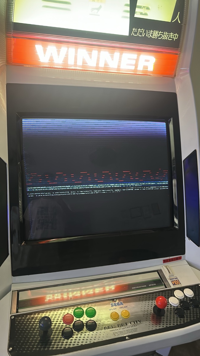

Hey everyone!
I’ve recently been trying to connect my PS3 to my blast city. I run my ps3 at 480p 4:3 (modded pal ps3 to be set to NTSC) and I run a hdmi to vga into my extron rgb 160xi that then connects to my blast city via the vga port. I’m running it at 31khz but this is what the screen looks like.
Running a jamma board at 15khz works fine but as soon as I try the vga port at 31khz the screen is all scrambled.
Any tips on how to fix this?

I don’t own a 2930, but AFAIK it has a jumper you have to manually change to switch frequency. Did you do that? Image definitely looks like its out of sync.
I don’t own a 2930, but AFAIK it has a jumper you have to manually change to switch frequency. Did you do that? Image definitely looks like it’s out of sync.

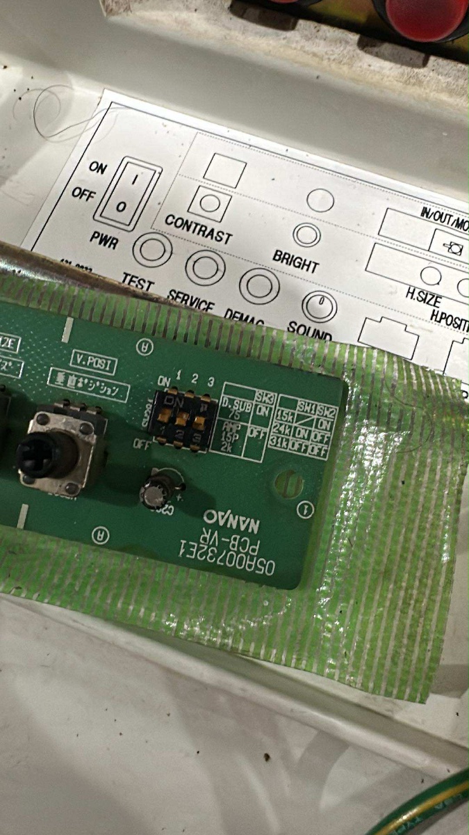

heya! Yeah on the control board I have it set to 31khz

Hmm that looks ok. Do you have any 31khz board to discard an issue with your setup?

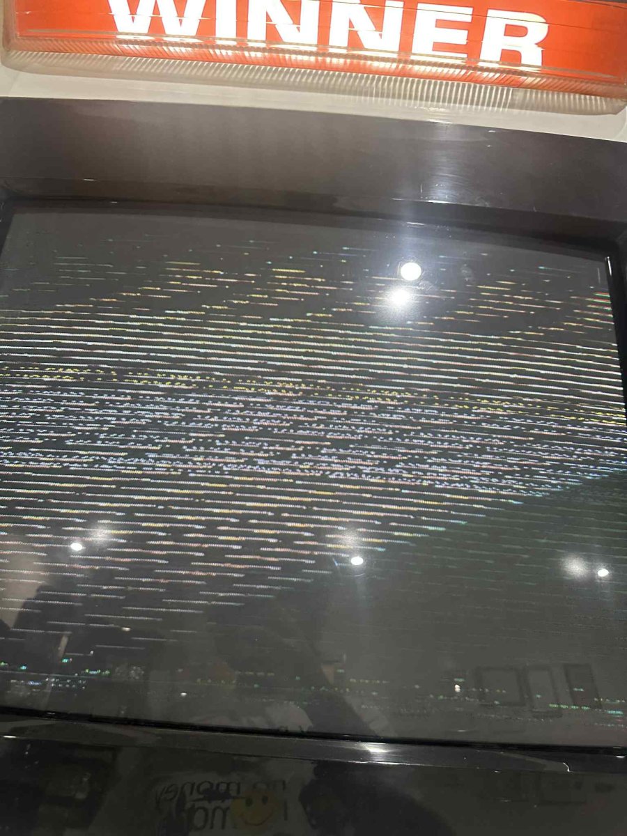

Hey there! I got a Sega Naomi recently and at 15khz is fine, but when I try 31khz it still looks scrambled like this

If you take the bezel off you’ll see some jst connectors. Remove the one with RGB sync and ground. That’s for 15 kHz and distorts the image if it plugged in when trying to run 31khz
Unfortunately still same issue, scrambled 😔. Thanks for the help tho! Really appreciate it
