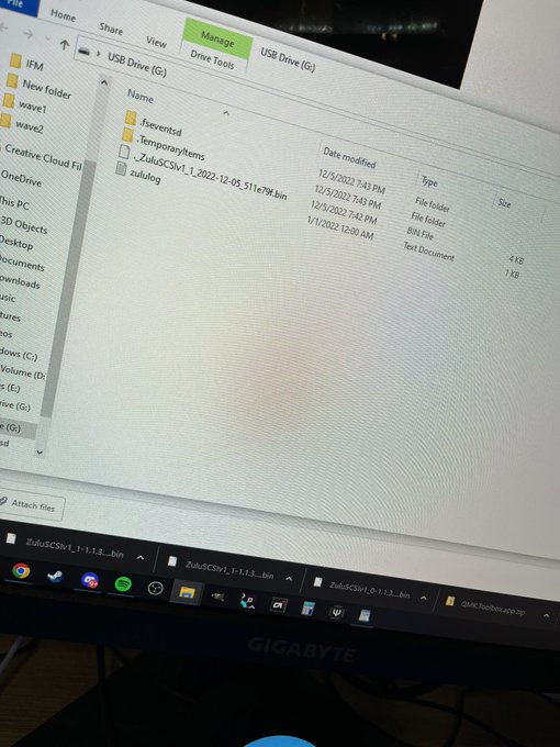

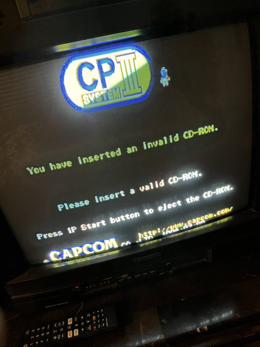

I received this message. does that mean the log wasn't written? Sorry I do not own a SD card reader and had to go to my friends house to use one.
There is no way for me to know if there is a log on the SD without it being checked on a card reader. You'll need one anyway to continue troubleshooting or to change ISOs.
it appears the log file was written. Is there a specific ISO I need to upload on the SD card? I have an original BIOS cartridge
That looks good, you just need to put the CD ISO you need in the same base directory and name it per the documentation. If you had a working CD you just need the ISO of the same.
