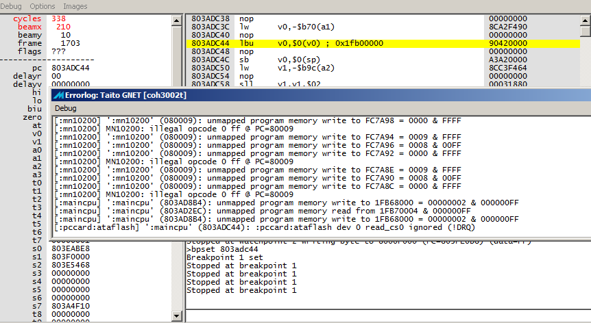

Well i found out why the mod bios does not run in mame.... This old chestnut...
If you like dinosaurs you may of seen it before Haha

So what was the issue with Modbios not running in MAME? was it some unkniown commands ?
Mame can't do 32 bit reads and writes to IDE peripherals such as hard drives (why primal rage 2 is fucked) and CF cards (why Modbios is fucked)

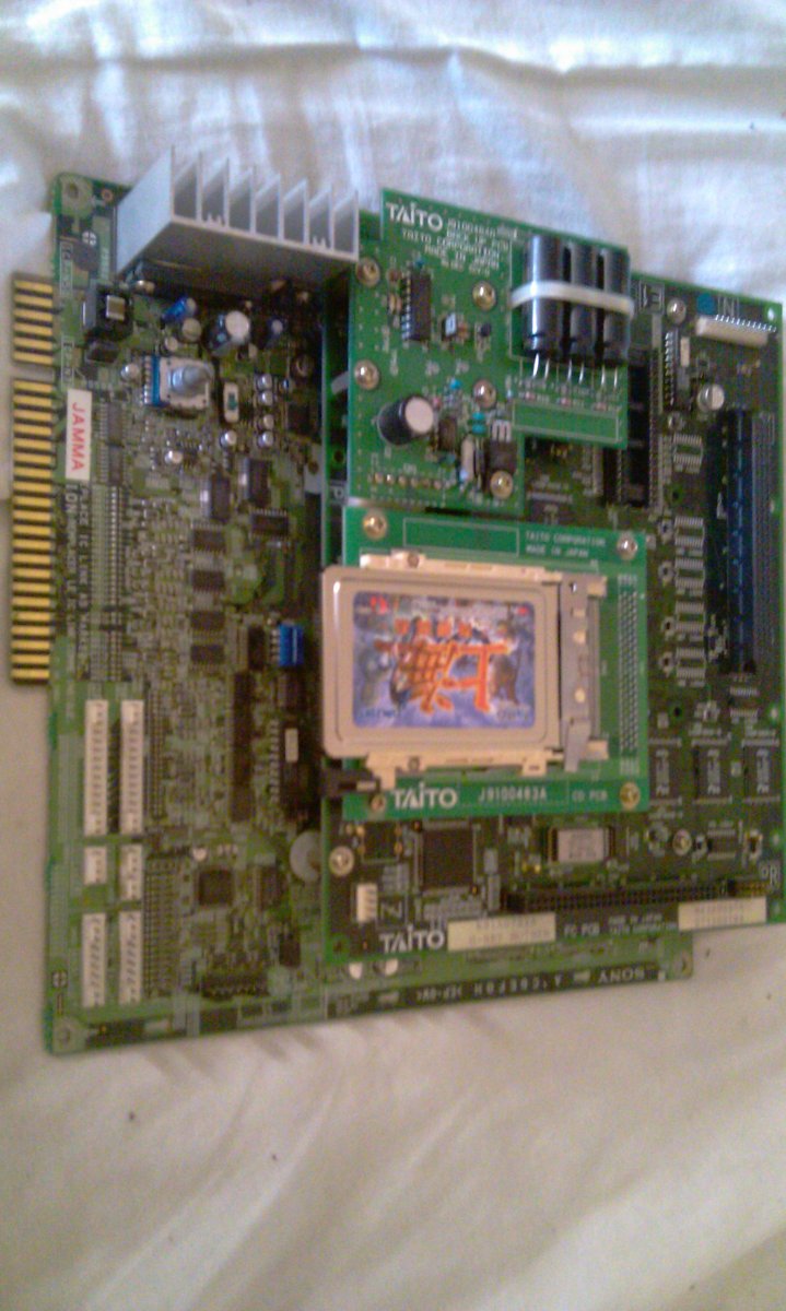

Twisted the king of arm twisting has sent over a GNET for experimentation.
