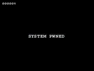

Well, now i have the bios running how i would like, lovely and decrypted... flasher program and both V1 and V2.
Still waiting for the ZN1 key , still need to figure the "lockout"
But.... if i can't figure it out the lockout, we can do all the ZN1 games on ZN1 (with bios board and a decrypted version of @twistedsymphony 's mawasunda bios) + GNET top board by simply flashing the bios via the EPROM socket same as usual.

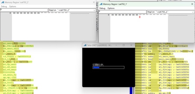

This screenshot is more important, the flasher program doing the biz, (with null keys) i actually had the u30 done years ago but nobody wants to desolder it , flash it by programmer and solder it back :)
