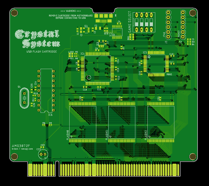

But joke's on us, because NOR flash of this size take a while to erase (approx 4min40sec per flash chip). There are nor flash chips that erase fast, but the max capacity for those is 32mbit. We're using 3 x 1024mbit chips.
:D
As this a proof of concept design, I included the circuit for the security pic for further testing. Decided to go with a CPLD (like a mini fpga) for bank switching (selecting games) and being able to maximize flash usage for different size roms.

I will order this first proof of concept just for testing then revise for a final version that will be produced with hard gold plating on the edge connector ($$$). Prototypes get HASL :evil:

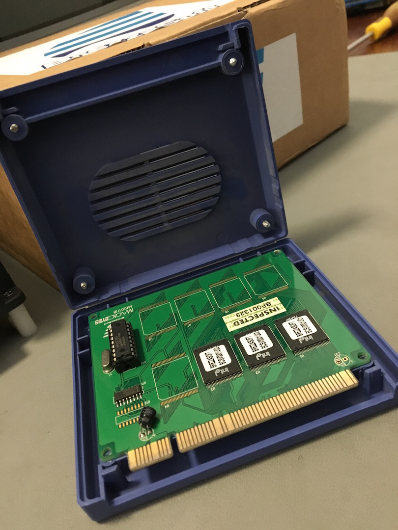

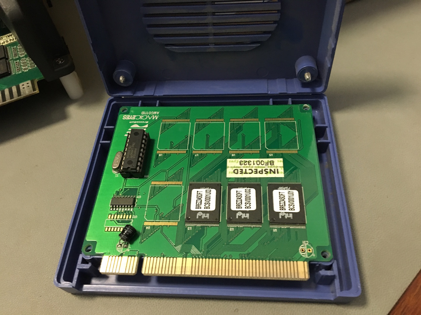

@brizzo I got a Evolution Soccer cart which I hope to use the shell of for the multi. I assume the PCB will fit in the cart fine?
What’s the estimated cost you think?
I don't have any carts with a shell so I cannot say for sure. Could you post some photos showing the inside of the shell? The pcb is dimensions and drill holes are the same as an original, but the DIP switch may be too tall. The part I selected is 7.65mm tall.
No comment on price as of yet, design is not final.

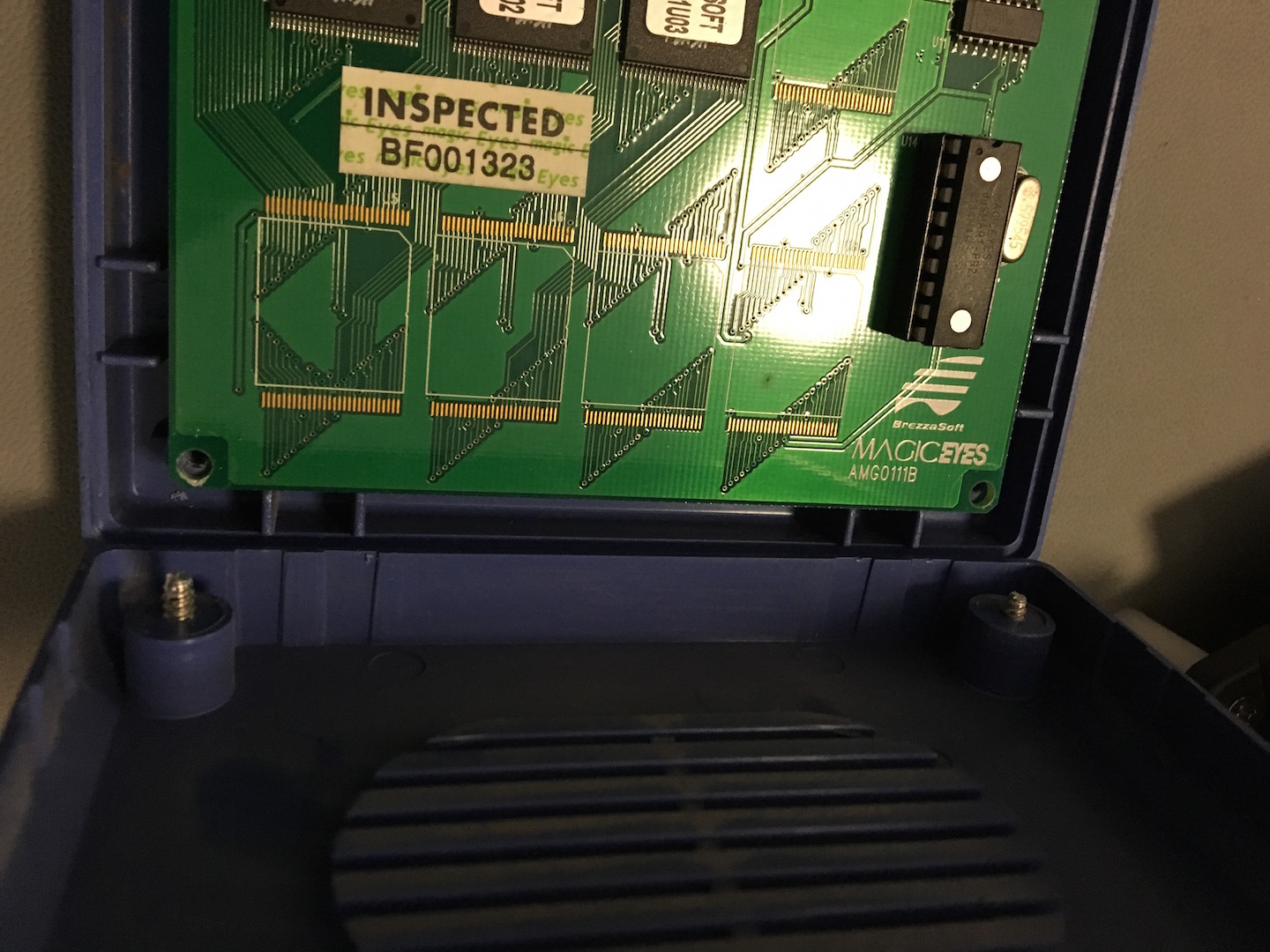

I've taken photos of the Evolution Soccer cart internals for you. I'm not sure I would even bother mounting it in a cart because I'd have to open it up to set the DIP switches.
