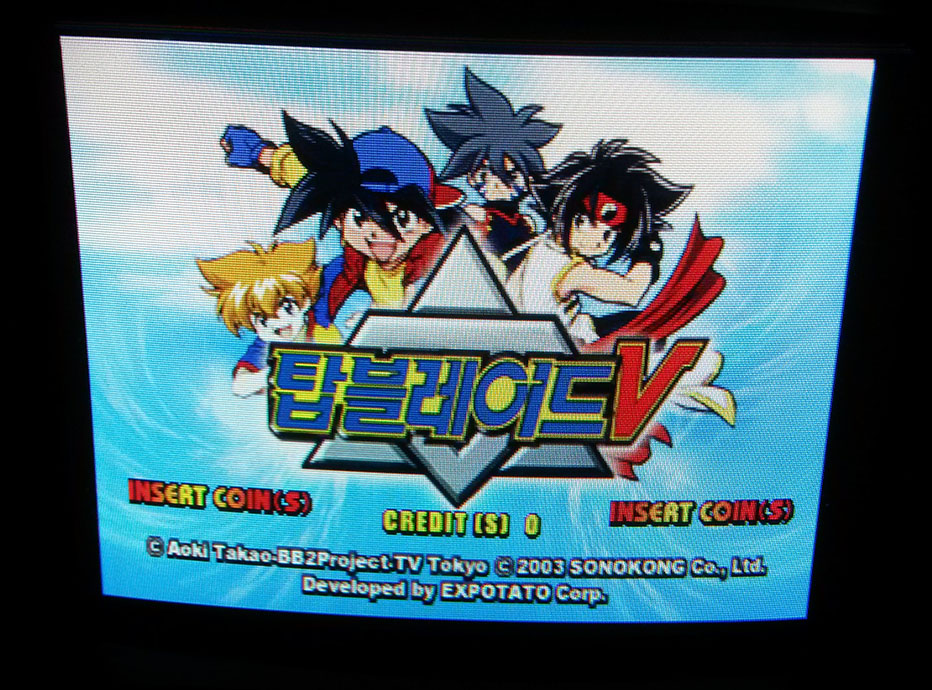

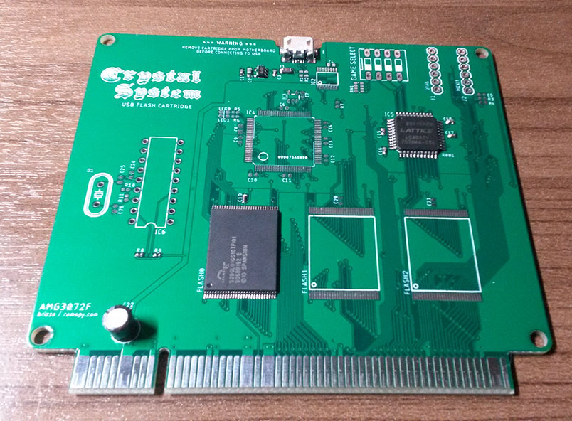

In other good news, the PCBs were delivered today but wasn't able to assemble and test until after midnight tonight. Won't have a lot of time until middle of next week to invest more time, but I got started! Programmed the flash with multiple roms before soldering. With new pcb designs I start bring up with the bare essentials in case any issues need to be solved. Right now it has usb power and cart vcc filter, pull up resistors for pic security signals, cpld for logic to control the flash, and a single 1gigabit flash chip.
Things are looking good so far! Started with trying to boot crysking, no luck.... but I tried topbladv and it booted up! Also have donghaer and officeye on the flash, going to test those now and see what I can learn.
You might want to also NOP writes to the flash chip. Commands sent are only valid for the Intel E28F128J3A chips:
Read Array SCS/BCS 1 Write X 0xFF 1
Read Identifier Codes SCS/BCS = 2 Write X 0X90 Read IA ID 1,7
I also found a test branch which I think is related to chip ID that is never taken by MAME (replacing the JNZ by a JMP might help too).
But I have patched it "on the fly" and haven't noted exact address. Should be simple enough to find again.
BTW my patched topbladv has also been confirmed working on real hardware:
You might want to also NOP writes to the flash chip. Commands sent are only valid for the Intel E28F128J3A chips:Read Array SCS/BCS 1 Write X 0xFF 1
