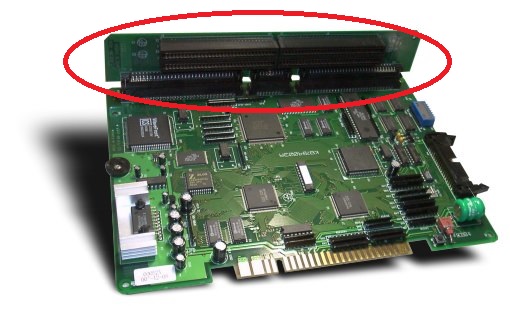

The part circled comes off. On my Revision 11 and 2x 14 boards.These can easily slip out due to flexing and also get dirty.

Yeah I know, I've checked it and pushed it in farther. Like I said, DOJ has no problems, it's just Ketsui and Espgaluda
I am slightly concerned about the size of the gap between the connectors, though the marks show that the pins should be centred in the connection. No bypass capacitors seem to be fitted.
Also, am I missing a wire that should be there?
Originally people converted other game cartridges into Ketsui & Co, and they put a voltage regulator onto the board with manual wiring so they can use 3.3V parts. The Lydz board contains the voltage converter already. You could measure if the voltage regulator works and produces 3.3V.
The three ROMs provide data to three separate busses on the cartridge, so I would expect either sound or graphics to work in some way, not fail completely.
