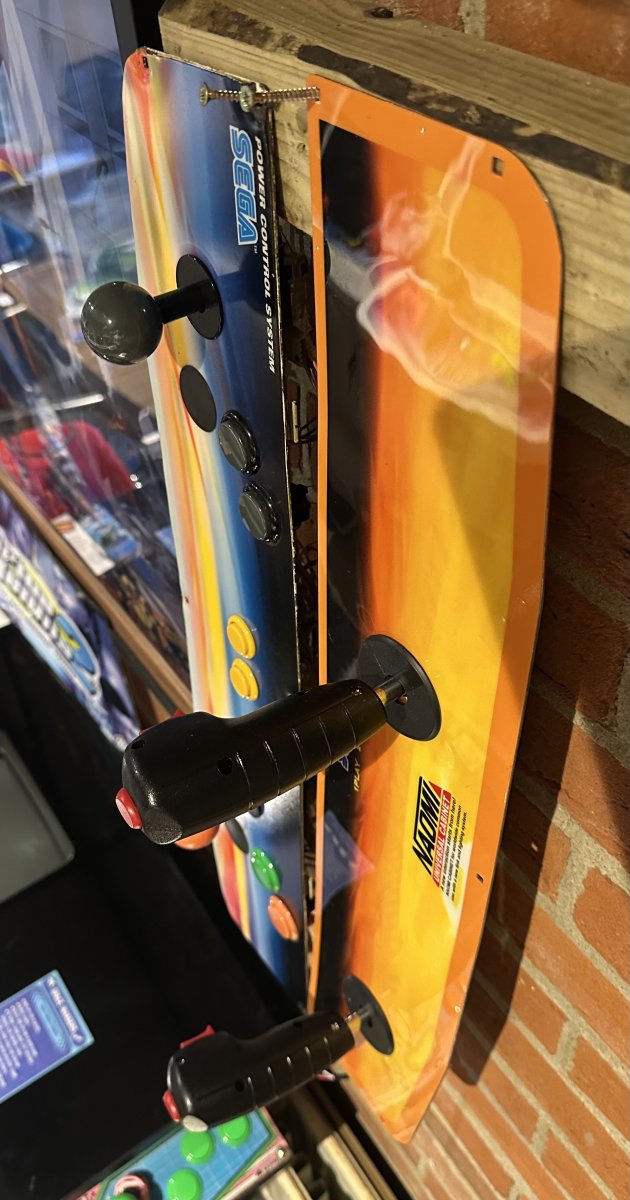

I've been testing these with some Super Scaler games and they work great. @nnap's 3d printed throttle are perfect for these sticks.

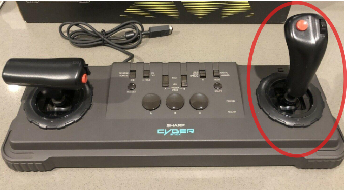

Does anyone know of a 3D printed joystick/flightstick with momentary buttons (pictured below) that would fit on a regular joystick shaft?
Are you after just the handle? I would think the DC twin stick would be a good candidate. The actual stick though is just a standard microswitch based design. :(
Yeah, the idea is to find a decent shell with buttons.

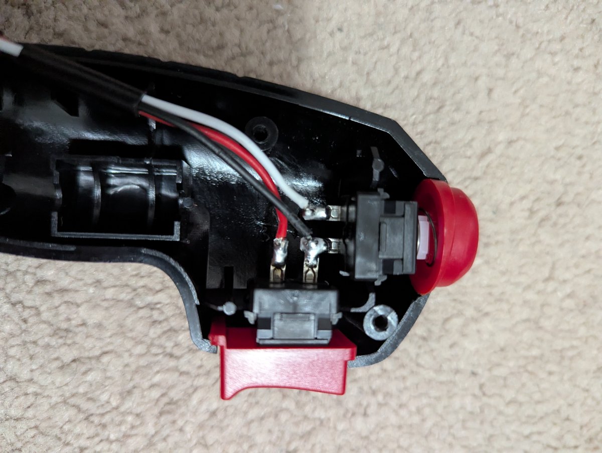

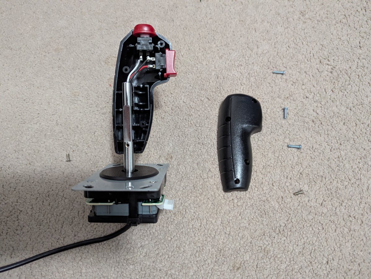

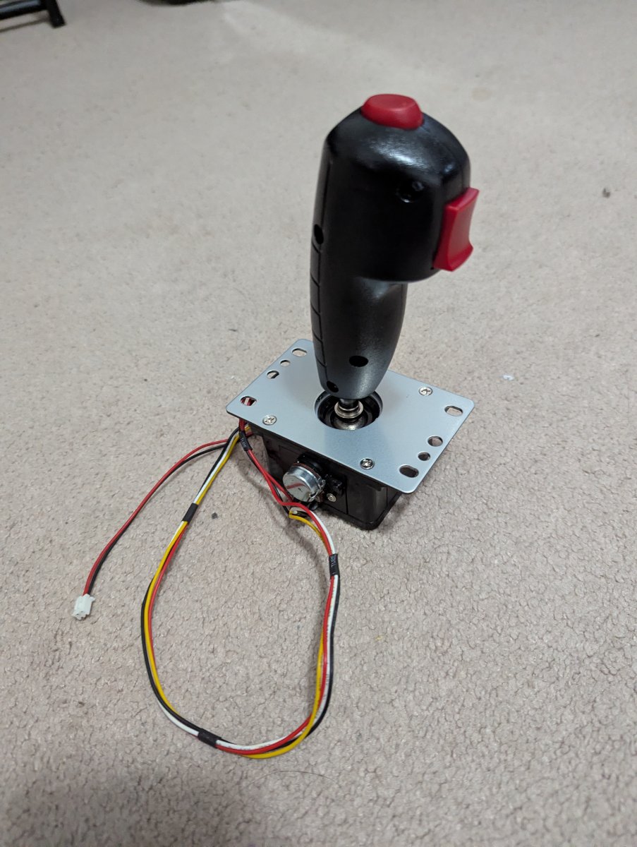

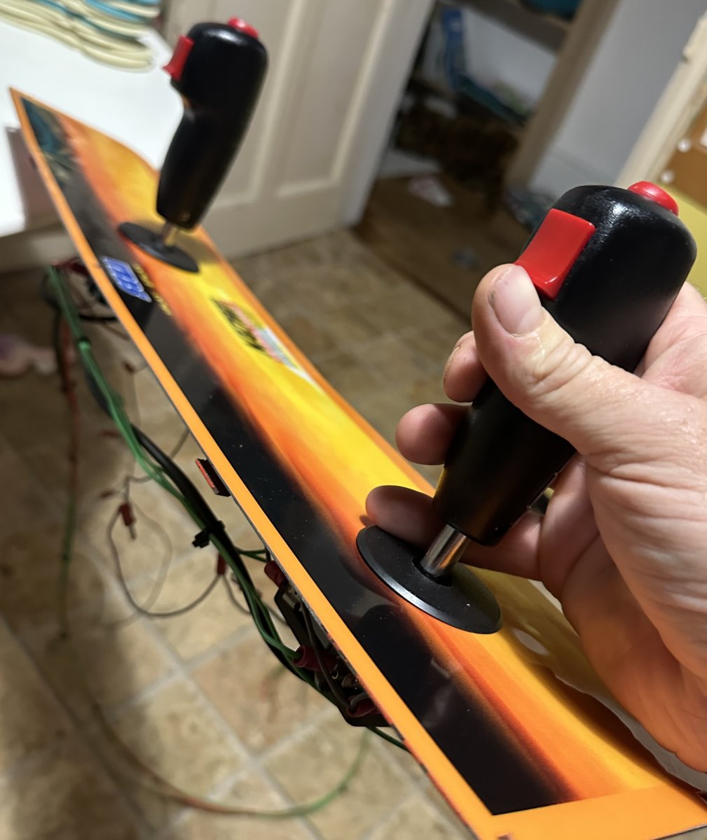

Update on this: the shell seems to fit nicely.
Since the flight stick's shaft is originally hollow to run the wires down through , you need to run the wires adjacently alongside the analog stick's shaft. The buttons' wires are a bit thick so I plan on using 28 AWG. It should fit through the shell's bottom end.
P.S. I recommend putting a some counterweight like sticky tack in the plastic shell to keep the joystick in the neutral position.

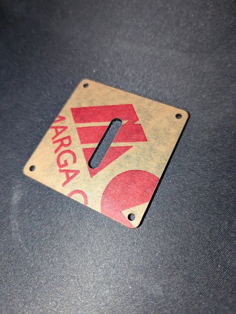

I made an acrylic one way restrictor plate for these budget sticks. It's free to anyone who wants it - just cover shipping.
