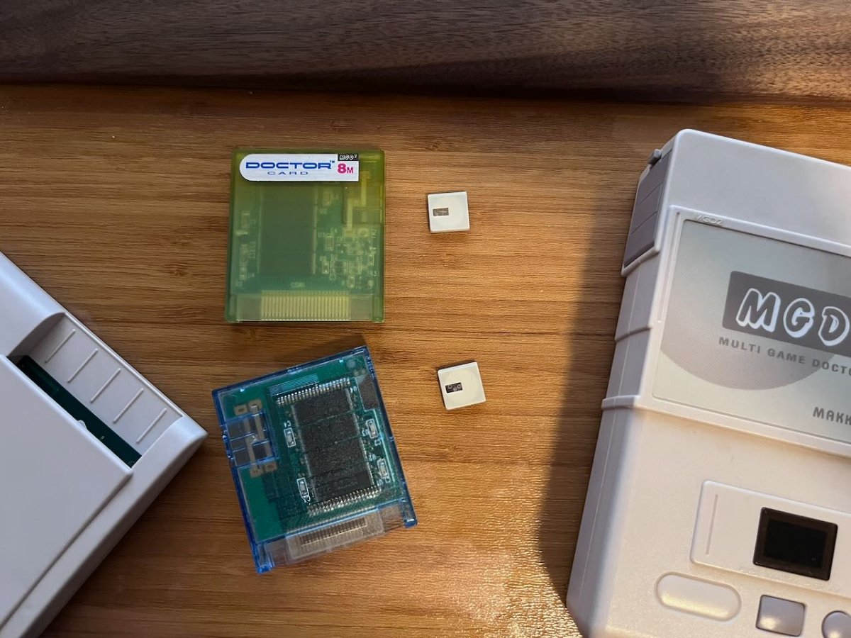

So working on getting an old Bung Makko Multi-Game Doctor 2 running, for some reason. I tracked down some SRAM cards, but the batteries in both are dead (white squares in the photo).
They're just coin cell batteries in a plastic housing. Not sure if they're rechargeable or not. Figured before I try to split them open (no clear way to do this without damaging them) I'd ask the community to see if anyone has any details/information.

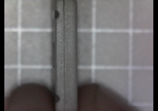

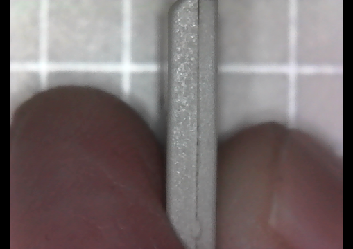

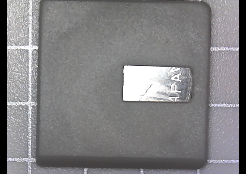

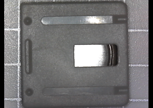

Some more pics of the battery holder. Thinking I can partially split it open (might need a heated cutting tool) and work the battery out?

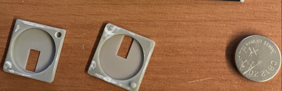

Talked to someone who has done the battery swaps and they confirmed there's not a nondestructive way to do it. I have a third, more beaten up and lower capacity, card on the way. I'll try cutting into that. From the picture they provided it looks like there are a couple pegs. Will try to avoid breaking them.
