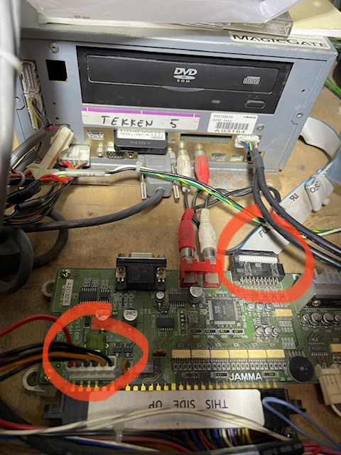

Hello, I was planning on using the PS2 controller ports for Soul Calibur II, but there's this large cable in the way. Any ideas on whether this is necessary, what it is, how to get it out of the way?

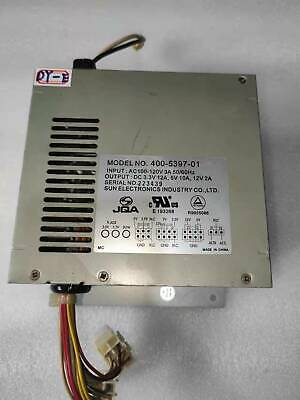

Unrelated, can I use a SUN PSU plugged in using this JVS adapter and have this Namco JAMMA i/o connected? Would the 246 detect the i/o board even without it directly receiving power?
My plan is to use the D-sub 15 and RCA audio ports directly to a monitor and speakers.
Thanks for any help!

That cable is the power cable that powers the whole system up. What you can do is move the cable to the middle of the controller ports, it would still be quite annoying and your best bet is to get some controller extension cables.
In regards to powering the system and if the JAMMA I/O pcb will still work without power, the answer is no. The I/O pcb still needs power to work. The JAMMA pcb also doesn’t need the vga or audio cables plugged in either. You might as well use a JVS I/O pcb instead as the 246 is JVS compatible.
Can I use a SUN PSU plugged in using this JVS adapter and have this Namco JAMMA i/o connected?
Yes. A JVS adapter *is required* else it won't boot.
No it will not. you have the adapter to give it power below your ribbon cable in the picture above.
Yep, what @Mrhide said is right! :D if you have a jamma harness already, you might as well use that. the system still needs either the JAMMA pcb or a JVS I/O board or else you will see the “JVS MASTER NOT FOUND” screen.

I'll soon have a SUN PSU which I can power the 246 with, can it also power the board?
Alternatively, I'm realizing this is a lot of work for the silly reason of avoiding a JAMMA harness, haha.
Here's the power supply, 12V, 5V, 3.3V.

You dont need a sun psu … any computer power supply will work.
And yes it will power both boards

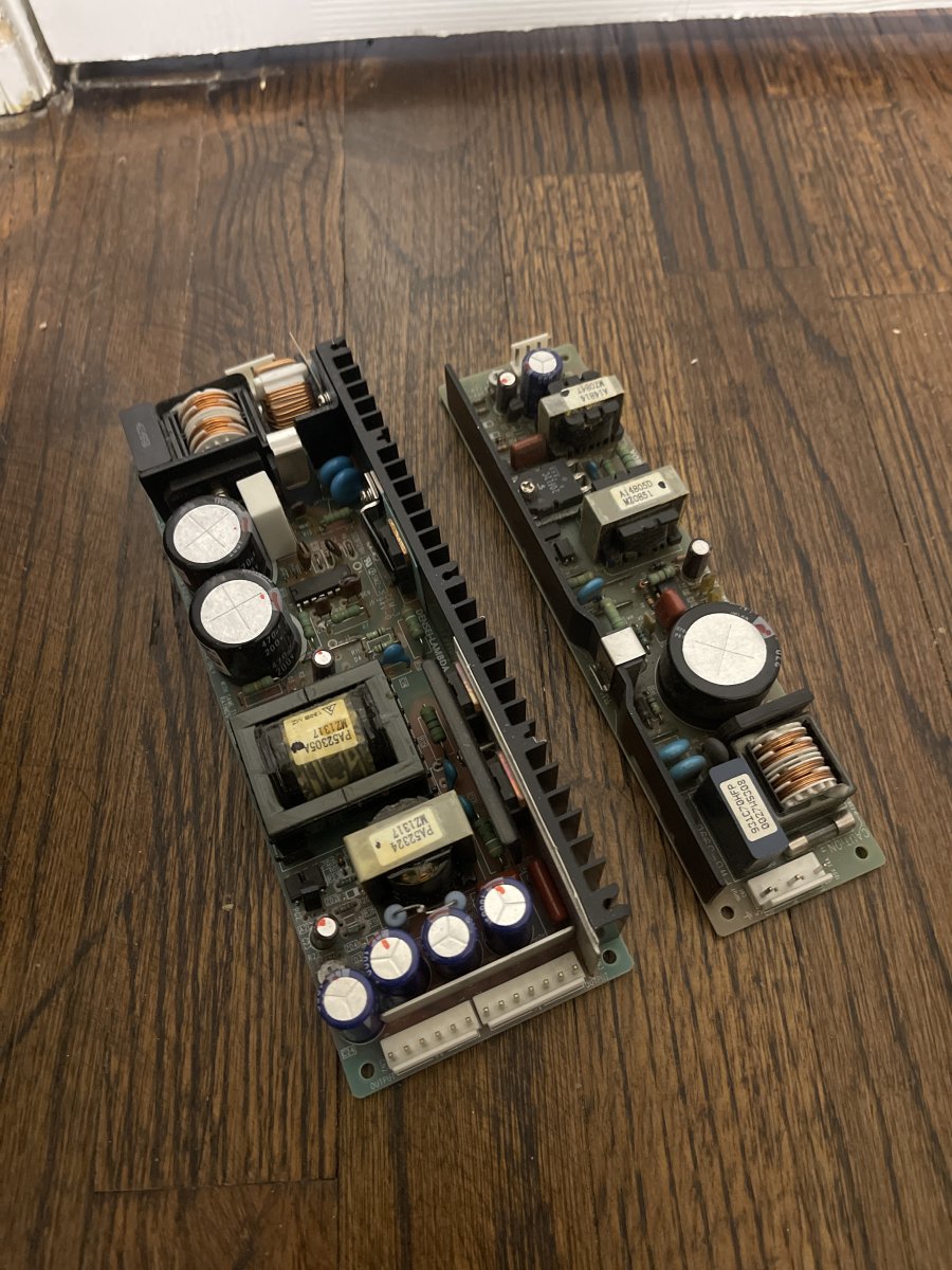

Also to note: 3.3v isn’t needed for the 246 or 256. Only 12v, 5v, and ground. Also, a small 180 watt standard arcade power supply and a computer PSU with the same wattage won’t power the system up efficiently as they are power hungry systems, especially on the 5v rail! A 200watt PSU will absolutely work, while I wouldn’t recommend a computer PSU, some people have had success. I would recommend one with an adjustable 5v pot though. Namco did use very slim power supplies and I here’s how they look. Have a look! 👀
