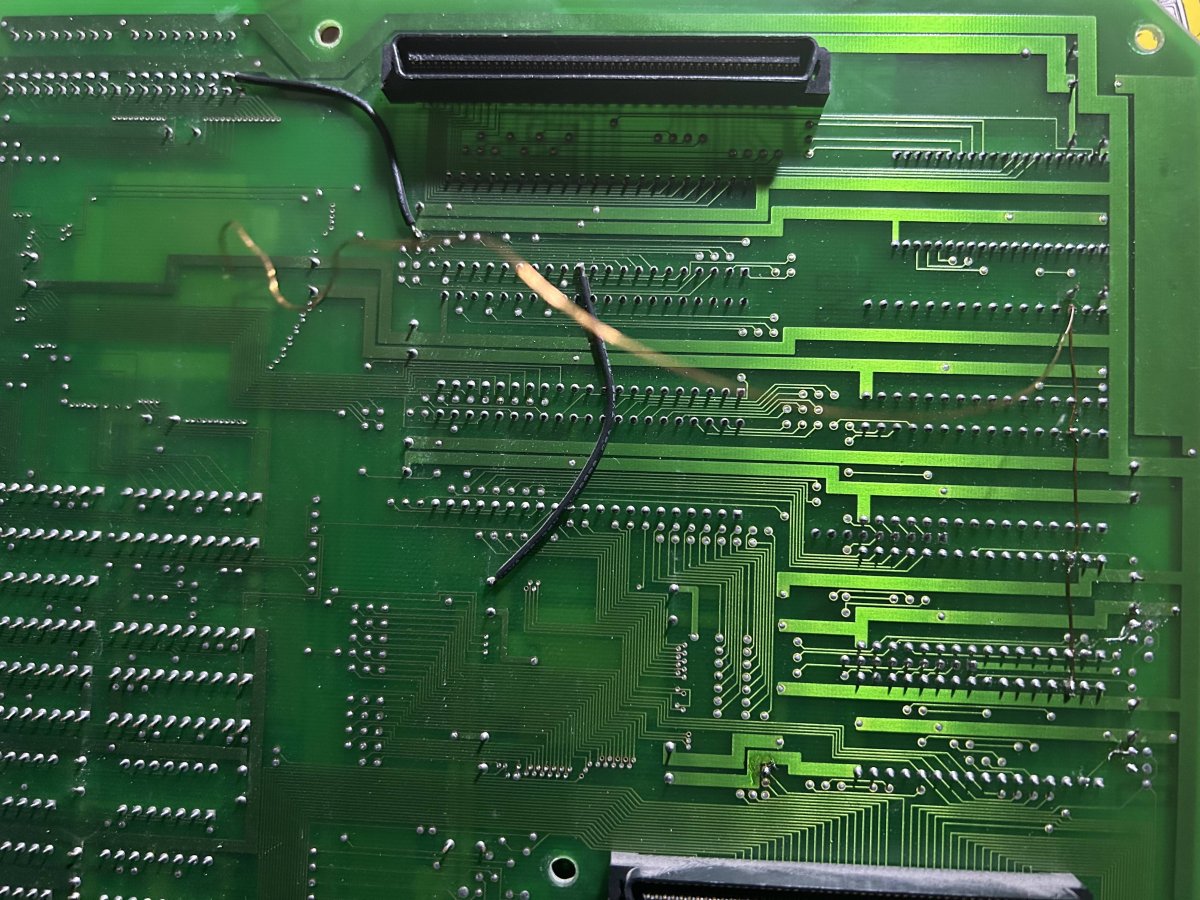

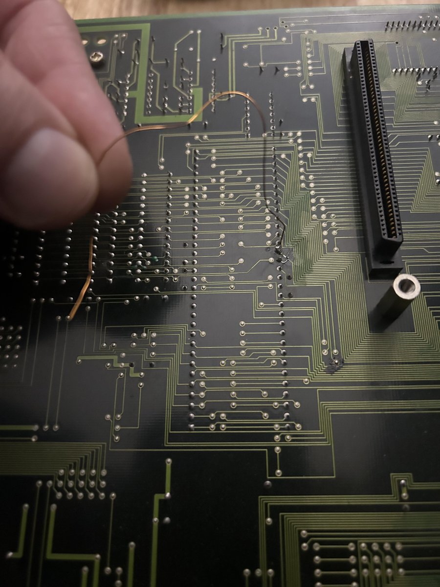

looking for some guidance in this thread. bought a dead connection via ebay (italy), probably someone from here! anyways the jumpers seem to match @twistedsymphony post, but it strays off and is jumped to the motherboard instead. this makes it impossible to switch carts to other games. can someone tell me where to reroute this wire? and also perhaps why they went this route vs keeping the jumper on the rom cart? @mypinballs help!
here is underside of rom cart, they used hopefully a insulated yoke wire. you can see the 4 connections made on the eprom on the right, the wire then goes straight to the mobo connection posted in the next pic. i want to remove this and make it stay on the rom board only.
where wire connects to on mobo. im holding the cut side, had too in able to separate boards.

they probably went this way so that the jumper that would need to go to one of the connectors (and therefor would be soldered on top and visible) would be hidden under the ROM board.
IMO this is the kind of thing someone would do if they want to sell this as an "original" and not a conversion to unsuspecting buyers. <_<
ok, so what is the solution or best way to route it so that i can disconnect without cutting a wire? also it was clearly sold as a conversion so i knew that going in.
allright, i just ran a new jumper wire with a disconnect in the mean time when using dead connection cart.
best advice I can give you is to review the wire routing I posted earlier in this thread. I don't have my modded board anymore and it's been long enough that my advice is only as good as me reviewing my own post here.
