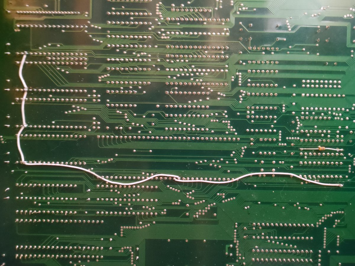

it's entirely possible that Football Champ doesn't use parts of the mobo that the other games do use, and one of those parts causes it to not run.
For instance: The bodge wire goes to A19, the reason this had to be added is because that's a higher address line only used by larger games. If there's a damaged trace on A19 preventing it from working with other games, and they're all large enough to use A19, none of them will work until that address line is repaired. But Dead Connection would work because of the bodge wire.

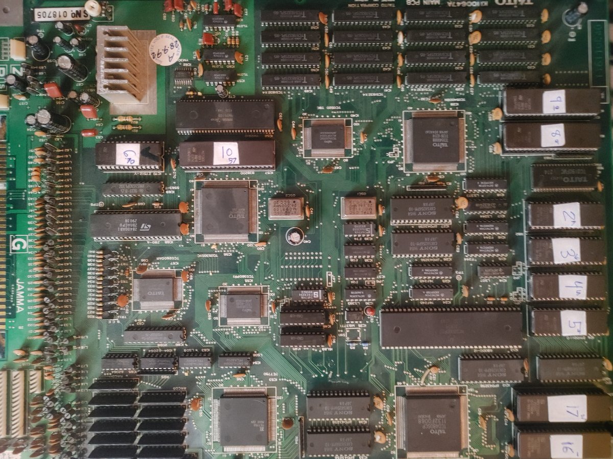

Fixed it. Removed the SHIT jumper and made it topside. When they did that jumper they severed the connection to the address line. Or maybe they severed it on purpose because they couldnt find it and routed it straight To romcart.
Now all my shit works. But dead connection still requires the address line jumper
Euro Champ 92 single board successfully converted to Dead Connection.
Thanks guys.
