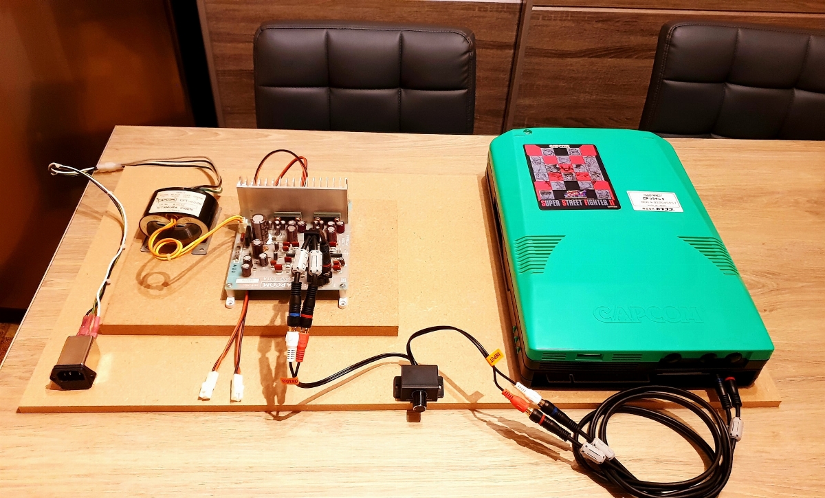

I used to have a Capcom Impress with a Q sound amp, the impress speakers are great sounding and with CPS2 in stereo was very impressive 3D like sound.
I wouldn't mind buying a qsound repro - getting the originals these days seem next to impossible.
I've tried @DRAGONKZ's qsound on the big blue and it's a very nice sounding setup.
Make an offer... I've still got the spare amp and power supply sitting there :D :D

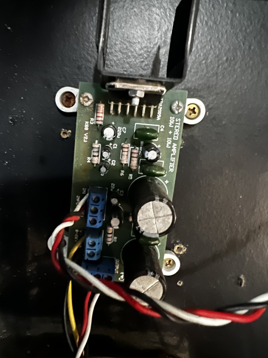

Is there still no definitive, off the shelf solution to replace the Audio Step down transformer for a gen 2 Big Blue? Mine came with the original Q-Sound Amp, no transformer, and currently has this hooked up as a replacement by the previous owner. I am guessing he couldn't find the dang transformer either.
It's just a 14VAC transformer. There's nothing special about it.
It is 12.8v AC 3A (2.5A minimum) , you can find the equivalent of this trasformer on lots of sega model 2-3 amp.
The sega one is not toroidal but just supply the same voltage.
