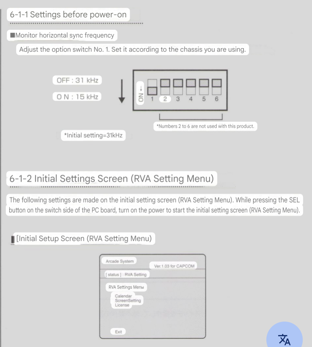

does anybody know what the dips do on the TvC board ?

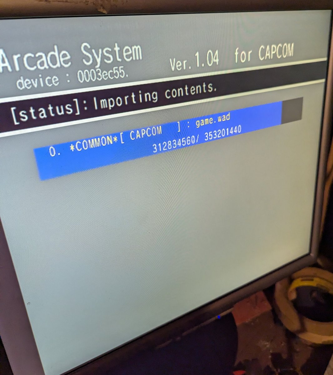

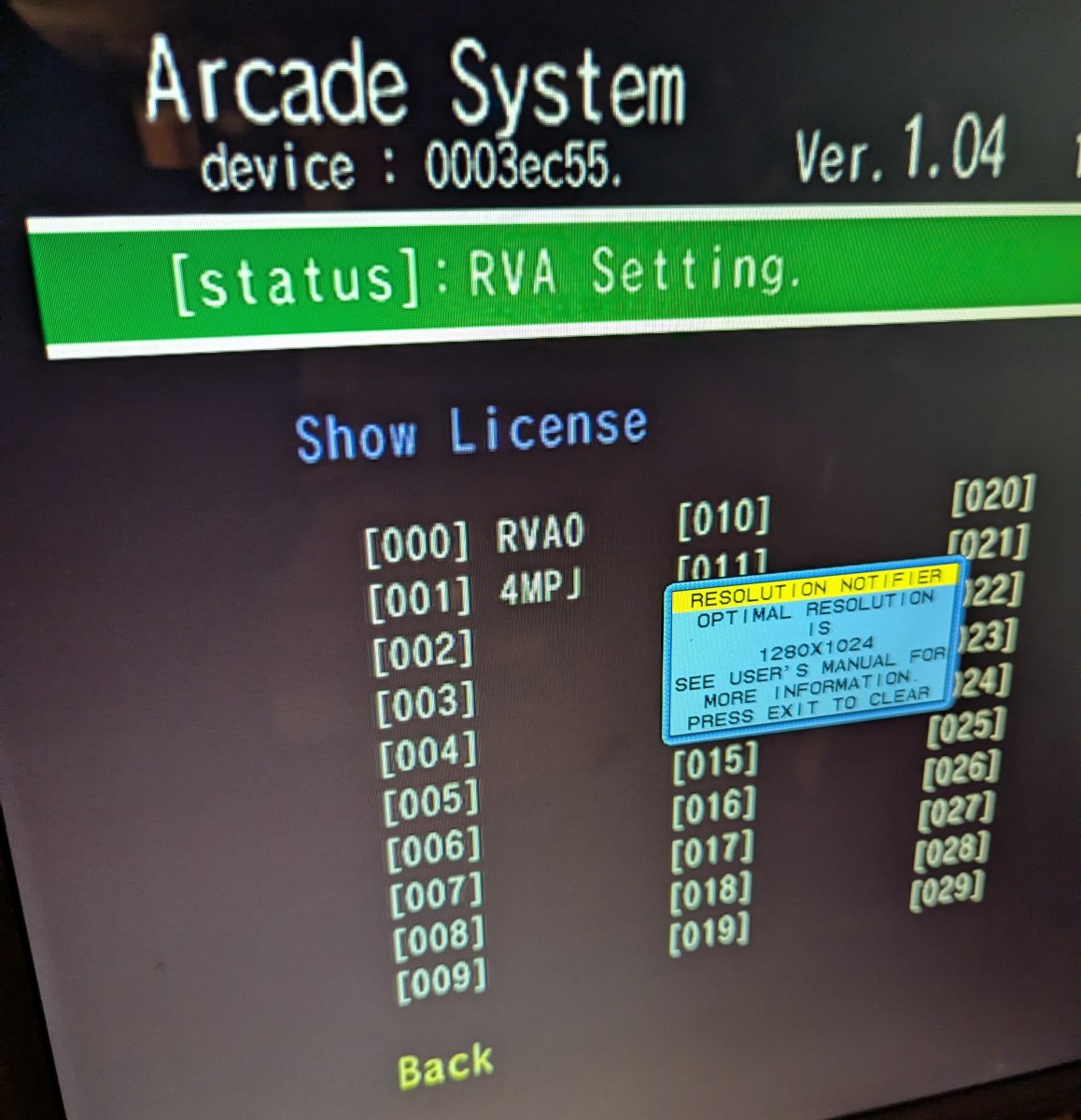

All you need is an SD Card to put TvC's wad onto and to press and hold both the SEL and SET buttons before powering it on, and it'll install TvC onto the system. I did this myself and it all works great!Does anyone have the links or resources for converting the medal games to TVC?

thanks so much, I have everything I need now! cheers buddyAll you need is an SD Card to put TvC's wad onto and to press and hold both the SEL and SET buttons before powering it on, and it'll install TvC onto the system. I did this myself and it all works great!
Although just in case, I ran the RVADumper beforehand to have a clean nand dump in case I needed it.
