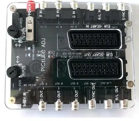

The H and V position actually slowly drifts over the course of 10-15 minutes while the unit warms up, I think this is the cause of the vertical jitter you see. It stabilizes after a while.
I have the older version of the CBOX the one with the SEGA Saturn ports and the sync jitter keeps occurring every circa every 20-30 minutes. .
My friend owns one of these for his consoles and it suffers from the exact same issue, it's probably this device that has been incorporated in the CBOX through later revisions.
