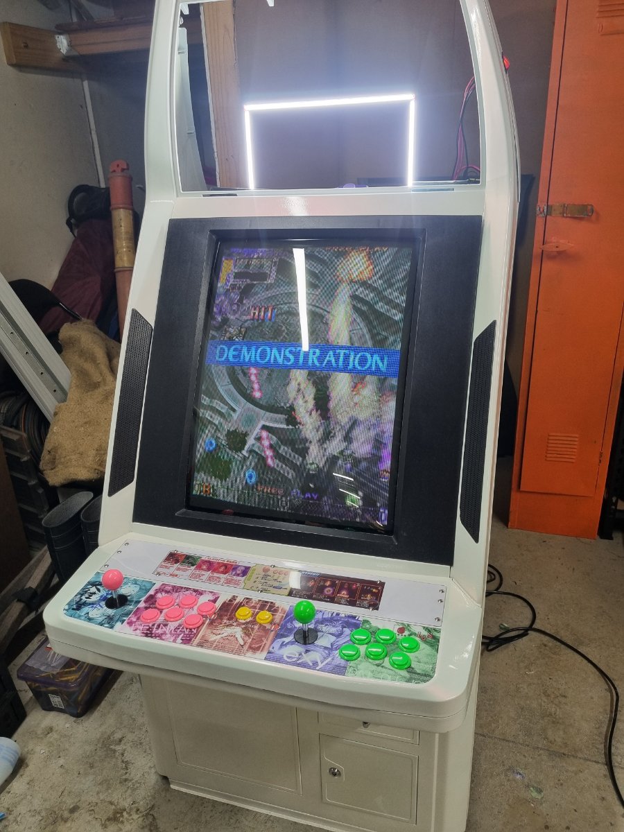

Sometimes cab restoration becomes a waiting game. While I was hoping to have this totally completed by this weekend when a pair of Exceleena cabs should arrive, I am still missing a few things I need before I can put the back on. I have ordered 2 speakers to replace the cheap tinny sounding crud that was originally fitted. These will likely need a 3d printed mount to fit to the original screw holes. I also need a marquee and I was going to try someone local because the shipping cost from the US seems way to high but I have tried calling once and emailing twice and get crickets. I'll probably just order from Game on Graphix again but I may change up my design a little first.
Was playing around with the monitor setup today and I'll need some convergence strips and/or magnets to get it 100% dialled in. The top is nice and crisp but the bottom could be a little sharper. I want to get the speakers in first as I could see their magnets changing things a little. It has however come a long way.

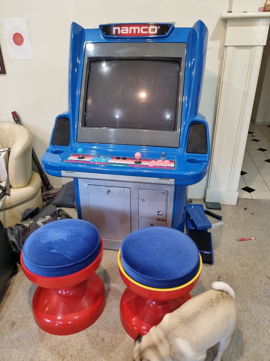

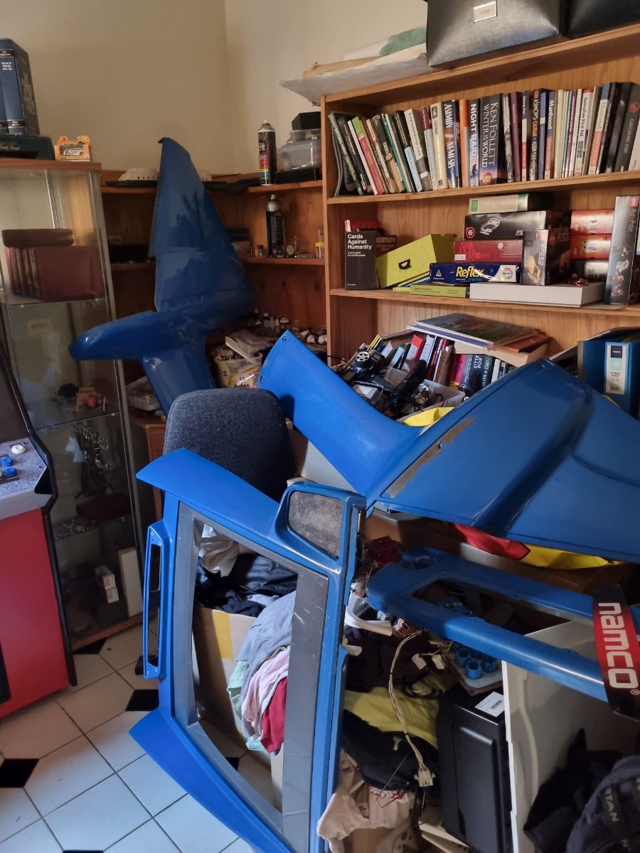

Not quite, but they would be if they were as big as the blasts boxes. The Chandy has the 1.5x3" speakers (try finding something that size) in a similar location but mounted on a flat plate that screws to mounts on the side of the cab next to the screen. Easier to access when the screen is TATE and the back off but still a little tricky. The boxes on the blast are a total pain
I was hoping to have this one done before these turned up, but I am still waiting on parts and a marquee to arrive. So for now my focus stays on the Chandy but I'll look at these Exceleenas soon. The complete one is pretty good, the other one is a bit of a project.

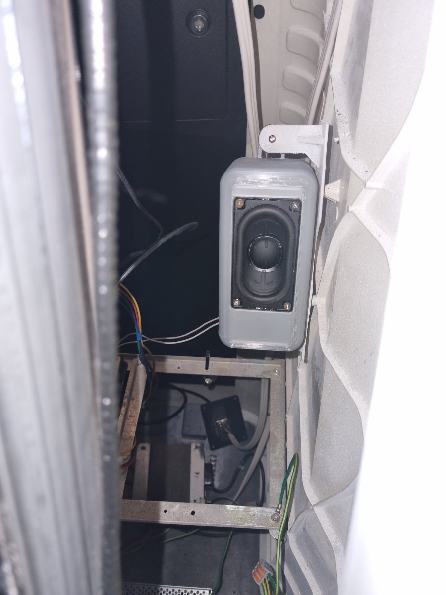

4.4 Sounding it Out.
Time for some sound. Drivers come from some JBL flip 5 Bluetooth speakers and since they run passive radiators I decided the chandy should too. Can find absolutely no data on these speakers which makes it hard to design a typical enclosure let alone one with passive radiators and to really play in hard mode I decided that I would 3d print the enclosure as well. I designed them to fit on the old mounts and when everything was back together they... sounded better than the original speakers from Uzbekistan but not as good as I had hoped. A little limited on the base. Not sure if I will try again, I think I need a slightly larger enclosure with thicker walls and a little more fill in them .
