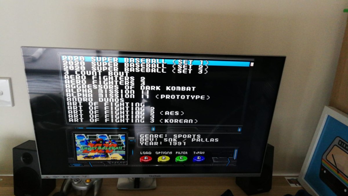

Well, it turned out that the issue was actually related to the NeoSD pro and not the PSU. Here's what I found on the FAQ section of the Neosd Pro manual:
"Q: I loaded my own game but the Neo Geo always boots to crosshatch screen and I can’t enter NeoSD PRO menu.
A: The game header or security code is not recognized by the Neo Geo bios and it doesn’t run the cart, so NeoSD PRO doesn’t even have a chance to boot. Place the MicroSD in your computer
and delete a file named LastGame.cfg. If that file doesn’t exist, NeoSD PRO will present itself as a genuine cart and the menu will load. Then ensure your game program ROM has the proper
Neo Geo game header. It might be a .zip to .neo conversion error."
The file is actually named LastGame.pro, all I had to do was delete it and the console was able to boot to the menu, no issues. I tried 3 games and all of them had the same behaviour, so for some reason the header is not being recognised at all. The solution for me was to delete the LastGame.pro file and set the NeoSD Pro to boot to the menu instead of the last game.
The console still needs some maintenance but I can confirm it has been running solid for a while.
Thanks a lot for your replies, hope this info can help someone else in the future.
