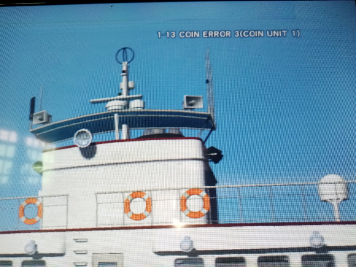

Has anyone caught up with the same problem in the namco 369 Tekken Tag 2 that has 1-13 coin error 3 ( coin unit 1 )

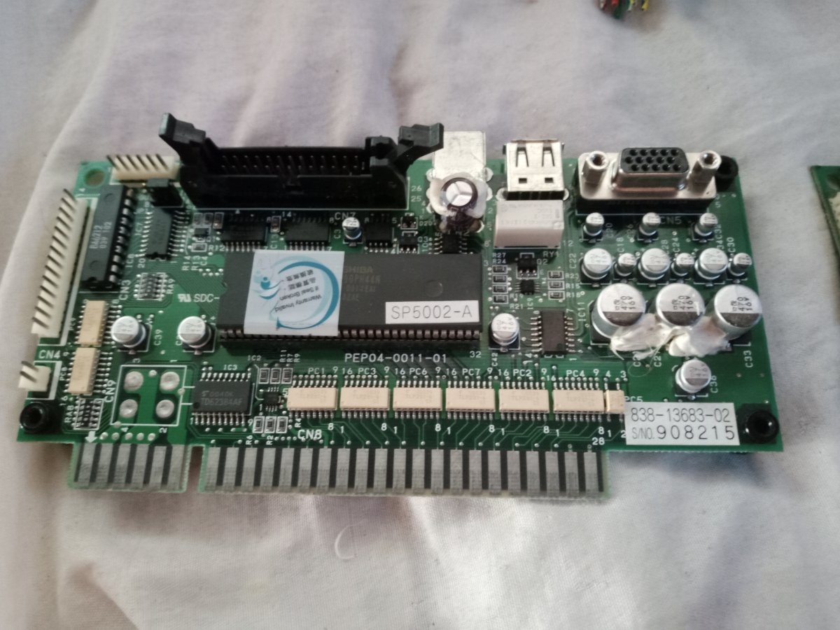

When I use the saga i/o rev b no error in the screen and the coin switch or credit is working
But when using the rev A i/o the coin error appears and you cannot flip credits
Any solution that can be help to make the SEGA REV A board to use without the coin error

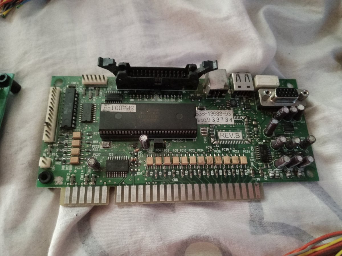

maybe it's not the board rev itself, but the function of those 2 bodge resistors lower-center of the board
the coin error happens because a coin meter/counter isn’t connected. Some JVS I/O boards have this issue. My Namco JVS had it. You can connect a coin counter and the error message will disappear or solder a zener diode across the coin counter wire and 12v to bypass the error. Extremely easy fix.
Pinout Franco please hehehe
2 resistors added to the rev B board in the foto,
try adding the same value resistors across the coin-counter contacts of the rev A
