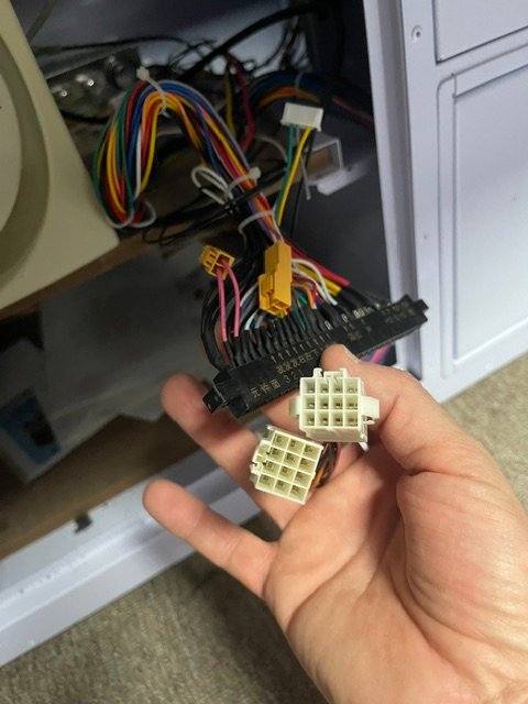

for your wiring, there are probably other options but since I know these amp universal connectors so much (and since I have them in stock), here's what I did:

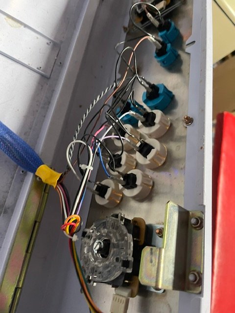

The jamma was connected to the buttons. I cut that out and place a female connector for player 1 and for player 2

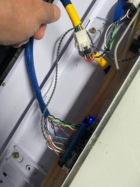

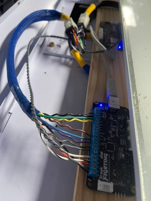

I mapped 2 brooks board to the same female connectors ( and a bit more (the greys) since there are 8 buttons on my control panel)
my joystick and buttons have the male connectors so I can choose to plug them either in the brooks or the jamma connector, shall I ever want to use it ( I have not since I have 7 jamma CRT cabs)
brooks boards output USB, to your PC of course.
