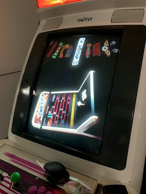

Behold!!! I present to you Attract Mode/MAME running on an Egret II MS9 monitor.
I have here a cheap MAME PC with a CRT Emu enabled Radeon HD7350 card. It is outputting a 15khz signal at 0.7vpp. But as you can see, JAMMAizer is amping the RGB levels nicely. Notice how high the whites are (contrast) and how dark the blacks are (brightness). Yet, you can still see the gradient detail in that psuedo-Viewlix image's left arm. You can also see the the wallpaper in the background. Some of you have heard me say, I feel the J-Pac's amp is outdated and produces an image that lacks contrast and that I feel the THS-seriers amps do a better job at amping 15khz RGB than the amp that Ultimarc uses. Here is proof.
JAMMAizer is going to work just fine for MAME-to-JAMMA cab application fellas.

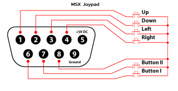

I see... Apart from that, it would be awesome to hook up the X68000 and play games with MIDI on stereo through VGA. It will be possible to create a RJ45 for the MSX port standard?
You could use the EZ PADHACK PCB and wire up a DB9 cable according to this pinout.
