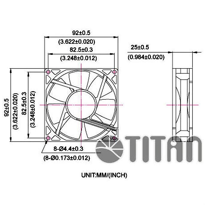

Thanks for your information.If you decide to go with a bigger pc case type fan, they all have pretty much the same standard measurements/dimensions to fit a pc case so you don’t have to worry about what fan the buyer needs to use.
For example, if you go with a 92mm fan, the measurement is almost always 92mm by 25mm, the screw/bolt pattern/measurement are always the same. So there is no need for an specific brand/model.
Here is a diagram/dimensions for a standard 92mm x 25mm case fan
So whoever buys a case can get whatever 92mm fan they want.
Alternatively, if you want you can make an adapter plate, for that want to mount the smaller/original fans.

In that case spec it for an 80mm case fan, will fit inside and there is more than enough choice.Thanks for your information.But the problem is my case is 9cm around. Bigger fan cannot fit in the metal CASEIf you decide to go with a bigger pc case type fan, they all have pretty much the same standard measurements/dimensions to fit a pc case so you don’t have to worry about what fan the buyer needs to use.
