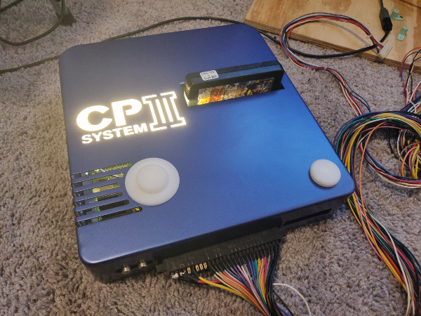

Finally got mine installed. I still need to hook up the LED lighting, which I'll do later when I can get a moment away from the holiday family stuff.
But here's how the red looks with my Third Strike cart. Ironman red ftw! :thumbsup:

Enjoy with it.
Ironman Red is really awesome.
I hope cps2 will be great like this :P .

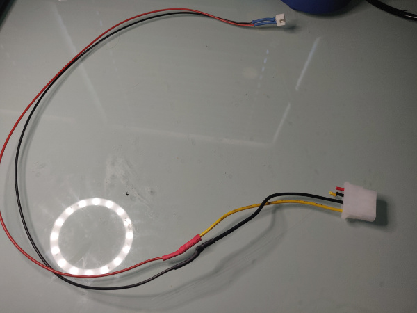

First I soldered a molex power connector to the other end of the power wires for the LED:
This way nothing has to be soldered onto the CPS3 board while assembling and it can plug right into the motherboard (since the SCSI2SD doesn't need power via molex and can run straight from SCSI cable alone).

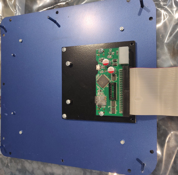

Next I moved the mounting board for the SCSI2SD towards the back of the case. This was required to work with my short SCSI cable which I've been using with my previous plexi setup.
It works fine and mounts perfectly with the older SCSI2SD revision! 8)

Thank you for posting these, as I too have a 5.0 SCSI2SD and a short cable so knowing this was possible makes me happy. I gotta say the clearance (or lack thereof) between the caps on the SCSI2SD and the solder on the SIMM slots makes me a little nervous though.

No problemo, yeah there isn't much clearance between the top of the capacitors on the SCSI2SD and the CPS3 motherboard but in my case it didn't seem to touch the legs/solder on any components (though just barely).

I still don't see how you can have a default SCSI cable all in there (15-18 inches). I folded mine quite a bit and even under the SCSI2SD mounting plate and I don't see how. Any tips on how?

You have to tight SCSI cable very much. I know there is not big enough space, but I tried with long and short cable. It must be ok.
Get yourself a shortie cable, homie. I barely have to fold mine up to make it disappear entirely inside the case (though it's short enough that I had to move the mounting plate a bit)
I managed to make the long cable fit inside the case. I slid and folded it more underneath that white plastic heatsink.
I was also mindful of the factory fix wires underneath the board. You wouldn't want to rip those if you cramp the SCSI cable the wrong way.
