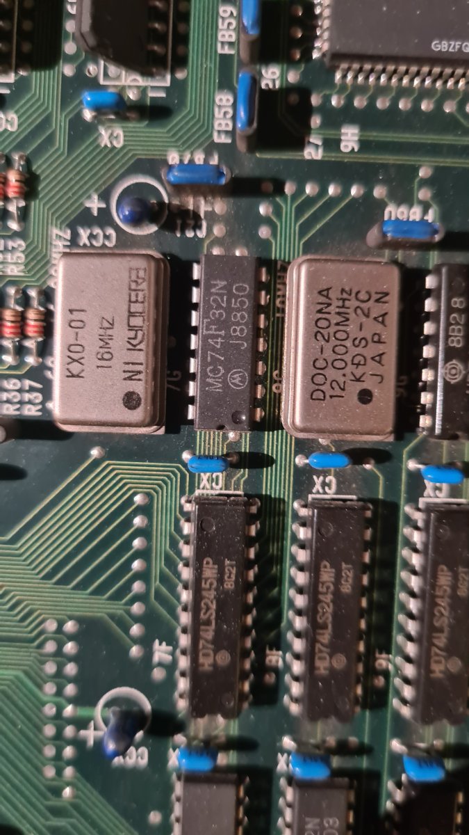

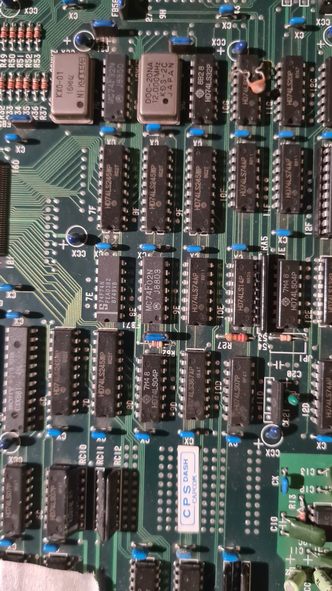

I got a box of old CPS1 stuff and found this one. Didn't know this was a thing,12Mhz long board:

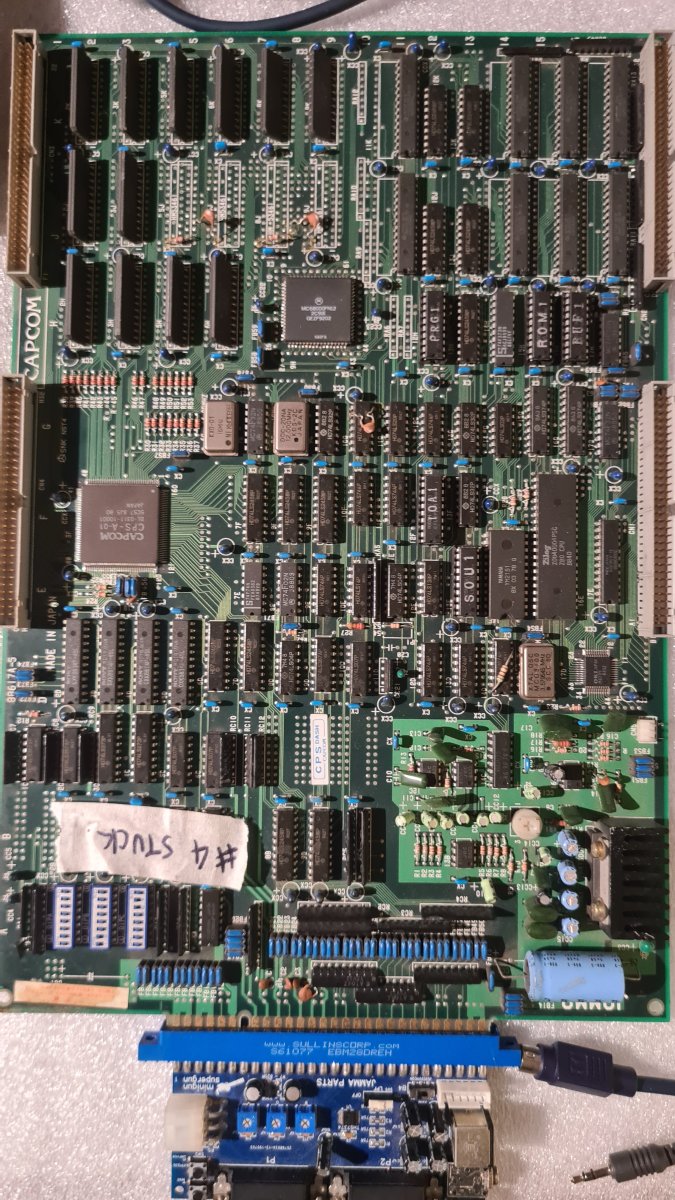

My CPS1 SFII Hyper Fighting only plays Sound and no Image. How would I go about Troubleshooting this? Any Tips would be Greatly appreciated.
There's a ton of threads around here on how to TS CPS1 issues. In a nutshell, you need another working a/b/c stack to troublehoot.
