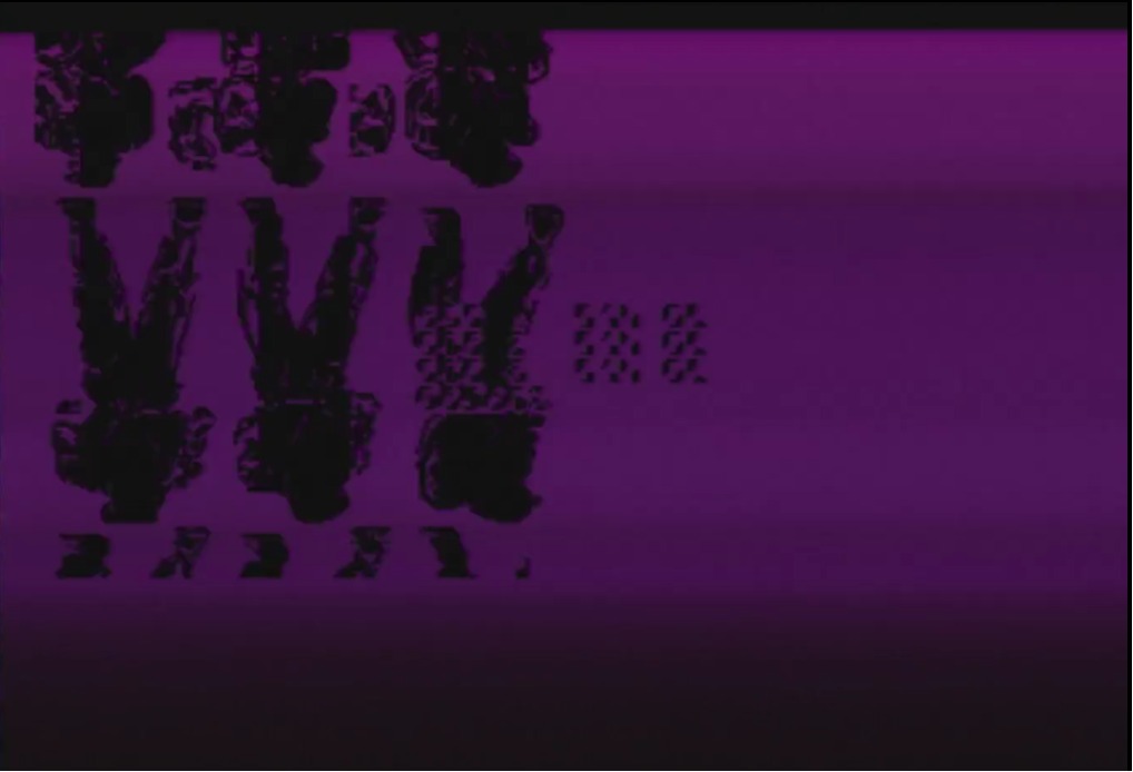

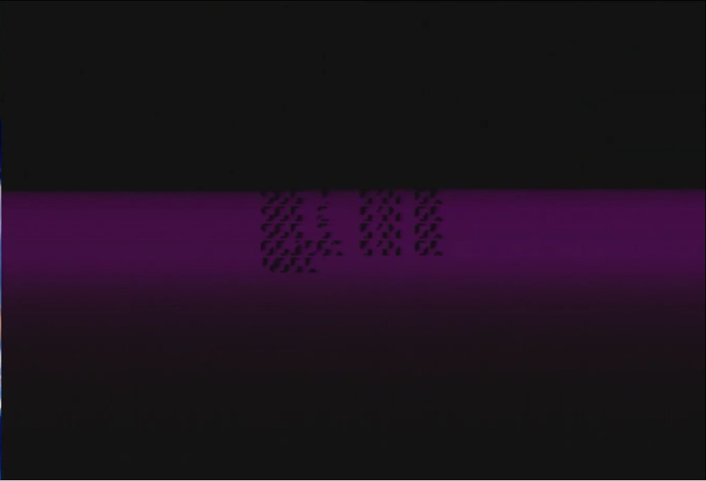

One thing I notice with regards to the A board revisions in SF2CE/HF is if you use the 10MHz board the startup rom checks are always garbled before completing and then show properly. On a dash board the text is always correct. That to me seems to be a good indicator of which board should mate with which however I don't have any other games to verify this theory.
Is this what you are talking about? My Hyper Fighting does this for the briefest of moments on boot up. You need to frame scrub to even catch it. Tested on a couple of boards that have 12Mhz A boards and it seems to be normal.

I've got some input that may or may not be useful, that ties in with talk of relocating the crystal and with the above images.
I found some cables that allow separation of the A and B board, so I can more easily work on troubleshooting a no audio issue on a 10mhz A board. The cables are about 2 feet in legth. I've checked continuity on every single pin of the 4 connectors and all are good. Powering the board gets stuck at the screen on the left, with the upside down character sprites (no text).

Same board, swap in CE ROMs and it boots perfectly.
I don't think this garbled text denotes an incorrect A board if this is what @sammargh is referring to. Seems to be something Hyper Fighting does maybe. I haven't been able to capture those images on my CRT either, only through a video capture card.
