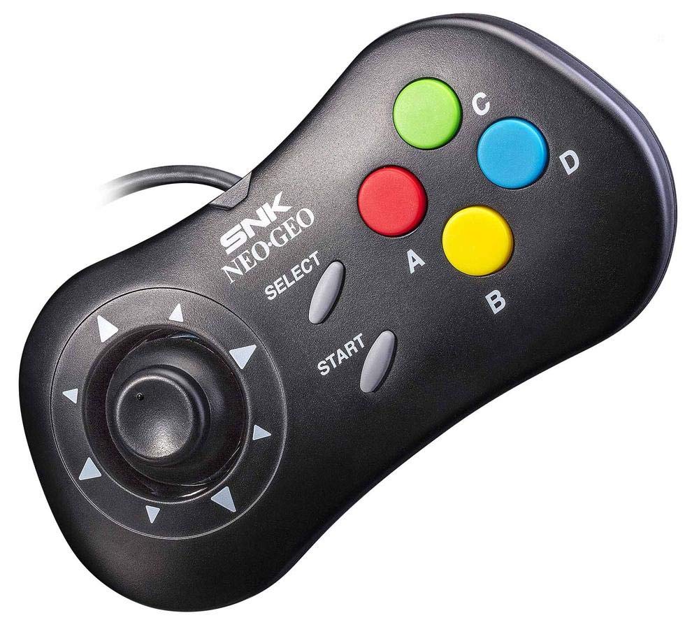

Hi @Mitsurugi-w - this adapter should work for the 3rd player for Cadillacs and Dinosaurs - right? When I go into the test menu, with my NeoGeo bad plugged in, the directions work, but button 1 and 2 do not light up at all regarldess of the button I press on the controller (A-D).

Maybe a stupid question, but did you install the kick harness from the filter to the multi?
Not a stupid question - I did install it...
I also tried a HAS db15 to Jamma adapter - and it worked, with my saturn controller.
Maybe the neogeo pad isn't supported? Not sure if it needs power.
Matt
So it works with ubdamned decoder but not with a Neo stick? That's weird. It was designed with Neo sticks in mind. Should work fine if the undamned adapter is working.
For me, it worked with the NeoGeo stick and C&D so that we could play 3player. I also had an extension cable connected fot the stick.
I dunno. I didnt test with that controller. I don't think neo consoles put 5v on the controller ports tho.
