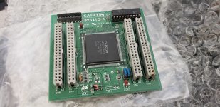

I should already know this, but one of the C boards I received is registering .29 volts instead of the 3.12 I get with my others(full battery). I have some new replacement batteries to replace with, but can/how do I do this w/o losing the factory C board function?
You can't. If it's registering .29v I'm surprised it isn't already suicided. You need to replace the battery and flash keys using an Arduino or if you're using it for the multi just remove the battery because you don't need it anyway.
Thanks- for some reason, I was thinking about way back when that you could take a battery, solder two leads to it,then to the C board, then change out the battery and then unsolder the two leads thus replacing the battery w/o loosing power.

Mine arrived just as I was reading this, thanks @drfunk2k!
