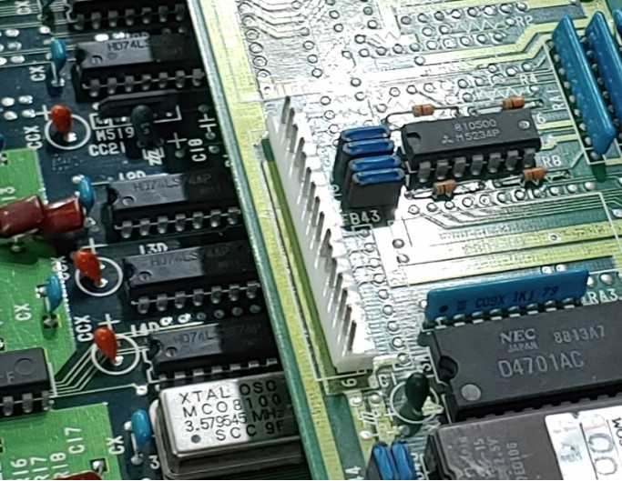

Hi. I have a question of first unit.
I wish I could use Capcom Rolling switch(capcom spinner) to play Forgotten Worlds.
Genuine Forgetten Worlds pcb has 16pin on B-board and connect Capcom spinner here.
but I can't find where to connect Capcom spinner on CPS 1 multi board.
I found 2 x 10 pins near C-board socket, and I think it would be used for SF2 Kick or 3p players, right?
or these pins are for Capcom spinner, too?
Where can I connect Capcom spinner on CPS 1 multi? :)

There will be a sub-board that attaches here
