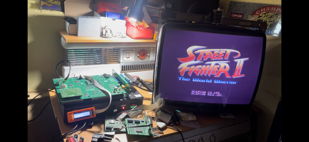

Hello guy’s I just wanted to make a post to this support thread, I finally gather all necessary pieces to put this kit together ran into some issues setting things up and all answers wore here, here a picture running with no issues since I can’t post videos thank you guys for the support
