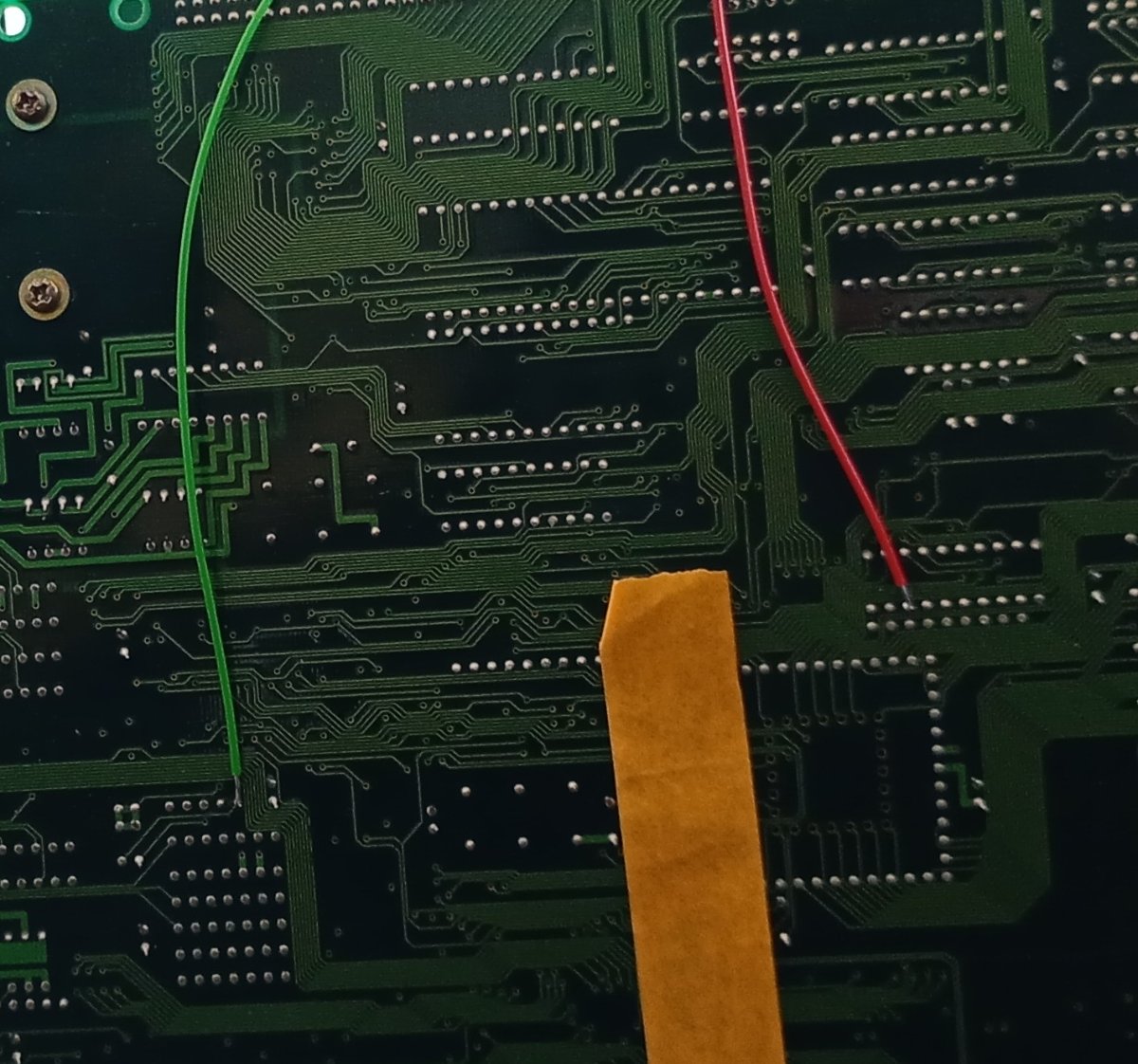

I don't have a multimeter, I do still have the original wires though, the guy who soldered em missed em somehow haha
Gonna nip to him today and see if I can't get them done right this time, sorry again for all the bother, fingers crossed this fixes things
I am not sure it will fix your RAM ERR, but either way, it's certainly worth doing -- clean up that whole area with isoproyl and just plug the wires in as per the manual making sure they follow the right points soldered underneath the board!
Ok got the wires in, far as I know they're setup correctly. Sadly that didn't seem to work
I'm seriously stumped

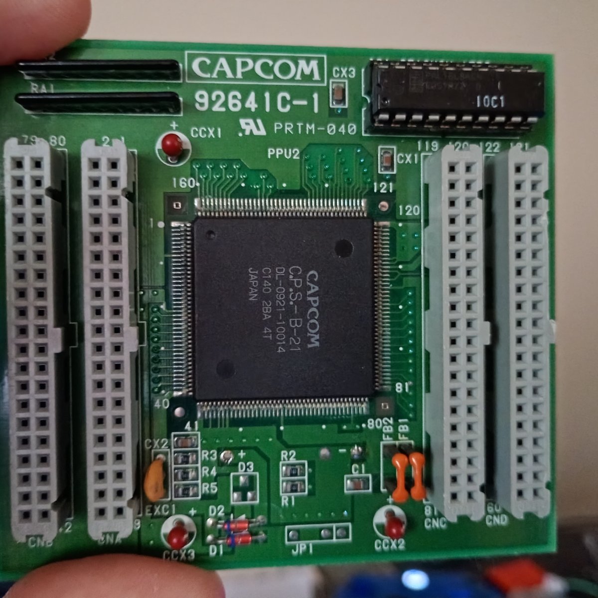

Please post pictures of the C board. Are you confident that they dont have any default hack made?
Do you mean 92641C-1 ?
It looks like your A boards IMO are OK.
That C board looks good. I think that you need to revert your CPS1 setup to roms again to make 100% sure that this A board and C board work well. If they do, then we can focus on the multi. If it's the PAL, I can help you getting a GAL programmed.

So tested the other C Board again, and sadly it seems that for one reason or another, the C Board is the thing causing the problem. It must've gotten damaged when I flicked it on or something
This tallies up with my findings. The vertical jailbars are caused by the C board. Swapping to a working board clears the jailbars. Applies to CPS1 and CPS1.5 games.
