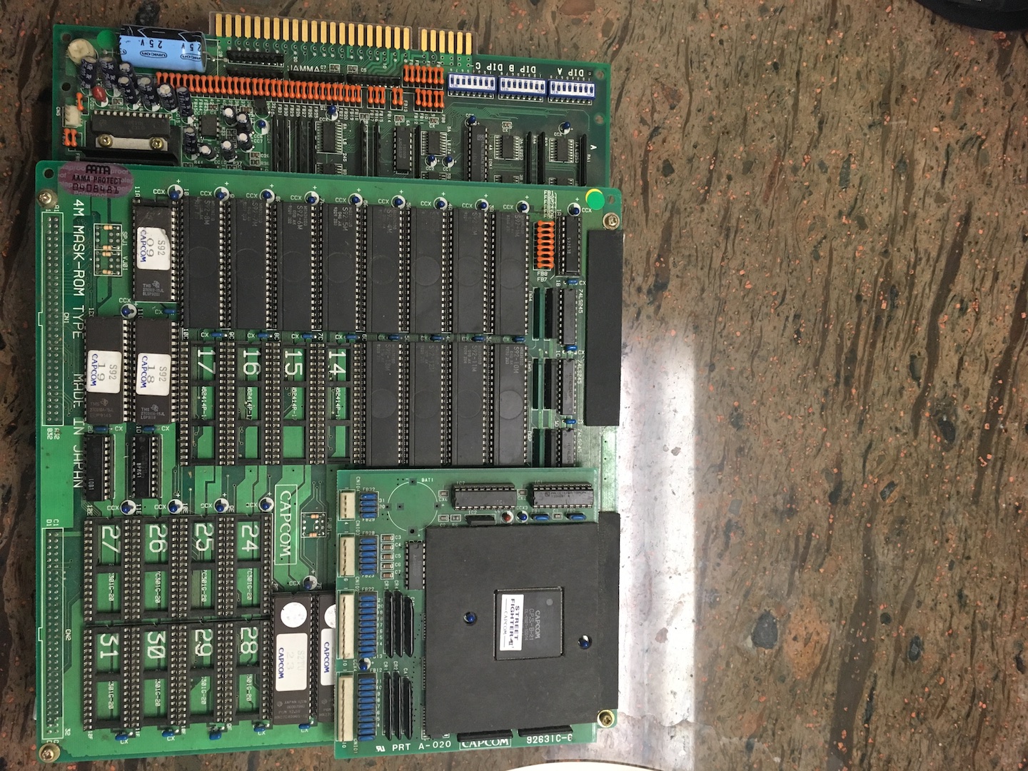

So I got a question for you guys. Bought a SF2 CE board off ebay, is legitimate and has mask roms and works fine. It boots up however as "Street Fighter 2' 920313 TAIWAN" and on the title screen at the bottom it says "(C) CAPCOM CO., LTD. 1992,92 DISTRIBUTED BY HUNG HSI ENTERPRISE IN TAIWAN"
I'm aware Hung Hsi are the makers of Rainbow edition and that there wasn't a Taiwan region for SF2 however it matches the World code for SF2 CE. I could pull my eprom burner out to read the program roms but I was just curious if anyone has seen this before. From what I can tell though this isn't Rainbow Edition because all of the hilarious tricks are missing.
Edit: some pics I mean this is the strangest bootleg I've ever seen

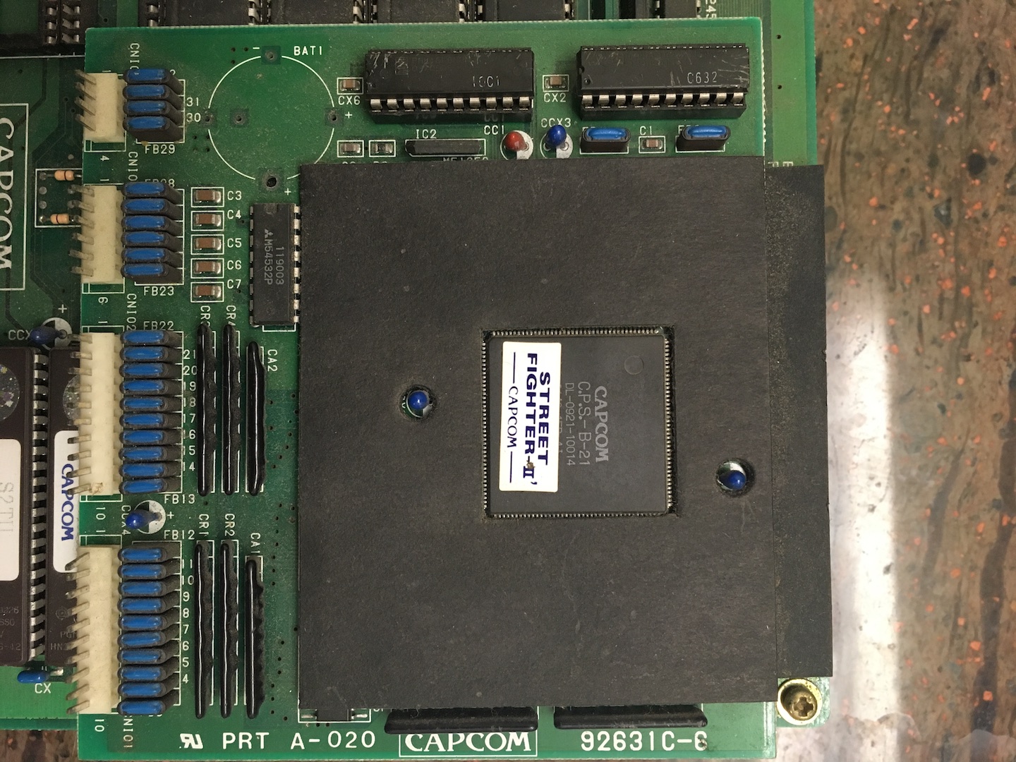

what kind of A board do I have here?
Now that I have my cps2 multi up and going, I am considering maybe trying to trade this for something kind of different from it's catalog.

Looks like a SF2CE with SF2HF upgrade roms.

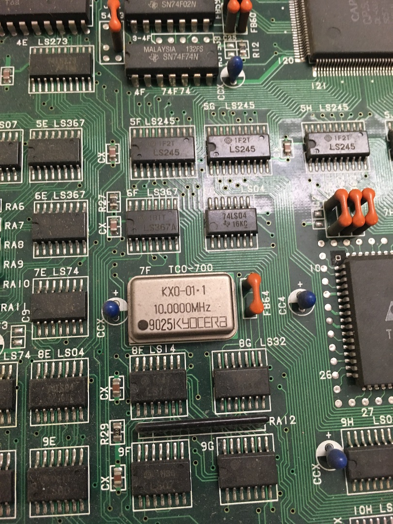

The A board lacks the ‘dash’ sticker, so might as well be 10MHz.
Better split the boards and look at the crystal
After wrestling the screws off and the boards apart.
You are right, it is HF with a tenner A board. I got a mismatch.

try and upgrade the crystal, is this hard, a big honkin surface mount seems touch, and where does one get a 12 crystal? I
I know it's surrounded by surface mount stuff, but the oscillator is thru-hole. I don't have my calipers handy but I bet one of these is a match: digikey. If you have a desoldering iron, it's probably just cleaning out 4 legs, pretty easy.
I'm not 100% sure just swapping the chip will just 'make it a dash', I've never done the swap or a comparison. But if it were me I'd probably just buy a true dash board separately, maybe and keep both around for the (hopefully) eventual multi. These A's seem to fail a lot, so it's nice to have a backup! Also having one of each means not having to put this one under the iron, even for something easy like swapping this out.
Not sure if it was this thread or another one on CPS1 multi potentional, but it was pointed out multiple times the only difference is the crystal.
Indeed.
Also in case you need to know the correct type to order (since there are a lot of different packages for crystals) the package type is DIP-14
