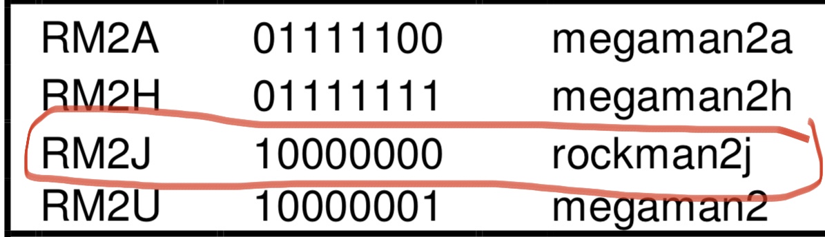

I’m probably going to go with the Infinikey. It’s better for the board, I’m not messing with it and I’ll never have to worry about a battery leaking. Which is my biggest fear. I just need to buy one and figure out the correct codes for a Rockman 2.

Pretty sure I’ll be using this code. Right?
