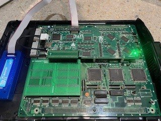

Hey mate, crazy you been sitting on that kit for over 4 yearsKit was purchased new from candycabclub the Australian distributor in November 2021. Only got around to fitting it now as I've been searching for compatible A and B boards.
I have projects like that too…Yeah, been in contact with him, will be sending it todayLooks like @djsheep has no more extra PCBs, can you please send yours to him and he'll send back fixed?

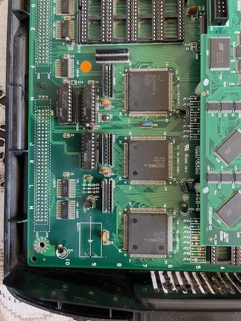

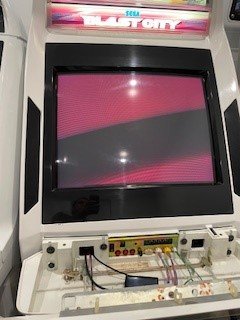

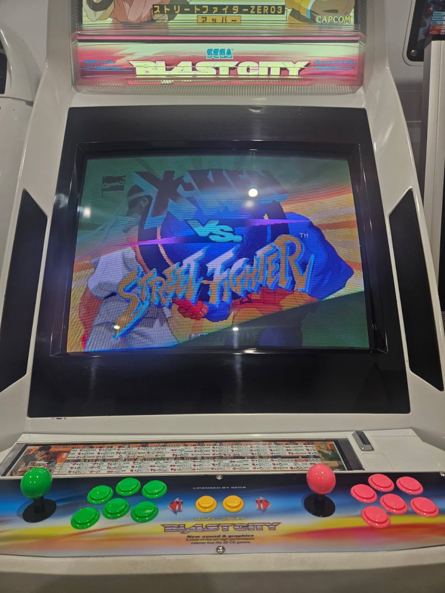

Thanks! It doesnt do anything, noone of the buttons respond. It has nothing to do with the multi or with the B board right?Common issue with CPS-2, not related to the multi, and thankfully a relatively easy fix.
You can reset the motherboards sounds settings / volume parameters by holding volume down and powering up the game. Let go once the game starts and adjust volume as per normal.
If that doesn’t work you probably need to change out the Supercap on your motherboard.
If either of those things don’t work, we can deep dive further, but I’m pretty certain one of those two things will fix your issue.
