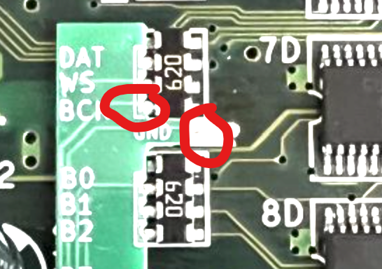

I'm going to ask some dumb questions but they may help.
I used some EXTREMELY short wires to connect WS and DAT to the pads right below (see pic). What are you using to connect these?
What wire are you using for BCK? You MUST use the a shielded coaxial cable like the one I originally provided. Make sure the GND wire is actually grounded (test with a multimeter) You CAN cut it shorter as well OR solder it directly to the pads on the bottom board if you wish (I didn't need to do that but I am just putting some ideas out there).

Ok - so originally, I used the shielded coax that came with the kit, and wired that up to the DigiAV board. I used two small loops (< 10mm) of kynar wire to connect the WS and DAT from the daughterboard to the main DigiAV board. That was on the initial install - as I said, everything worked great upon bootup, just no sound out the HDMI (but Jamma is ok).
I then wired up WS and DAT directly from the motherboard to the spots on the DigiAV (bypassing the daughterboard just in case) - and that didn't do anything different. Then I wired up a piece of coax for BCK - direct from the motherboard to the DigiAV - again, no difference at all.
Then I went ahead and re-programmed the DigiAV board with the CPS3 program to make sure - although it came from VGP as CPS3.
So - after all of that, still no audio. And I did have good continuity from the motherboard all way up to the DigiAV board pads.
I am a little stumped at this point - unless the DigiAV is just bad, or one of the audio components on it.
And last but not least - I am running it through my tink4k - but you bring up a good point, let me try running it directly into my TV.
Matt
