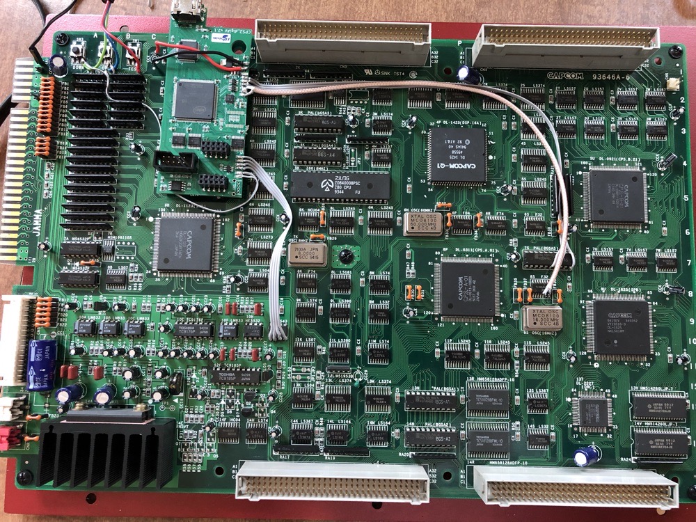

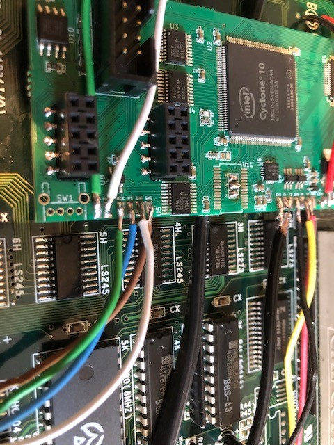

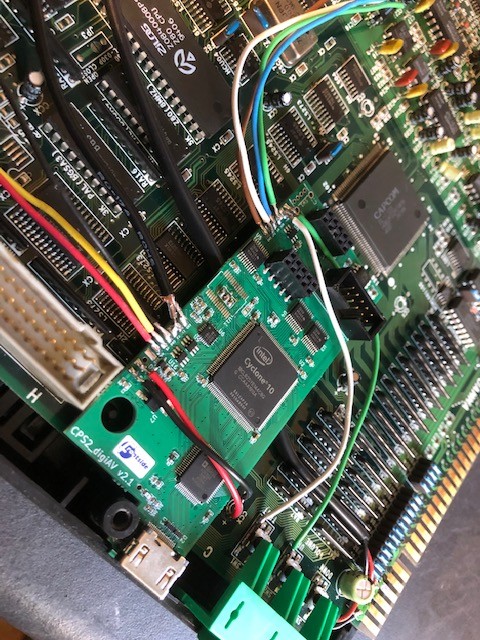

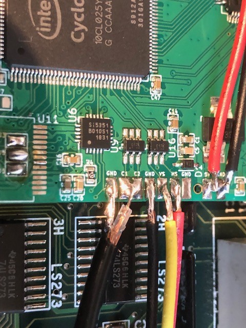

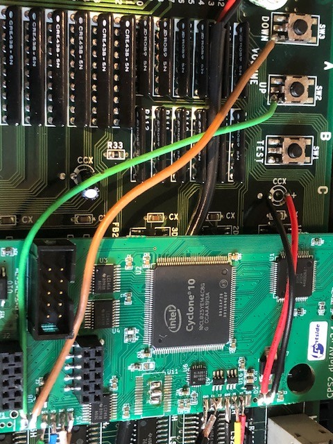

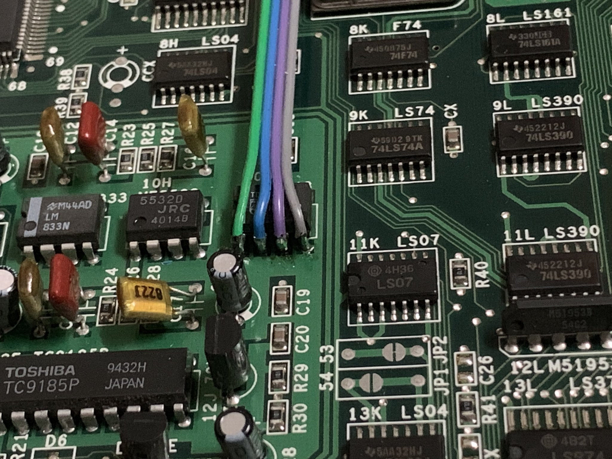

Hi I’ve just ordered my digi AV kit and I consolize a lot of cps2 boards but following the install instructions I was wondering if anyone could shed some light with a pic of SMD jumpers J3, J5 and J6 on the top side of CPS2 Digital AV PCB, as these are suppose to be bridged and I can’t find a picture anywhere on what they look like or what they look like when they are bridged. Any help would be appreciated.
Yes bridge them. They are super tiny and it took me forever to find the labels for them.
Thank you is there anyway you could show me via a picture so I have A better idea thank you.

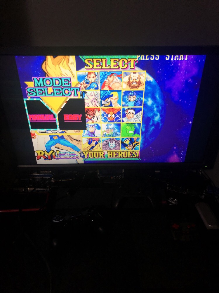

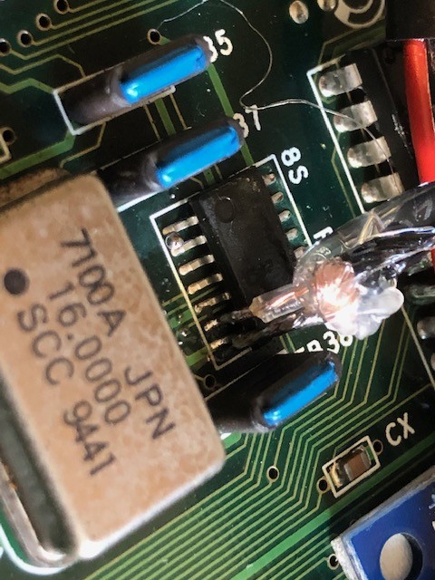

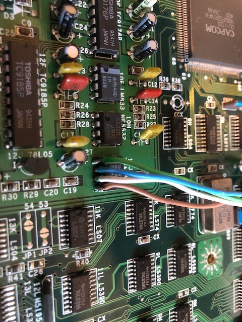

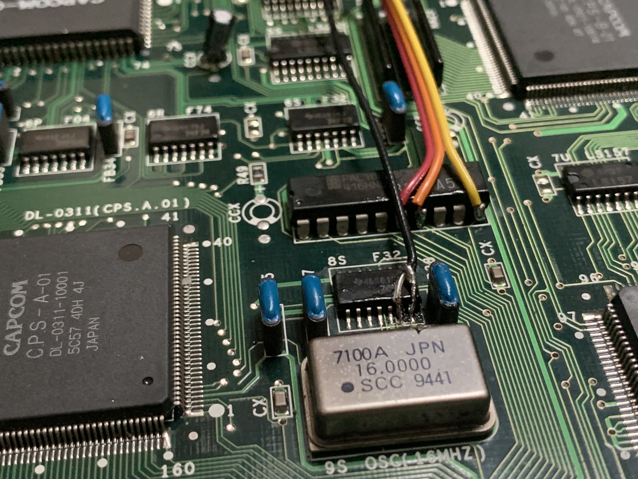

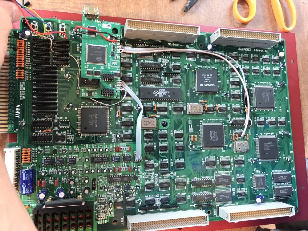

so i did the installation and got a picture but no sound. Any guidance as to what to check?
And i feel like the picture should be better.

In reference to these A board jumpers for us noobs what are we looking for bridging etc thank you.

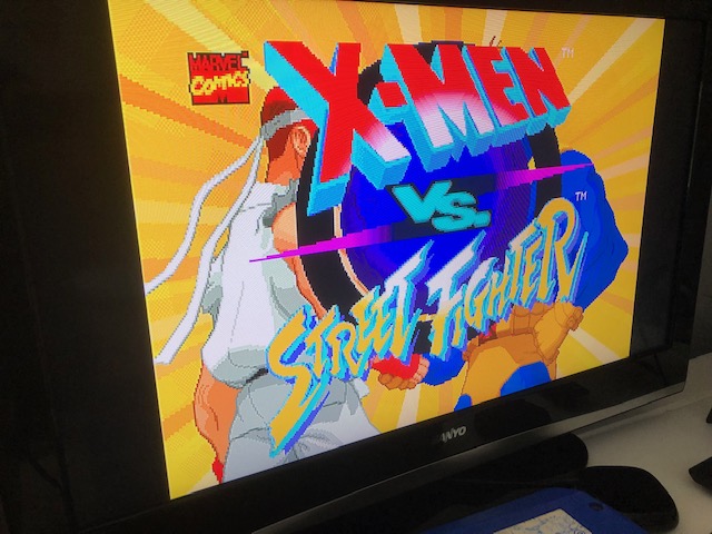

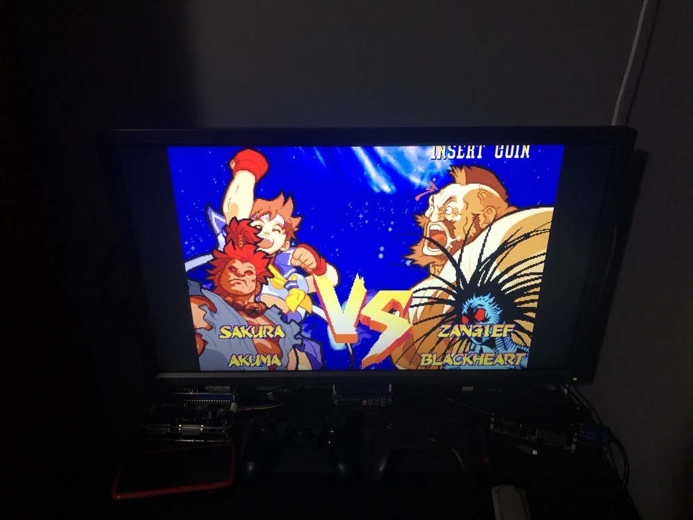

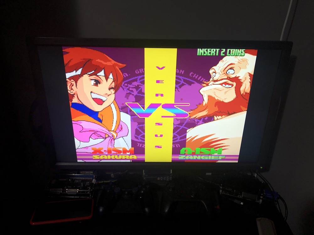

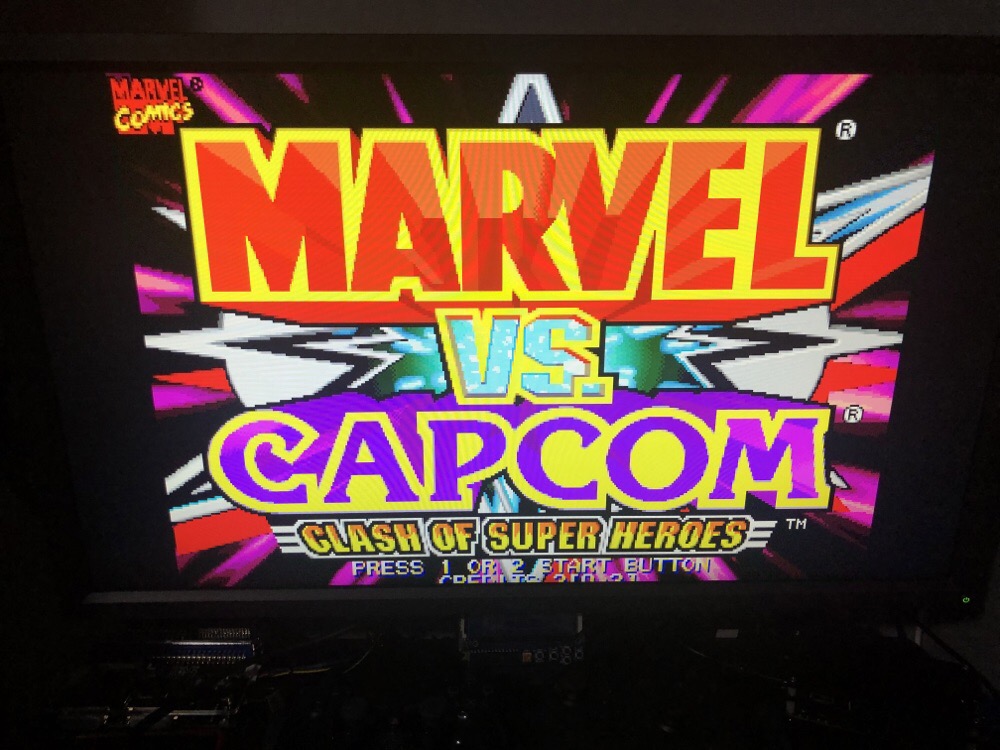

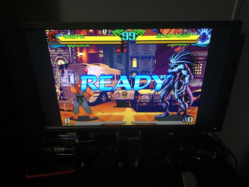

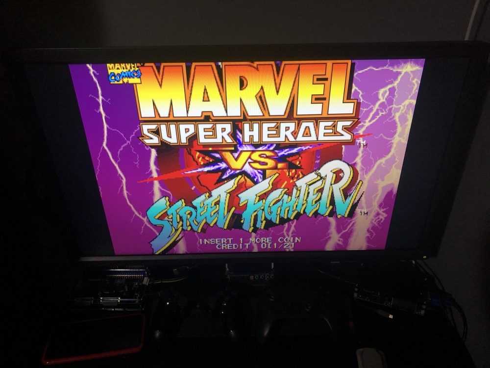

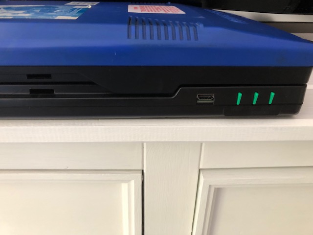

Got mine this morning 3 hours later console mod and HDMI kit fitted. I must say very easy awesome it of kit, not a massive fan of these scan lines a little to dark prefer ossc lines but sound and image are flawless

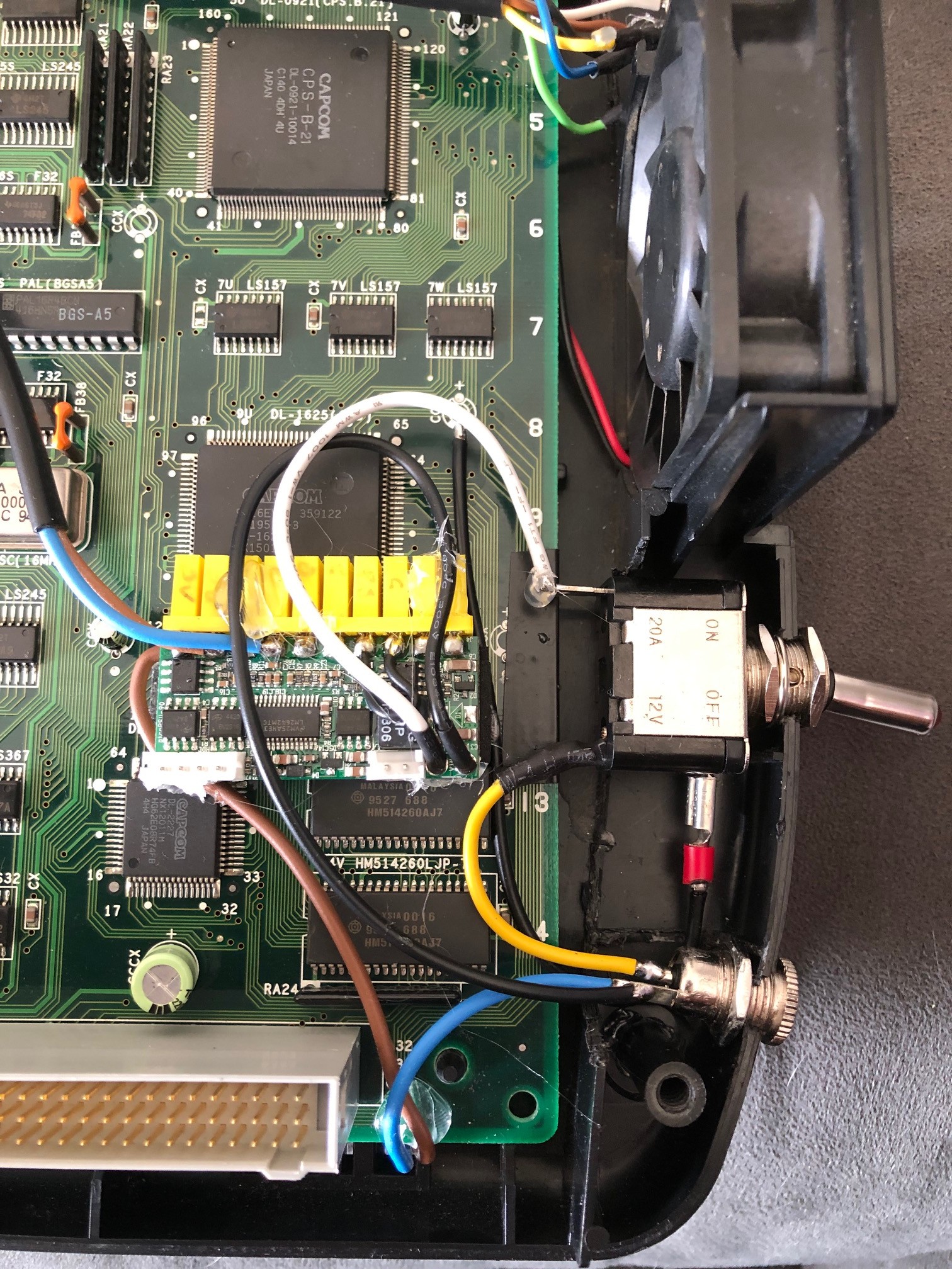

Hi bud you don’t need a pico power supply that is OTT, but you can use one if you want I have done a couple and realised for the money you spend on the pico you can do with other cheaper hardware items like step down convertors. But I have picture of one in a mod if you want it.
They are a standard atx connector get a picture from google and you can see the 12v and 5v on the pic and just solder on to the points on the pcb very easy mate.

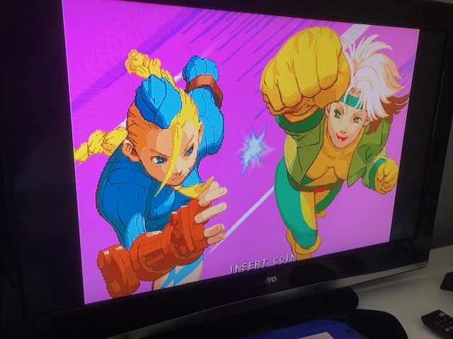

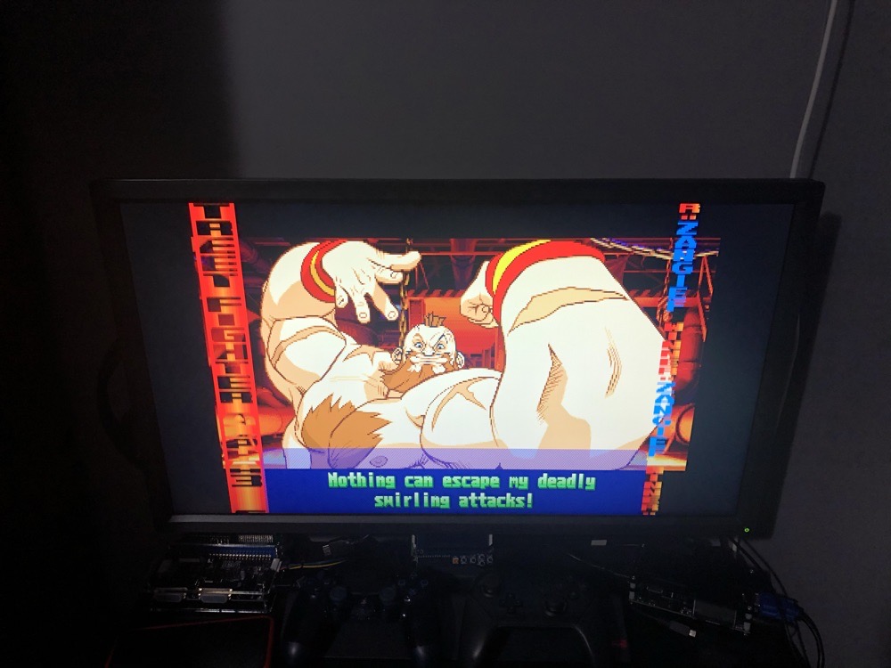

Finally!, thanks to @jassin000 for helping me out! As always :thumbup: Video looks amazing. :rolleyes:
Question though: does this mod not support audio from the HDMI? Only way i got audio was from the RCA cable. I don’t think we missed any steps.
