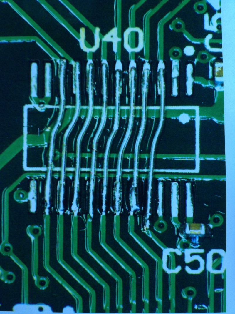

We tried to first solder (with hot air as described) the print, but it's pretty difficult even with profesionell equipment. So my friend at work soldered it with wires. I would say: "soldered like a boss" ^^ . Looks absolutly incredible if you consider how small it is. And yes it works :D
Nice skills there! Where is your friend based and how much he'd charge for fixing one?
