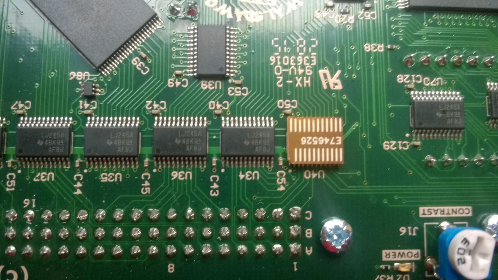

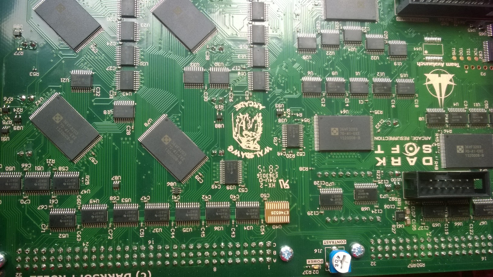

Below pics of the new PCB. I'll ask mitsu to shoot a vide and let's anyone decide which option they prefer.
All the kits ordered will be shipped this week. And ALL will come with the crackling fix installed. See below.
I'll ask mitsu to shoot a video and let's anyone decide which option they prefer.
As soon as I receive them I will do this. Probably two weeks or so. Then I will be open for repairs if you decide to have me do them.
It's cool that there's finally a solution, but how hard is it to install the PCB? Doesn't look like a solder free solution.
It's not solder-free, and the solder points are small. it requires ability and probably special equipment. check this thread for more info.
