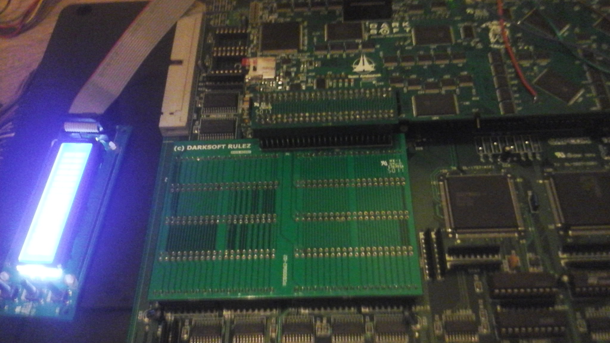

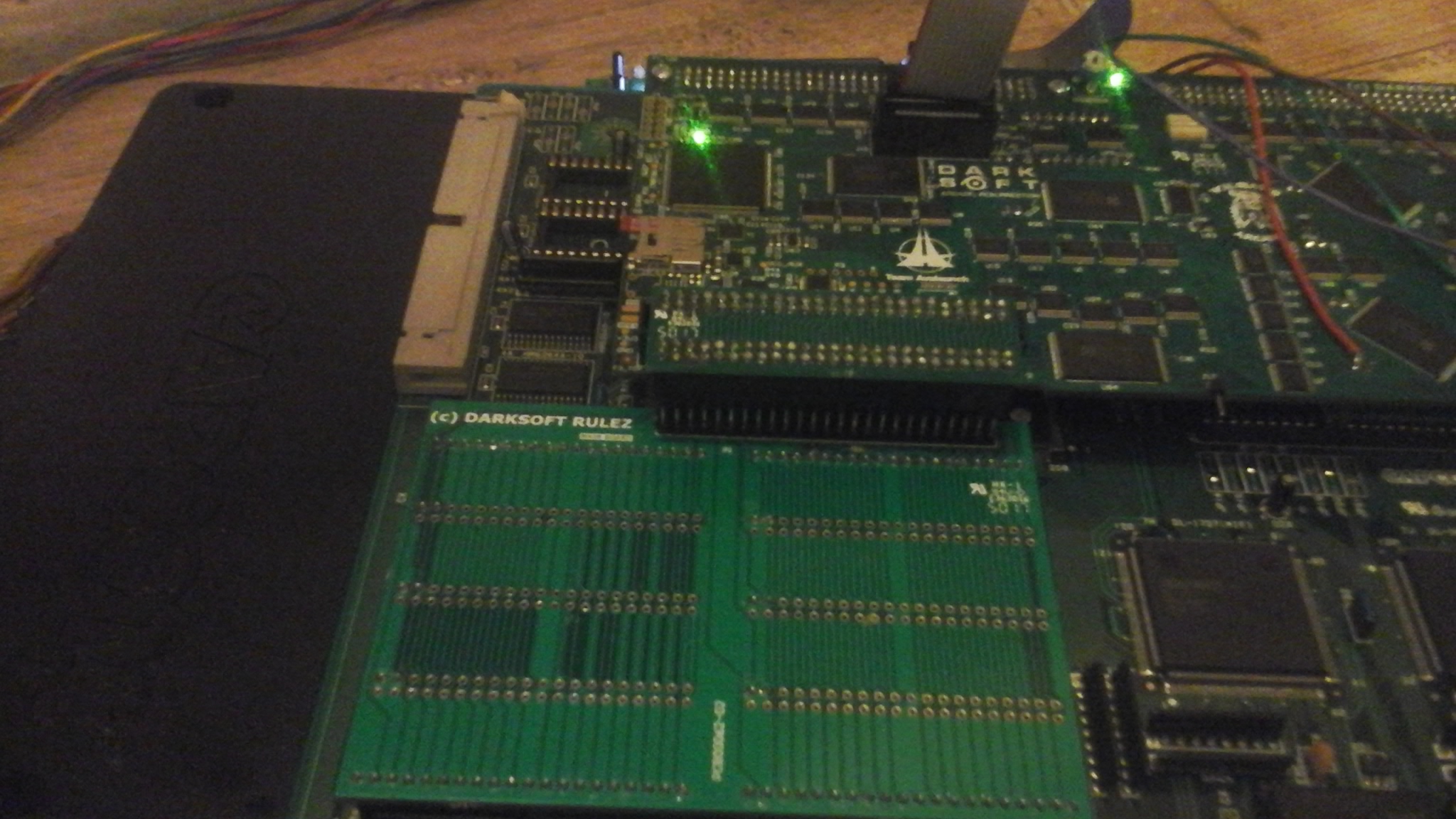

Can you post a picture or two of your CPS2 with the kit installed?? Did you install the 4 wires for key rewriting? Which romset are you using the one that includes original untouched romsets or the one from team avalaunch?
I use the avalaunch pack and i don't install the 4 wires for key rewriting.
I will post pictures of the kit in few minut.

as I said at the beginning of the post, there are 4 pins broken on the long PCB, I directly soldered wires to make contact.

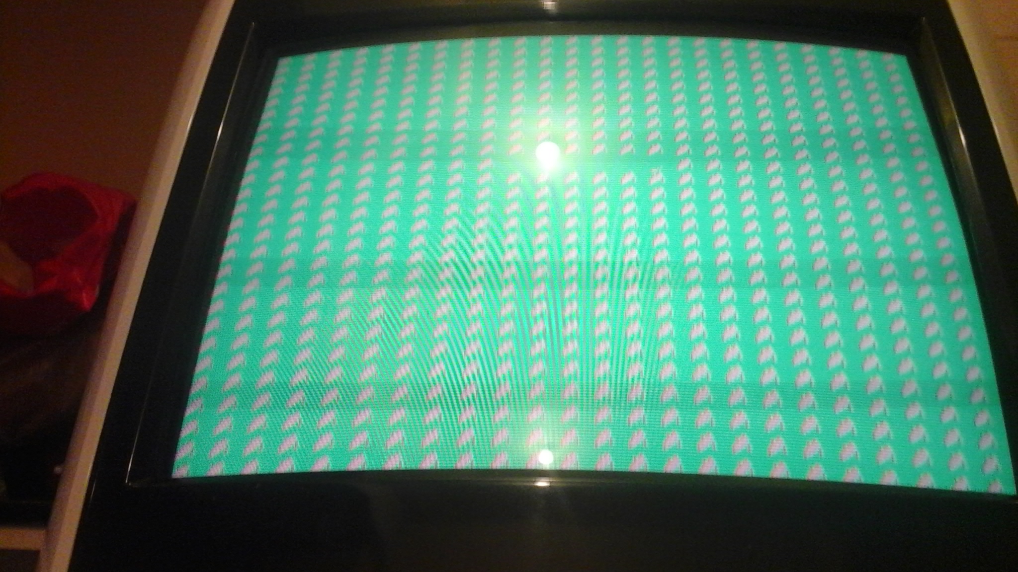

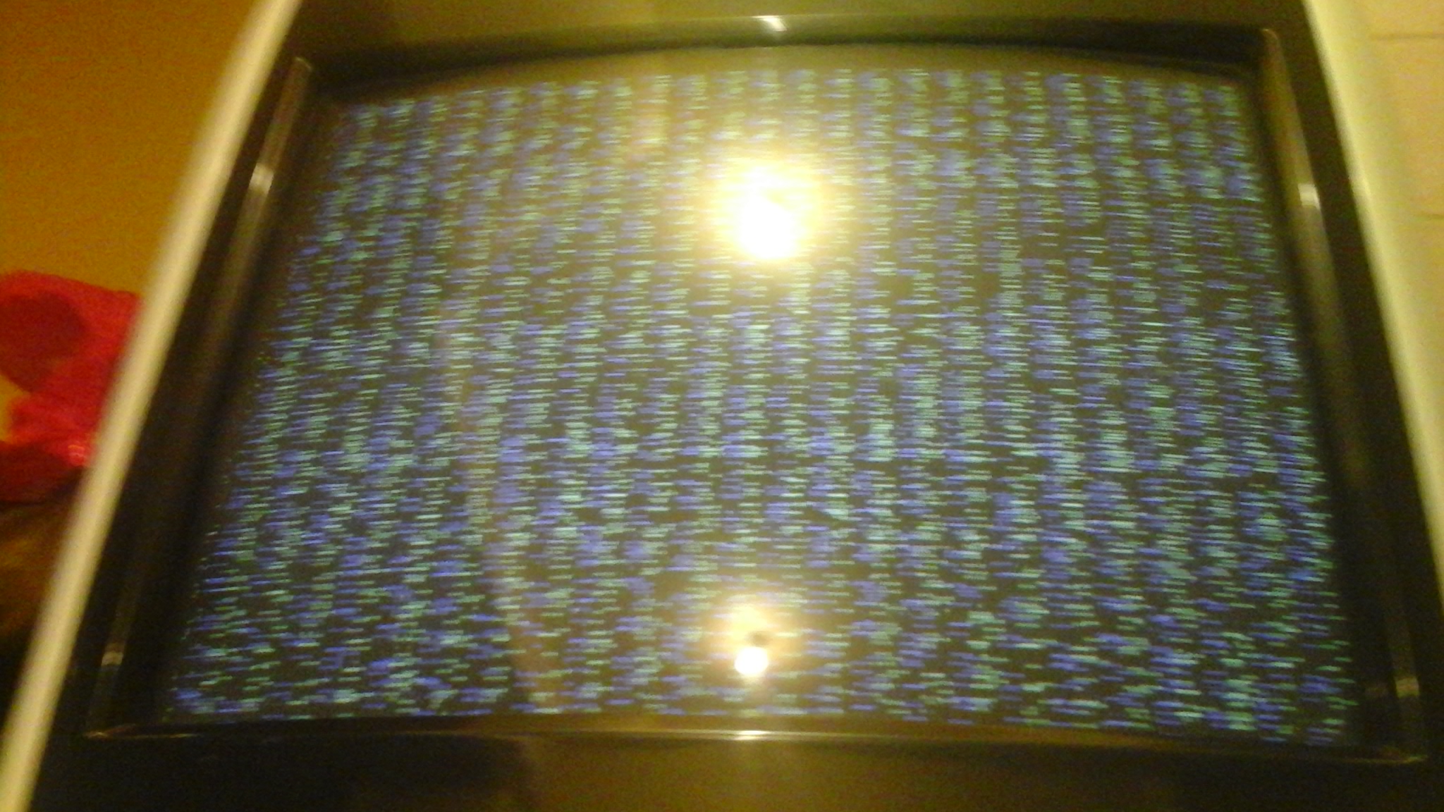

And some pictures of screens when I restart the new astro city.

Looking at the recent pictures he is not getting a blank screen, it is scrambled. This leads me to a wrong jumper or bad PAL.
Did you buy the PAL with your kit? If so we have already gotten reports o blank chips being shipped.
