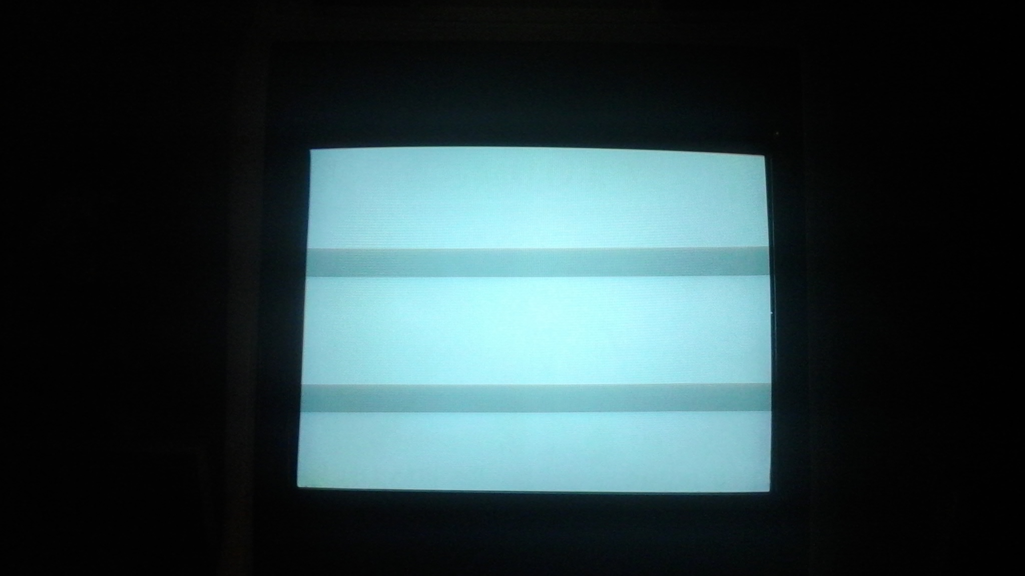

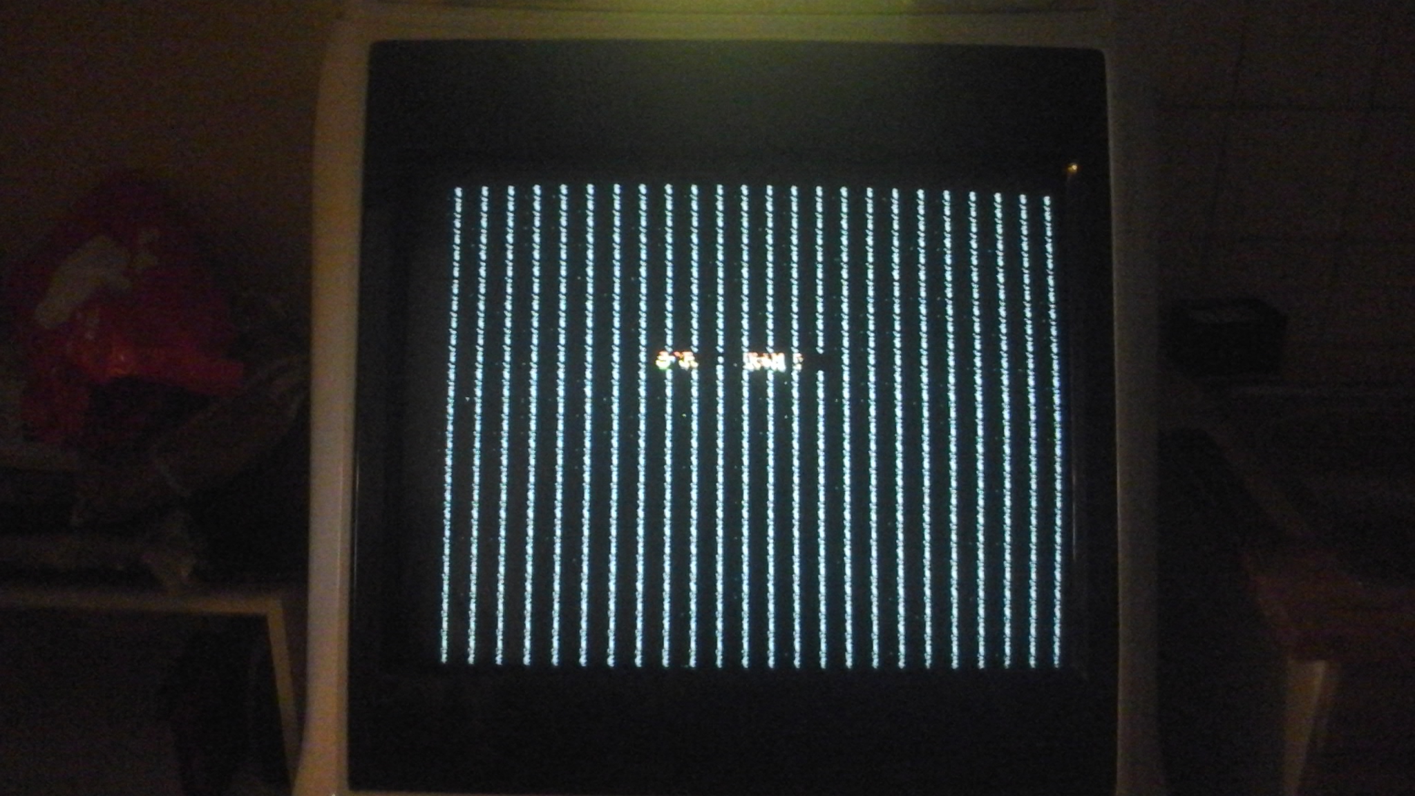

So at the launch of a rom now I have a 1st screen telling me
error ram then after a few seconds a white screen appears and the coin counter works once. photos of screen.
without PALG I just have a black screen.
My SD card is a 16GB sandisk bought today. I ordered a 4GB, from what I read the compatibility of SD can be problematic.

More information,
depending on the game launched, I have a different screen
green screen or blank screen with inscriptions that I can not read.
and the coin counter that deliriums.
