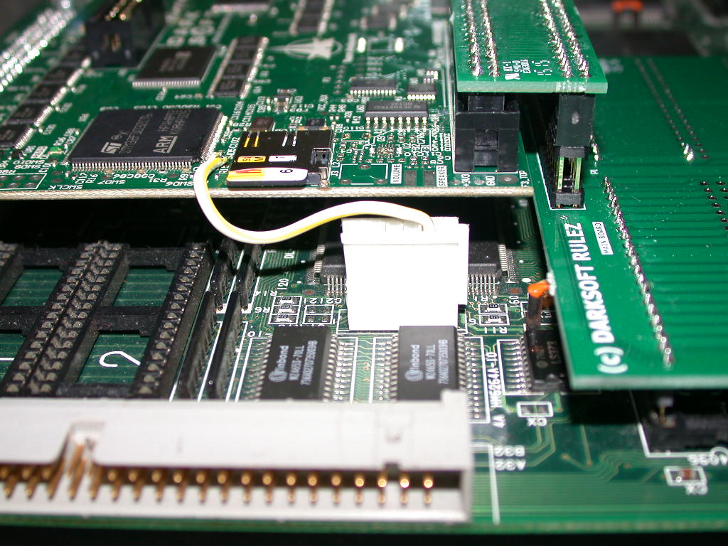

Added this picture to the first post. Anyone without the CN9 connector can add their auto-reset wire to B21 of this connector like so:
This is my version using CN9 with re-using a connector commonly found on a Sega wiring harness
