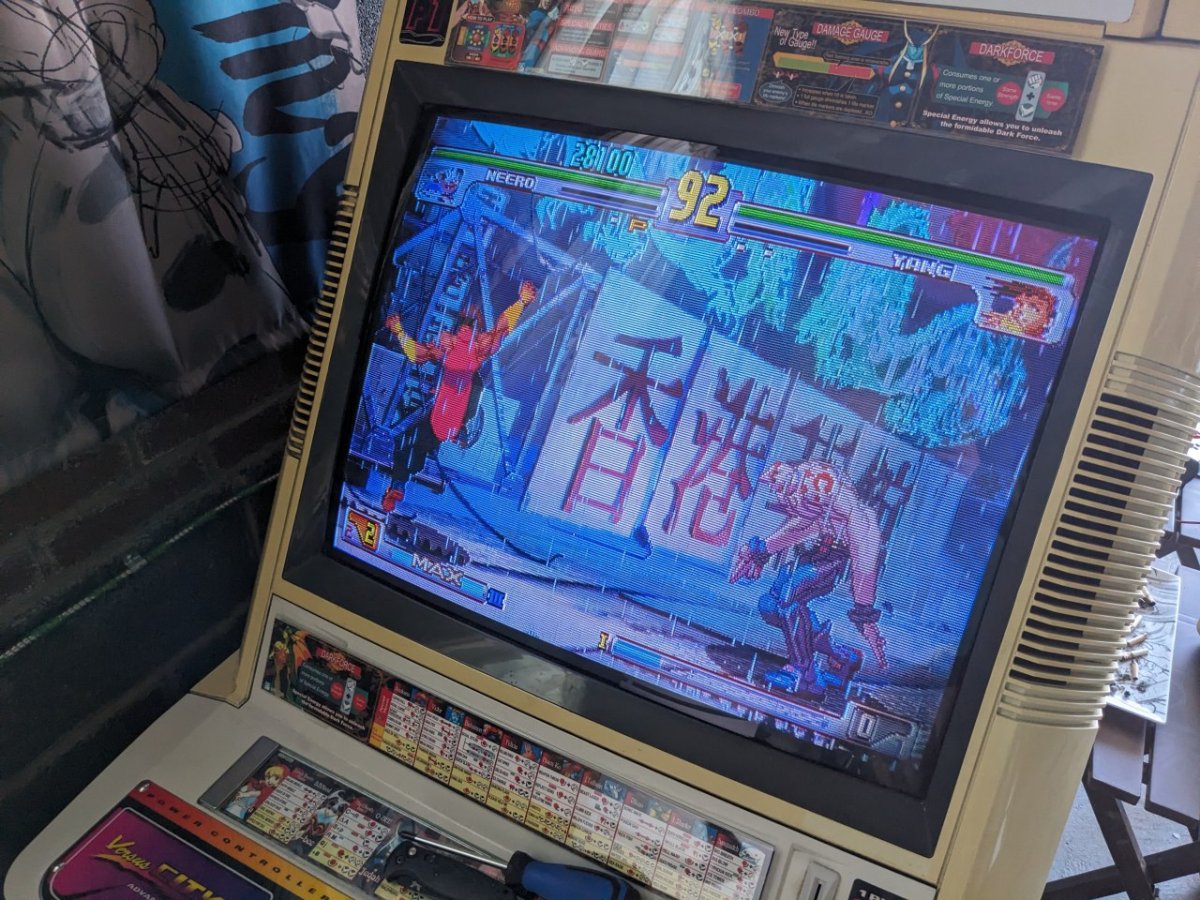

Still need to thoroughly test the board before shipping it back, but it seems that the culprit was two legs bent together and touching on a corner of the PPU.
Note that it’s normal for SIMM 1 & 2 to report NG when using the Darksoft BIOS and CD image. The game code is stored on those SIMMs and the code is modified to run without the factory encryption, changing the checksums that the diagnostics expect.
